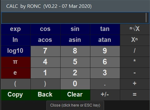

Another question:  the CALC has grown to over a 100 buttons which means I need to make it fit within the screen dimensions or that some options have to be turned off.  How do I get the screen width and height so I can check on whether the palette will fit?
You might like to see the CALC part and it's colored buttons.  Here is a screen capture with one user's color scheme:
Thanks to you and K,  this tool is very helpful.  I plan to put the CALC part on GIThub it a while.
