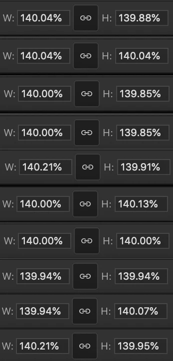

Hi everyone,
Here is my issue...
I select multiple smart objects in Photoshop 21.2.3 CC on MAc. I then transform them by entering the value 140%. The proportions are fixed with the chain icon being active. Once transformed, when I check the value of the resulting scalings, all smart object are scaled differently and non-proportionnaly. I need very precise transformations so all smart objects are at 140.00% W & H.
What is causing this ?
Thank you!

These images are 3D renders representing steps of evolving constructions. We use the smart object process because we align all those images to create a sort of animated sequence. It helps us correct the images when needed after validation of the sequence while preserving alignement (as the image inside the smart object remained at the original size and can thus be easily replaced by the new render), and keeps a record of the various scaling that were needed for successive images inside the sequence in the cases we need to replace a part of the sequence with a new stack (that will need to be precisely rescaled to scale we used). So to answer your question, these images are loaded as stack and all layers transformed individually to smart object using a script after the stack is created. No distortion is present until we rescale a selection of layers.
