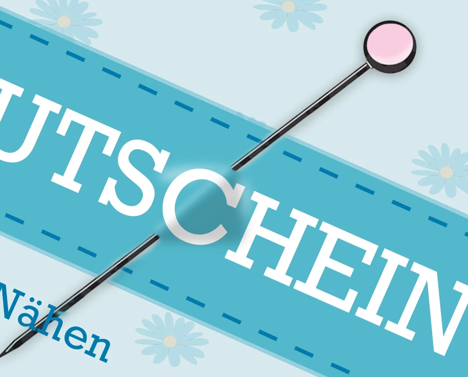

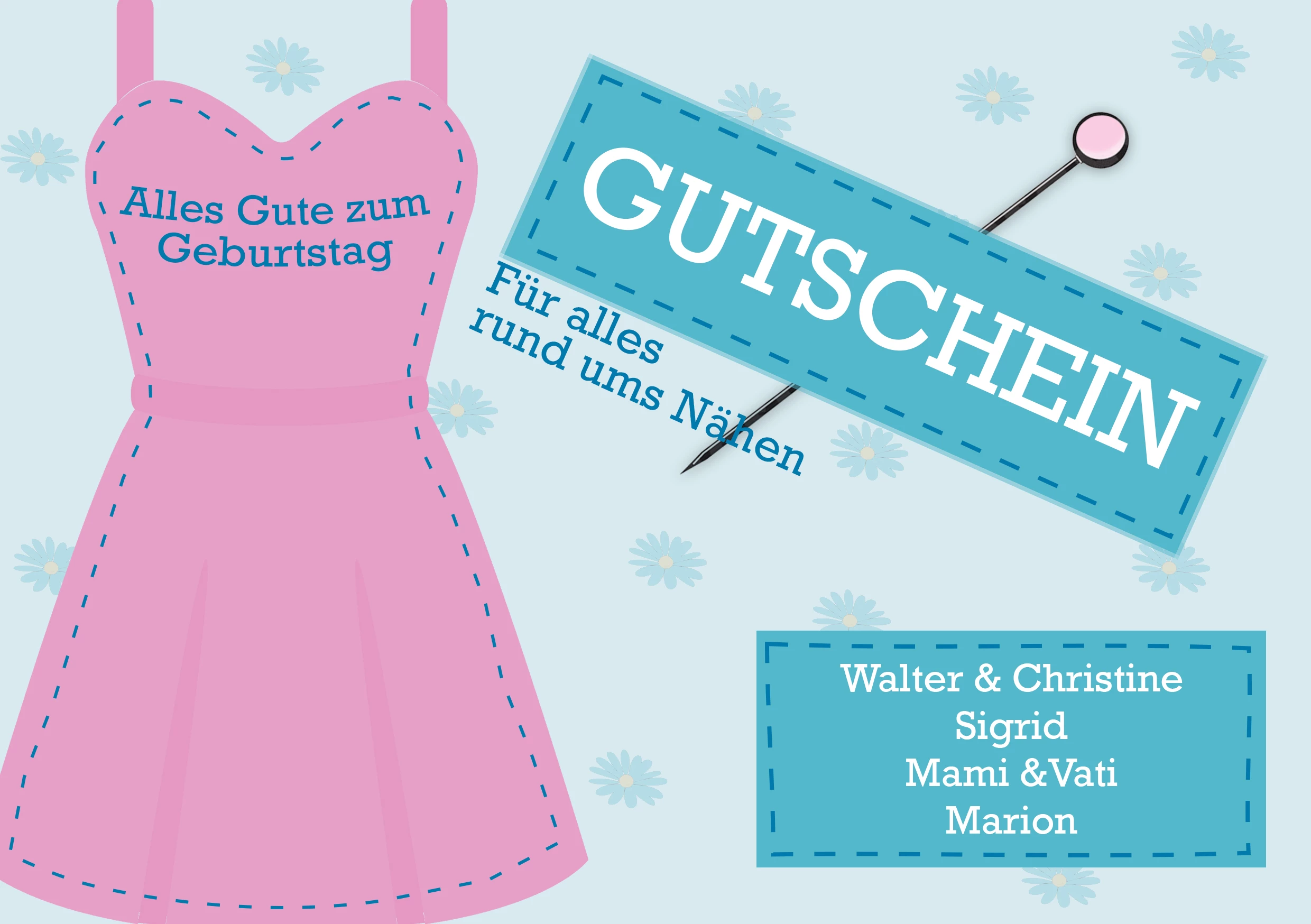

for a coupon I want to pin a text field that looks like a fabric patch on the background. For this I have integrated a long pin to hold the patch in place. Now it all looks a bit flat, because the entrance and exit of the pin is very unrealistic. Therefore I ask the question, how you would design this. The style goes in the direction of clipart, so should not be photorealistic. I already tried to work with certain filters to get wrinkles but that didn't really work.
Thanks for the help!

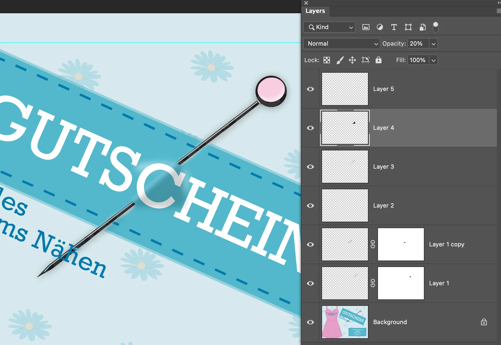

Can you post a screen shot? Off hand, without seeing it, I would say you need to use a displacement map.
pfeiferh52856551
August 5, 2021
Here it is 🙂 I know its not really good, im still learning. Thanks for helping

You need to start with what actually happens. It can be a lot of work to fake it in Photoshop, but your design is unrealistic because it isn't where a pin would actually be.
1. The pin is entirely under the patch. It doesn't hold it on at all
2. The pin is entire on top of the background. It isn't held to the background.
3. The text Naehen is actually on top of the pin. This doesn't really make sense, best to just avoid the overlap.
Play with a pin and a patch and photograph or sketch the reality.
Also: you have three elements each either sewn or hemmed, and one pin. You either need to pin all of them, or not have a hem on the one you are pinning.
