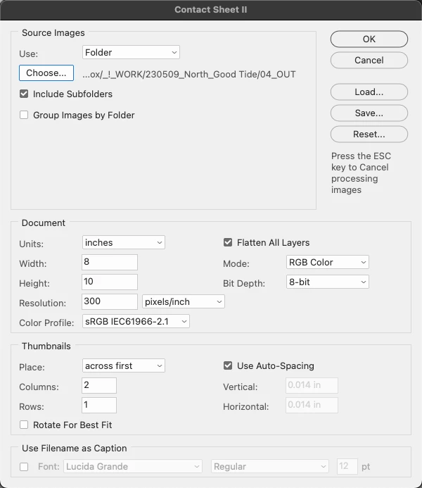

Hi @Brian22351872dw34
The in-Photoshop solution that seems doable is to use File>Automate>Contact Sheet II. This allows you to create individual PS docs populated with images from a folder you choose. To place them side by side, set the the thumbnails to 2x1 and adjust any of the other settings to your taste.
At this stage you've got files with your images placed two at a time. From here you'll have to see if you can use or tweak your existing actions to place those resulting files into the background image.
It's a little clunky, but seems like a good option.
Beyond this, I think you'd need to script something, and I'd leave that answer up to someone smarter than me like @Stephen Marsh 🙂
Let us know how it goes!
Sef

June 28, 2023
Also, I should clarify, both images will need to be positioned on the background at a specific location on the background, specifically side by side. Thanks
Stephen Marsh
June 28, 2023
@Brian22351872dw34 - I can help you automate this. If it is just a case of having two images side by side in a batch and then your action will do everything else, then that is easiest... But even then, are both images per file the same size or is one different to the other?
Otherwise, the devil is in the details.
It would be helpful if you could provide the working files:
* Common background image
* Sample of one set of 2 images
* Sample of a set of another 2 images that may have different sizes or ratio
* Sample of the finished 2up result
What file format and options should this save to?
