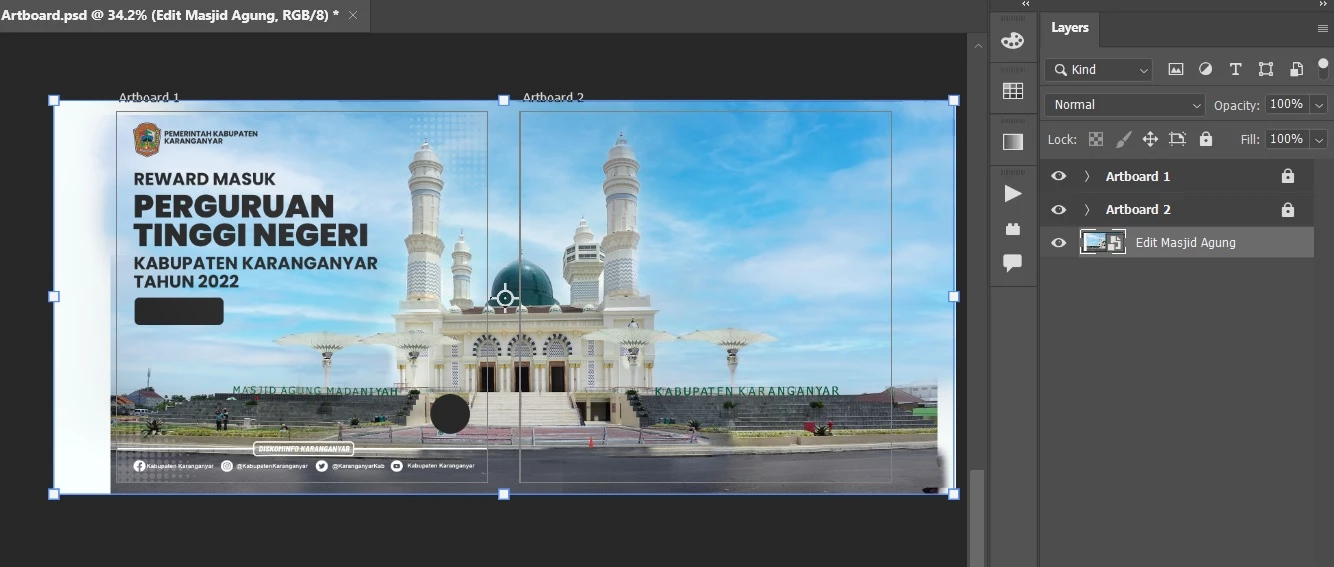

Dear community, i have some quenstion about working with artboart.
1. Is it possible to create an outside layer of artboard like below?
This bottom layer can stay there becouse i lock the arboart, when i unlock the artboart, the layer will be automatically join with arboart.

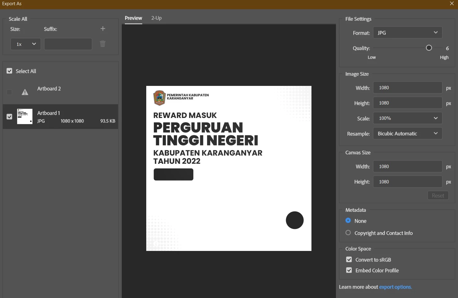

2. If it possible create layer outside of artboart, how to export the artboart with that bottom layer included?
Look, i try export artboart but the mosque picture not rendered

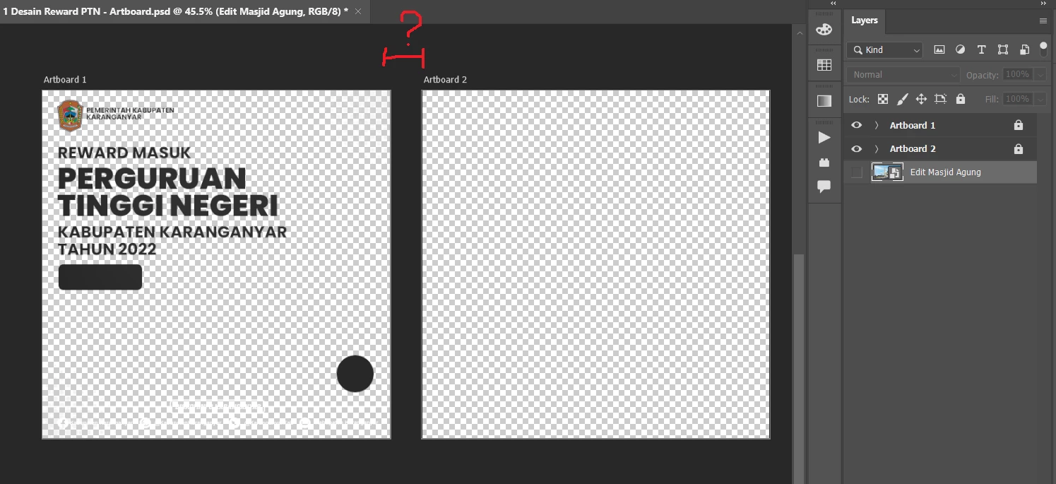

3. Is it possible to change the distance between artboart?

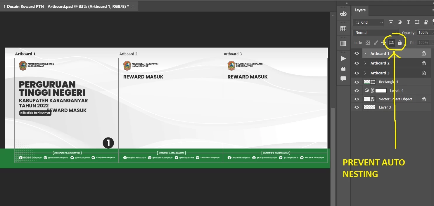

Thanks so much @c.pfaffenbichler , after couble of hours trying :
Activating 'prevent auto nesting' button seem to work for my problem.

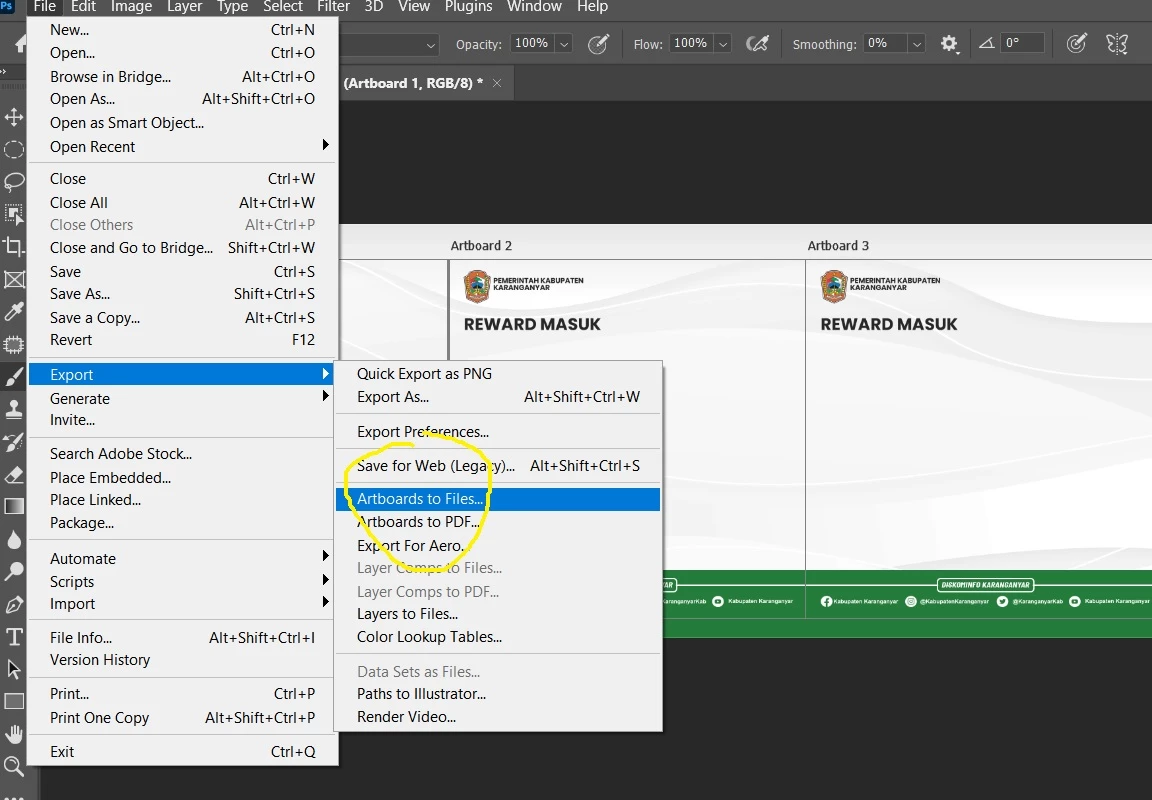

and, export artboard to files solve this

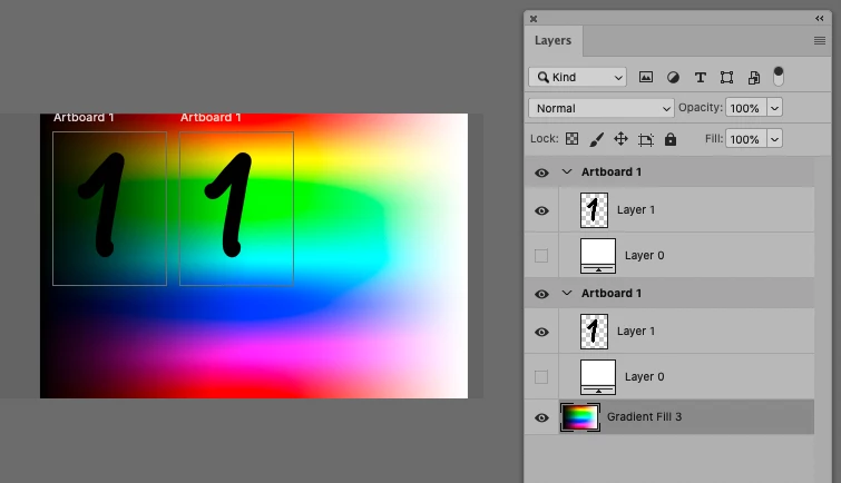

Ad 1) I guess my test was superficial; if I move the Layer below the ArtBoards it is moved inside one of them.
Edit: The work-around would be to create a third (or x-th) ArtBoard to contain the »background« layer.

3) Seems to work fine both manually and using the Arrow Keys (with the Move Tool selected).
