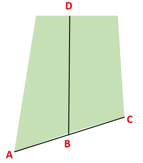

    How to measure the distance from "A" to "C" and "B" to "D" simultaneously?? And the line "A" to "C" is tilted (not in 'X' axis). Image attached.

    "B" is a point in the line "A" to "C". If I draw it separately, I won't get the point "B" in the line "A" to "C". (Instead I may be taking some other point). So I need the line "A" to "C", so that I can draw the line "D" to "B". Hope its clear now.

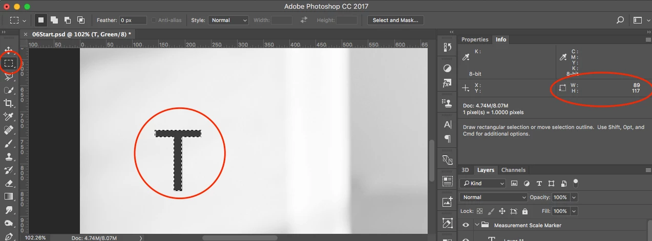

    Alternate of Ruler Tool can be the Rectangular Marquee Selection tool. Make the Selection of T using the Marquee selection tool and open the info panel from Main menu >  Window > info Panel.  Info Panel will show the W & H of Selection which is the same as Ruler tool Measurement.
    Screenshot for Reference -

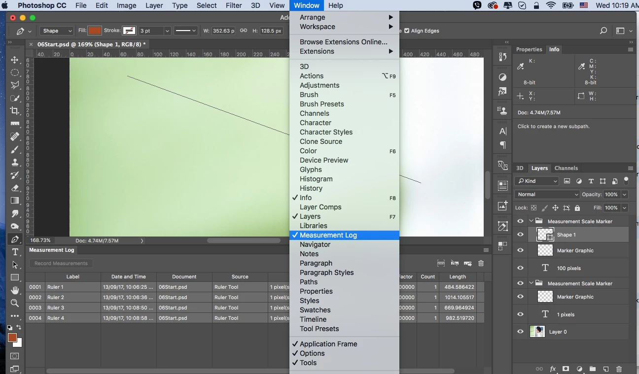

    You can log the Measures of Ruler Tool in the Measurement Log Panel. Accessible from Main Menu > Window > Measurement Log. You can use this panel to record your Measurements and even export in text file. This will let you compare the measurements of two lines.
    However, as per my understanding you can not create two Ruler measurements at the same time. Another work round could be use ALT key after drawing the ruler to create angle ruler for the another line. Once you record this in Measurement Log Panel It will show you three measurements - One for complete ruler and two different measurements for each angle.

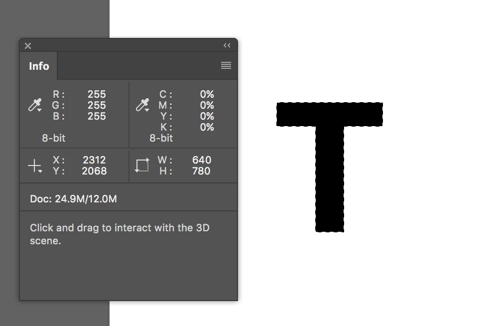

    Or . . . Select the letter T with the Magic Wand tool and then read the width and height from the Info panel;
