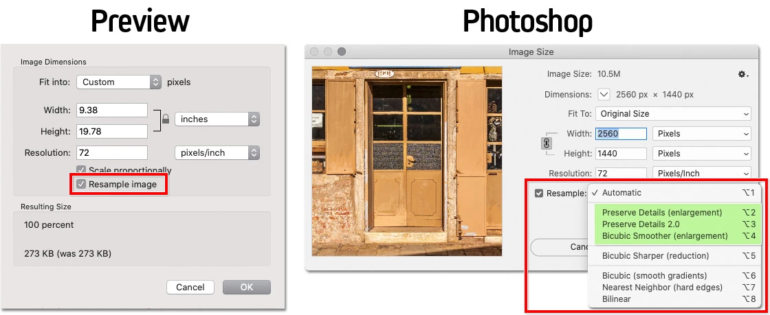

Preview offers basic resizing. It might do an acceptable job. If you need to resample for enlargement, Photoshop provides multiple options that Preview doesn’t have, highlighted in green below. Some photographers who are concerned about enlargement quality like to test each option, to determine which one looks the best for the kind of images they have.
Some photographers prefer to use separate software such as Topaz Gigapixel AI, that claims to make superior enlargements by preserving or artificially enhancing detail. If you were interested you would want to use the free trial to test whether it’s enough better than Photoshop to pay for.

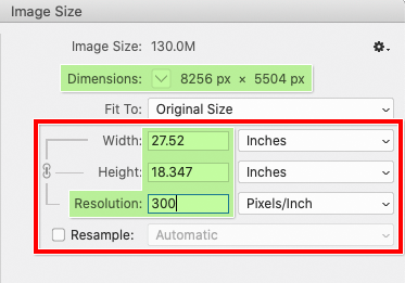

As KR Seals pointed out earlier, the Image > Image Size command in Photoshop can calculate what is possible from your original image. An uncropped Nikon D850 frame has 8,256 x 5,504 pixels, or over 45 megapixels. If you want to see what sizes are possible “without loss” as you asked, first you disable the Resample option, and then you change either the dimensions or the pixels per inch.
In the example below, Image Size shows that the reason you are getting roughly 18" by 27" from your frame is that the pixel dimensions of your D850 frames work out to those inch dimensions at 300 ppi. As D Fosse mentioned, a large print is viewed from farther away, so if we assume the viewer is viewing it from at least twice as far away as a small print, let’s drop the ppi value by half: 150 ppi. Because at twice the viewing distance, 150 ppi will appear to be 300 ppi. The result of entering 150 ppi into Image Size indicates that a print could be 55 inches long without resampling the pixels (i.e.  no loss). This suggests that you can achieve your goal of a 50 to 60 inch print that has acceptable resolution at a typical viewing distance.
