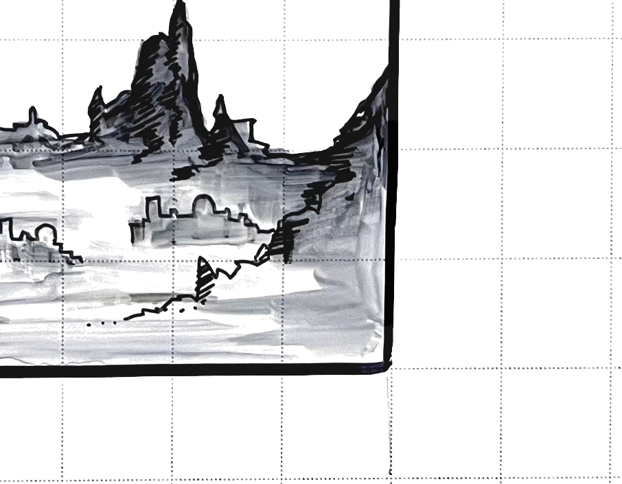

I regularly clean up a bunch of images drawn on gridded paper.  (not my drawings and can't change the paper)
I would like to remove the gridded background.
1. I wondered if there is an option to select a section of the grid and ask PS to delete the background that matches the selection.  I think this would remove parts of the image though, that are drawn over the grid.  Maybe there's a sensitivity adjustment?
2. I am okay with deleting the background/moving the linework onto a new transparent layer etc. and in the past I have generally done this then used levels to fade the grid and manually cleaned up what is remaining, but this process fades out the line work too much so I need to go back over it and it is verrrrrrrry time consuming.
3. I'd be grateful for any suggestions or ideas for alternative methods, I use photoshop in a very limited way and am aware I know about 2% of it!
4. Section of picture for reference, I am usually working on a PSD and can't show whole image for confidentiality reasons.
Thank you.

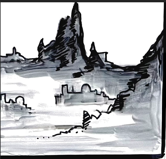

@rebeccal38686413 use the new Remove tool. Bing bang boom done. Took all of about 20 seconds.
Kevin Stohlmeyer
February 5, 2024
@rebeccal38686413 keep in mind this was a complete rush job - if I had reduced the brush size and kept it isolated to the dotted lines, the results would improve.

Per Berntsen
February 5, 2024
The Spot healing brush set to Content-aware works quite well for this particular image.
This took me about three minutes.
February 5, 2024
Thanks Per, did you go over each grid line with the spot healing brush?  The drawings are typically really large and very detailed and there are a lot of them, so I was hoping I could find a series of actions that would remove the grid fairly quickly and accurately without compromising the linework.
Per Berntsen
February 5, 2024
Most of the lines were removed by clicking and dragging in one operation, but some of the dots had to be removed individually. I have no experience with this kind of work, but I have spent may hours removing dust and scratches from scanned B&W negatives, which this is similar to.
You will probably find that the spot healing brush doesn't always produce a good result. You can then try to drag the opposite way, and/or working on shorter segments of the grid lines.
In difficult areas you may have to use the clone tool, and you can also try the Remove tool. (grouped with the spot healing tool)
I doubt that there is a faster way to do this, but maybe someone else can suggest something.
