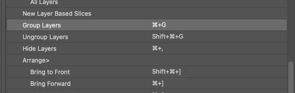

percupmate
August 3, 2023
Found the solution. I had set my keyboard shortcut to be CMD-G and I was also getting this pop up prompting me to name the layer. So annoying!
Basically the confusion comes from their being two 'Group Layer's. The one I had set the command for was the first one to come up which is under Layer/New>/Group... - it's NOT this one. Instead, keep scrolling down, the one you want is almost at the bottom of the Layer section just above the 'Arrange'. Hope thats clear and helps!
