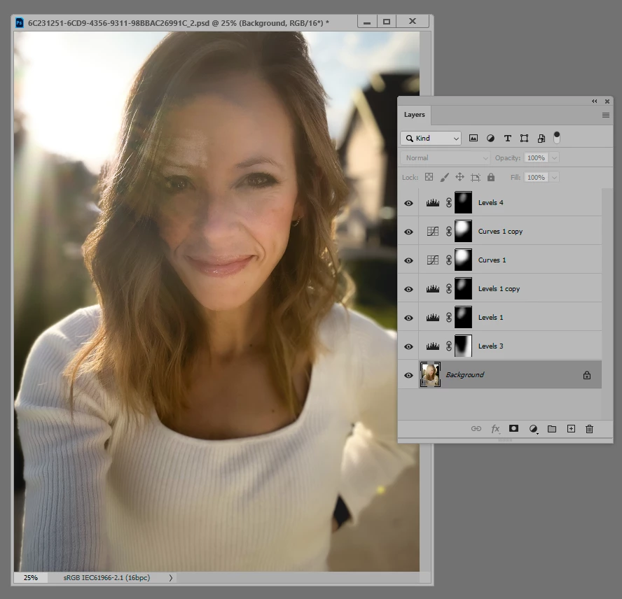

There is just enough information left here that it's possible to expand the tonal range back to almost normal. The trick is to make the necessary adjustment and then carefully brush it in with a soft low opacity brush. Splitting it up makes it easier to control.
But as you can see, that exposes further problems. An ugly orange blotch appears, and some ray-shaped flares that need to be individually removed. Yes, it's possible, but make no mistake, this means a bit of work. There's no magic button!
