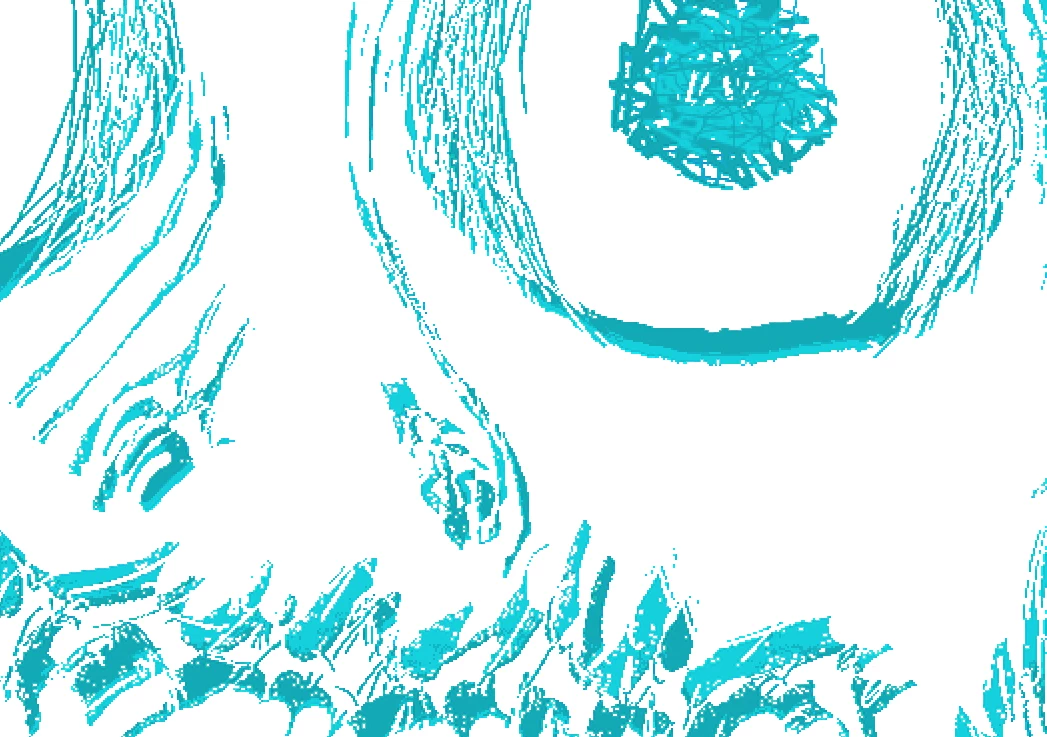

I would say the easiest way to do this is with, believe it or not, the magic wand tool. If you set the tolerance to a very low value between 0 and 5, contiguous off, then click on the pink it will select a very narrow range of pink shades. Now create a blank layer and switch to that layer so the selection applies there. With the foreground color set to white press alt or option backspace/delete to fill the selection with white. Now go back and repeat with the pink shades not selected and again fill the empty layer with white. You will have to do this four or five times to remove all the non cyan colors. It took me about 5 minutes to get the below

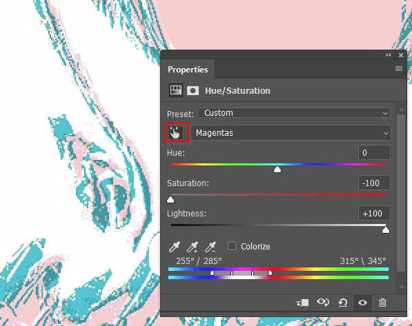

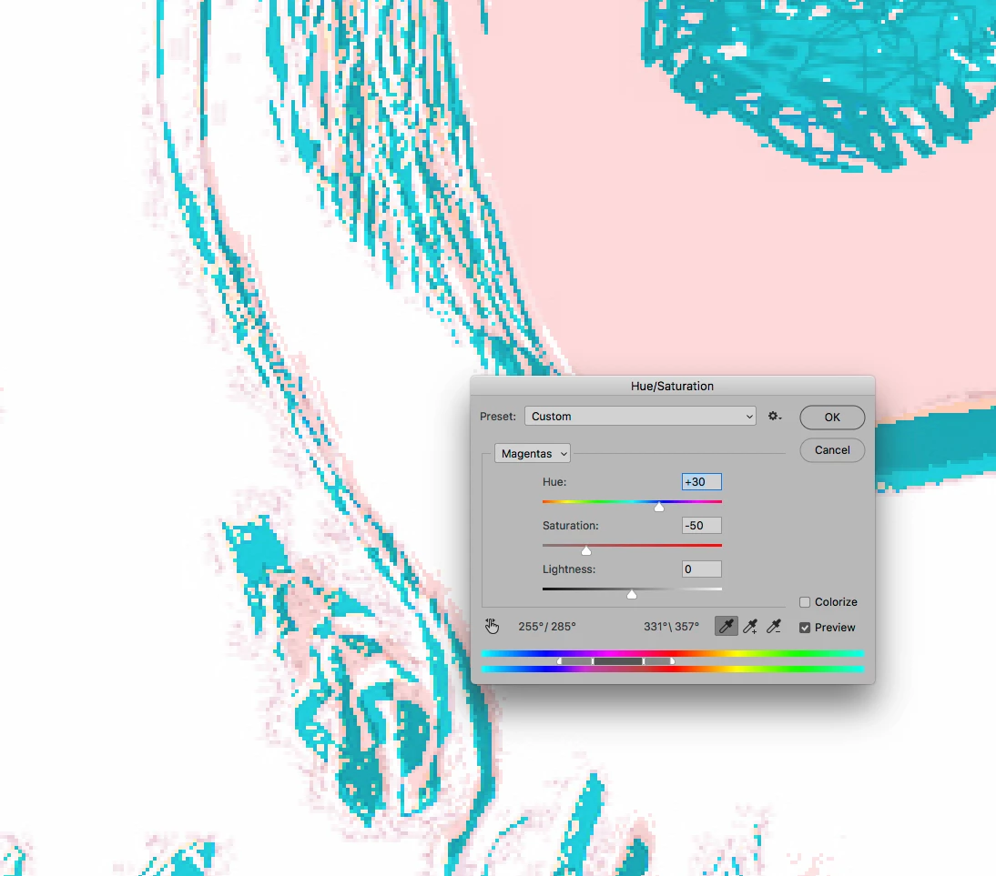

Another possibility might be using a Hue/Saturation Adjustment Layer with »Magentas« as the target and, if necessary, manually adjusting the range.
Edit:

Or use the little hand to pick the colour rage from the screen. As CP has said, after you adjust the pink tint away, you can fine tune by dragging the sliders on the colour pars at the bottom of the Properties panel.  Targeting colour, is a hugely powerful and useful tool with Photoshop.
