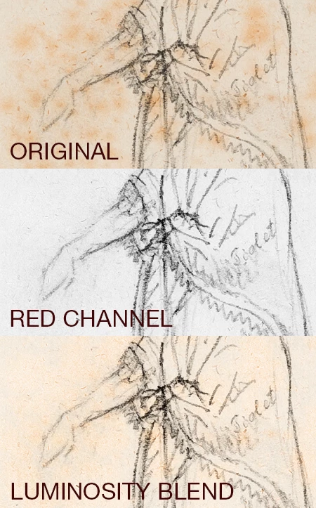

    D Fosse
    August 23, 2017
    Smudging is usually tan/brown, and more or less disappears in the red color channel.
    So you can use that, and set it to Luminosity blend mode over the original.
