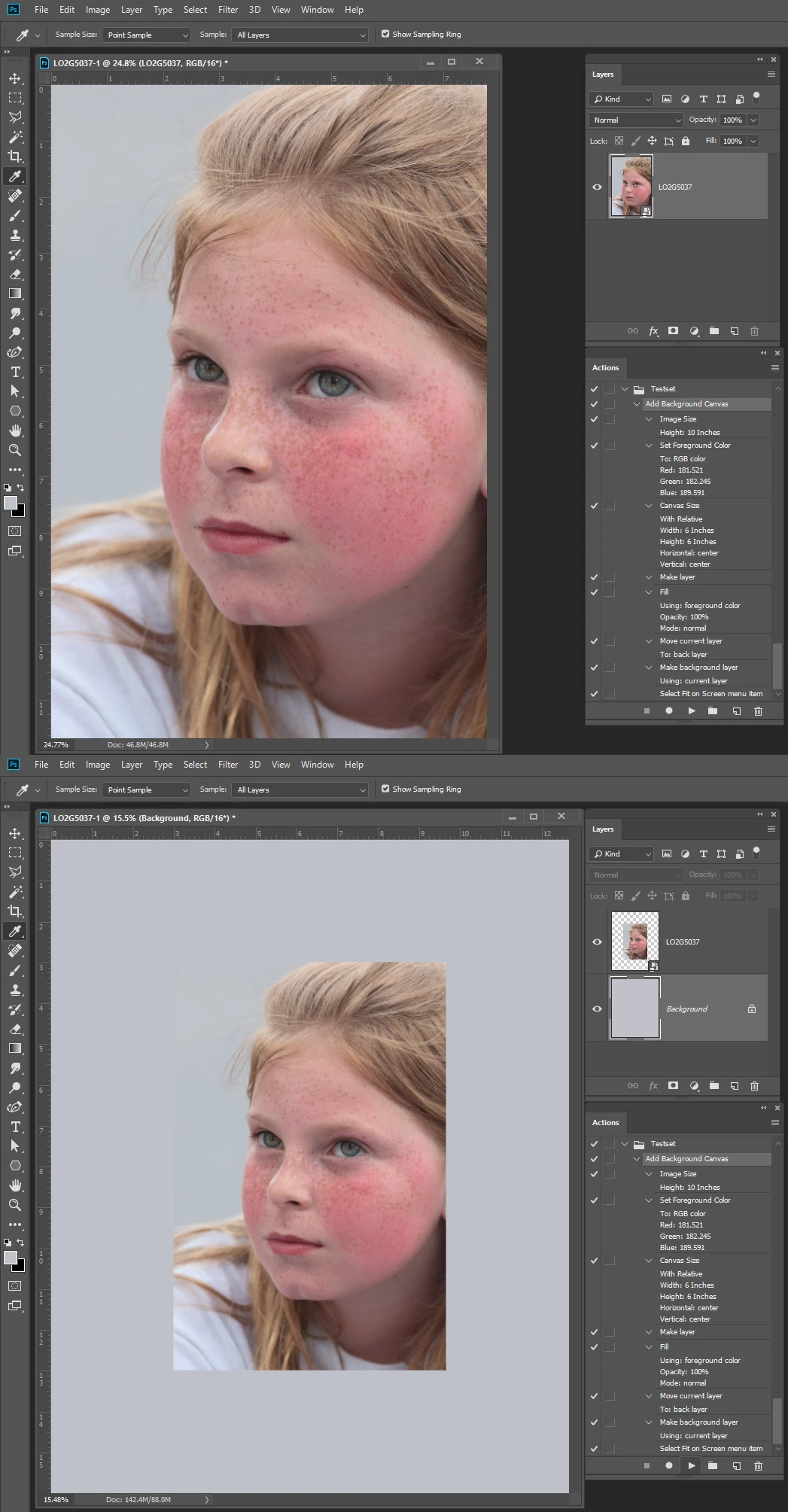

It sounds like your PSD do not have a background layer. If you did when you expand the canvas size the background layer expanded canvas would be filled with the background color for it does not support transparency. If you expand a document canvas that does not have a background layer no pixels will be added the expanded canvas area will be transparent. No Layers pixels are changed layer sizes do not change. Your Action would need to use the eye dropper tool to set the  background or foreground color swatch.  Expand the canvas to the size you want. Add a new empty layer on top and fill that layer with the background color. Move the layer to the bottom of the stack and covert it to a background layer if you want.
