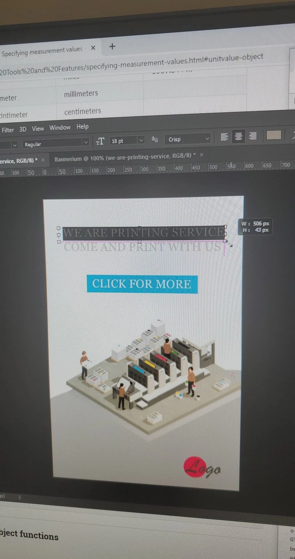

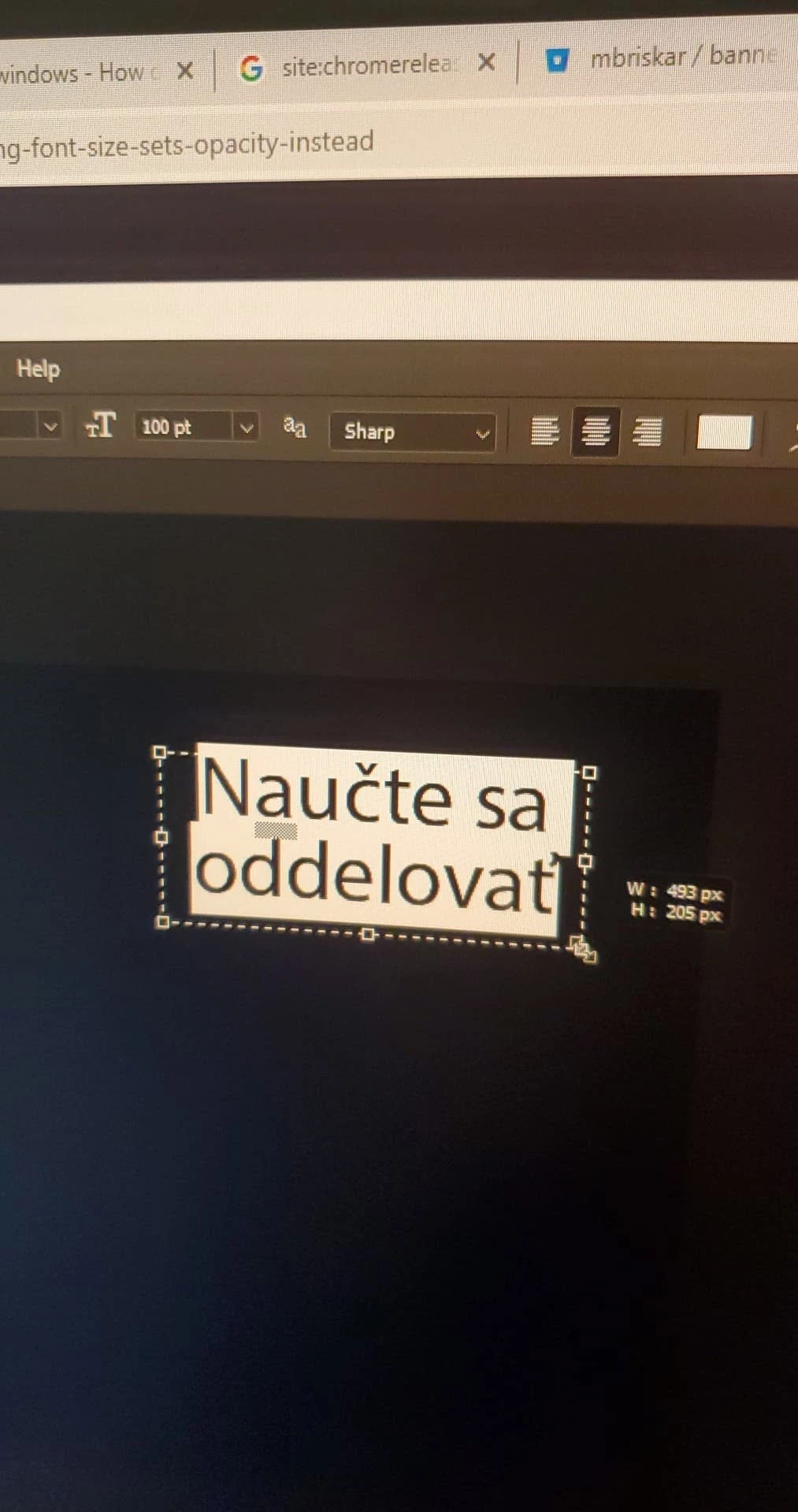

A: the textbox is roughly 490x205 px with the font size 100pt
B:  506x43 px text with font size 18pt.

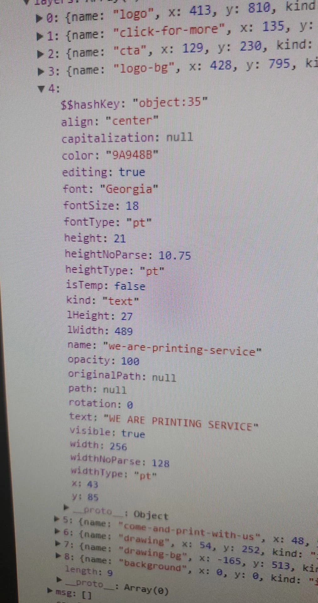

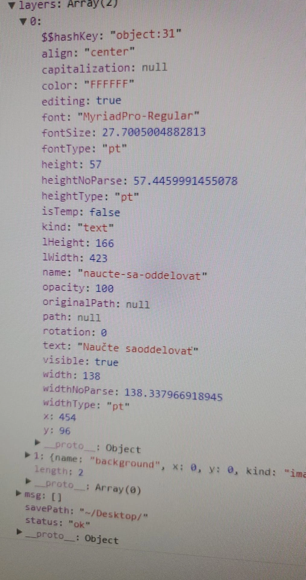

However, when we try to get information about the layer in photoshop API, the data is different:
width = parseInt(layer.textItem.width.as('px')) ....  A 138 |. B 256
widthNoParse = layer.textItem.width .... A 138.33 |. B 128
widthType = layer.textItem.width.type .... A pt |. B pt
height = parseInt(layer.textItem.height.as('px')) .... A 57 |. B 21
heightNoParse = layer.textItem.height .... A 57.44 |. B 10.75
heightType = layer.textItem.height.type .... A pt |. B pt
fontSize = layer.textItem.size.value ...  A 27.7 |. B 18
fontType = layer.textItem.size.type ... A pt |. B pt
layerWidth = layer.bounds[2] - layer.bounds[0] ... A 423 |. B 489
layerHeight = layer.bounds[3] - layer.bound[1] ... A 166 |. B 27
We are confused with the data we are getting.
Why is as('px') transforming the data only sometimes? Even if, it doesn't seem to calculate the data properly to px though.
Why is font sometimes OK sometimes off?
Is this data reliable?
Foto documentation:
A:
B:

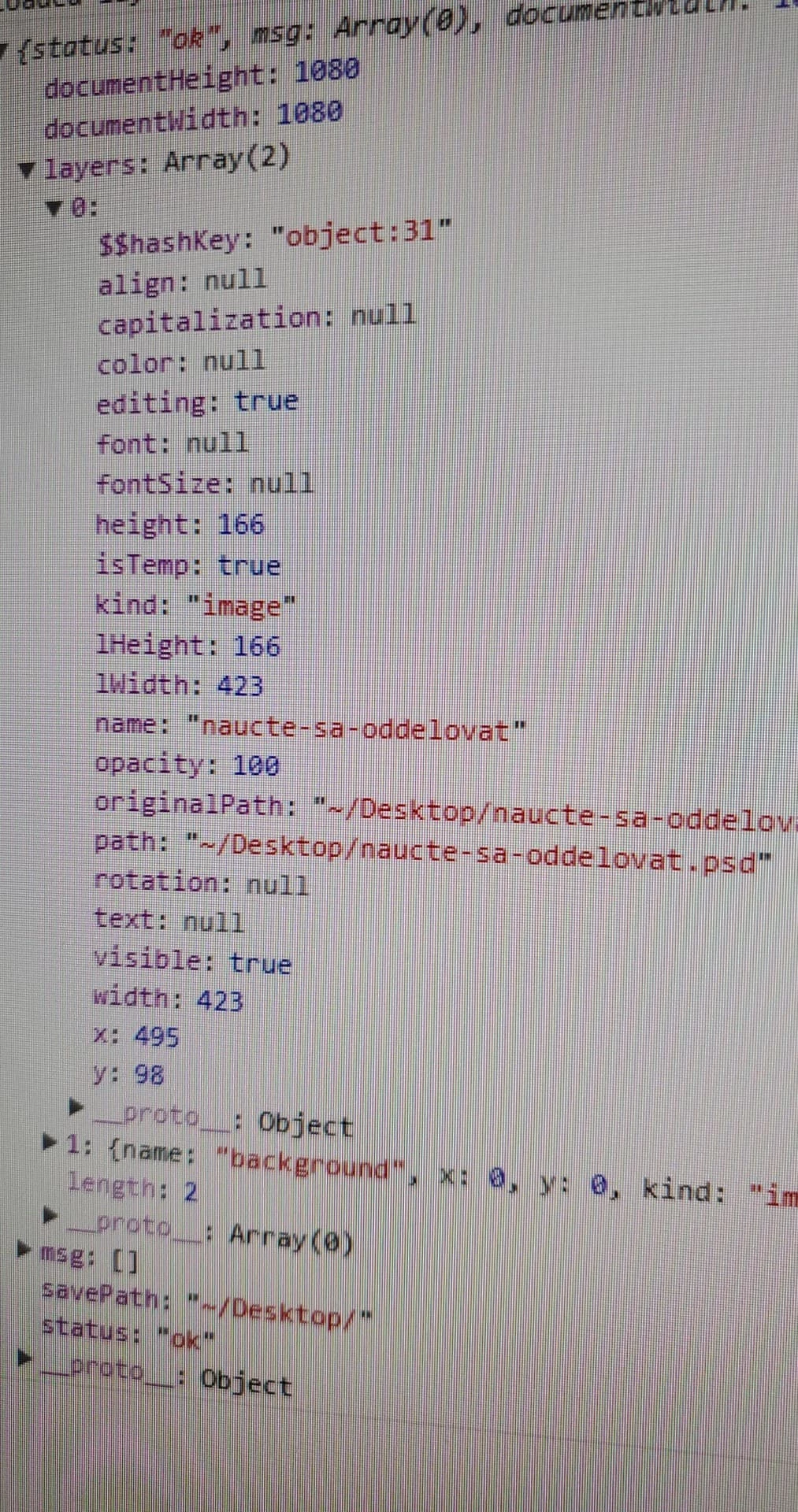

April 4, 2020
What size is reported if you rasterize the text?
Semy_3Author
April 4, 2020
Hey Stephen,
thank you so much for your response. Here is the answer. I rasterized text and I got this (example A):
