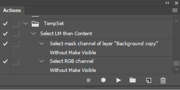

The scriptlistener code I poster does that.  If the Layer Mask is targeted and you click on the layers content icon in the layer palette to target the layers content that is what the Adobe scriptlistener plug-in recorded.  The plug-in is like Photoshop Action recorded. However it records Script code to use Photoshop Action manager. Its like an Action step. All the setting are hard coded for the step and executed. The code is not very readable.
You can create script functions from script listener cord by replacing the variable hard coded constant  setting with  variable.    If you look at the code posted you can set some if the hard coded sets "slct" , "Chnl", "RGB "  select channel RGB

Hi all,
I think it is important to know (for a general project) if the mode is RGB or CMYK.
After this, you can select the Alpha channel with the listener code given by JJMack.
Now you will have only color values (if there are color informations of course).
var docRef = activeDocument;
var idMode = charIDToTypeID( "RGB " );
if (docRef.mode==DocumentMode.CMYK) {idMode = charIDToTypeID( "CMYK" )}
selectAlphaChannel()
function selectAlphaChannel()
var idslct = charIDToTypeID( "slct" );
    var desc57 = new ActionDescriptor();
    var idnull = charIDToTypeID( "null" );
        var ref43 = new ActionReference();
        var idChnl = charIDToTypeID( "Chnl" );
        ref43.putEnumerated( idChnl, idChnl, idMode );
    desc57.putReference( idnull, ref43 );
    var idMkVs = charIDToTypeID( "MkVs" );
    desc57.putBoolean( idMkVs, false );
executeAction( idslct, desc57, DialogModes.NO );

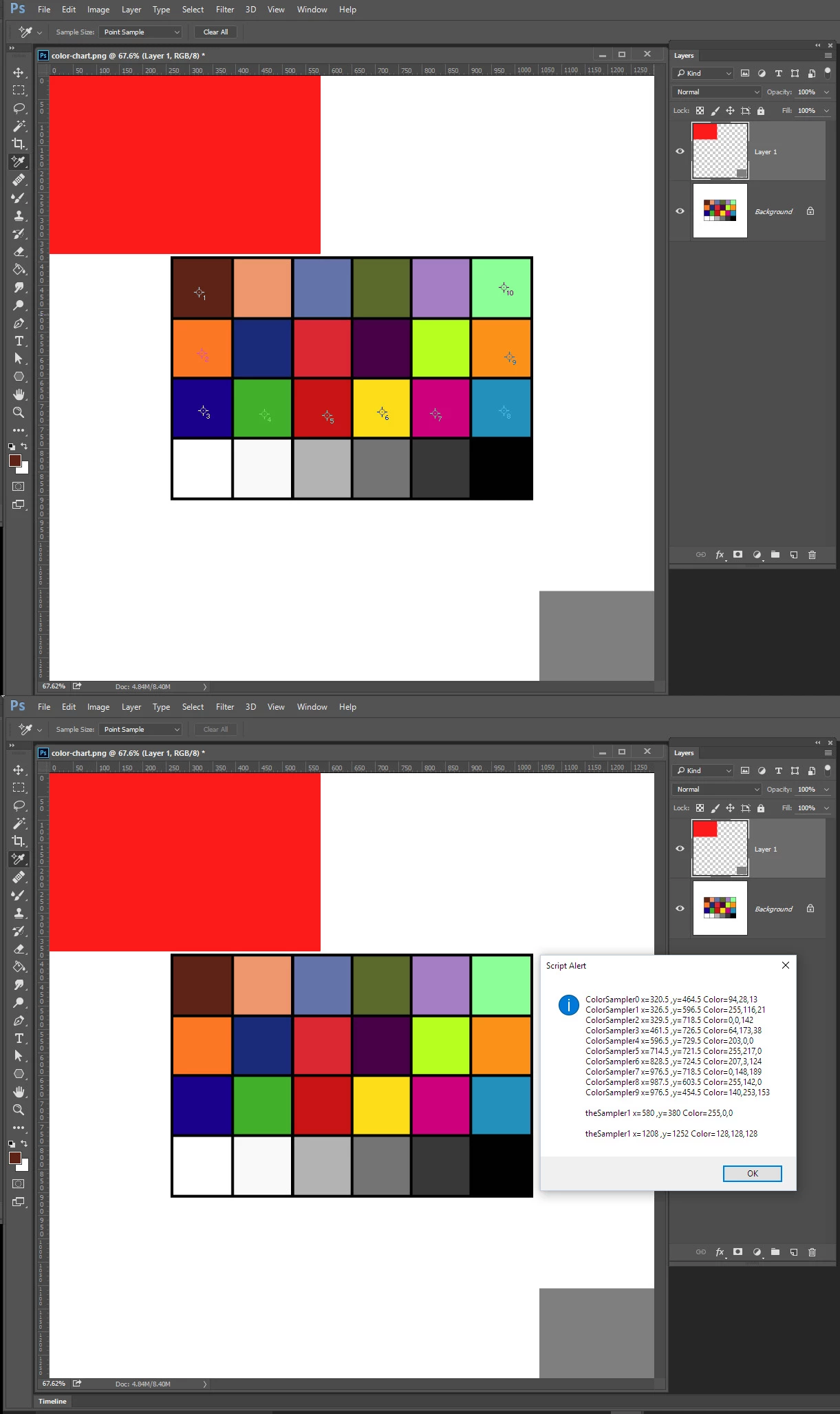

April 30, 2016
Here the code I use It looks like your and worked for me.
preferences.typeUnits = TypeUnits.PIXELS;
preferences.rulerUnits = Units.PIXELS;
var doc = app.activeDocument;
var layersArr = new Array();
var colors = '';
for (var s=0,len=app.activeDocument.colorSamplers.length;s<len;s++) {
  var colorSamplerRef = app.activeDocument.colorSamplers;
  colors = colors + ("ColorSampler" + s + " x=" + colorSamplerRef.position[0].value + " ,y=" + colorSamplerRef.position[1].value + " Color="
  + Math.round(colorSamplerRef.color.rgb.red) + ","
  + Math.round(colorSamplerRef.color.rgb.green) + ","
  + Math.round(colorSamplerRef.color.rgb.blue) + "\n" );
for(var i = 0; i < doc.layers.length; i++){
        var layer = doc.layers;
  //alert(layer.name);
        doc.colorSamplers.removeAll();
        if(layer.isBackgroundLayer){
                    //Pixel sample1
                    theSampler1 = doc.colorSamplers.add([1208, 1252]);
                    layersArr [0] = Math.round(theSampler1.color.rgb.red);
                    layersArr [1] = Math.round(theSampler1.color.rgb.green);
                    layersArr [2] = Math.round(theSampler1.color.rgb.blue);
  colors = colors + ("\ntheSampler1 x=" + theSampler1.position[0].value + " ,y=" + theSampler1.position[1].value + " Color="
  + layersArr[0] + ","  + layersArr[1] + "," + layersArr[2] + "\n");
       else{
                    theSampler1 = doc.colorSamplers.add([580, 380]);
alert(colors)
JJMack

April 30, 2016
I'm on Windows 10 CC 2015 with the four update you code works on my system once I added the missing bracket ], defining the layerArr and setting doc your code worked.
Are you sure at your sample points your doc has a color  other than black.  I add a layer where  I had red and 50% gray in those areas and that was what was set into you layerArr array. which you reuse for the second sample
