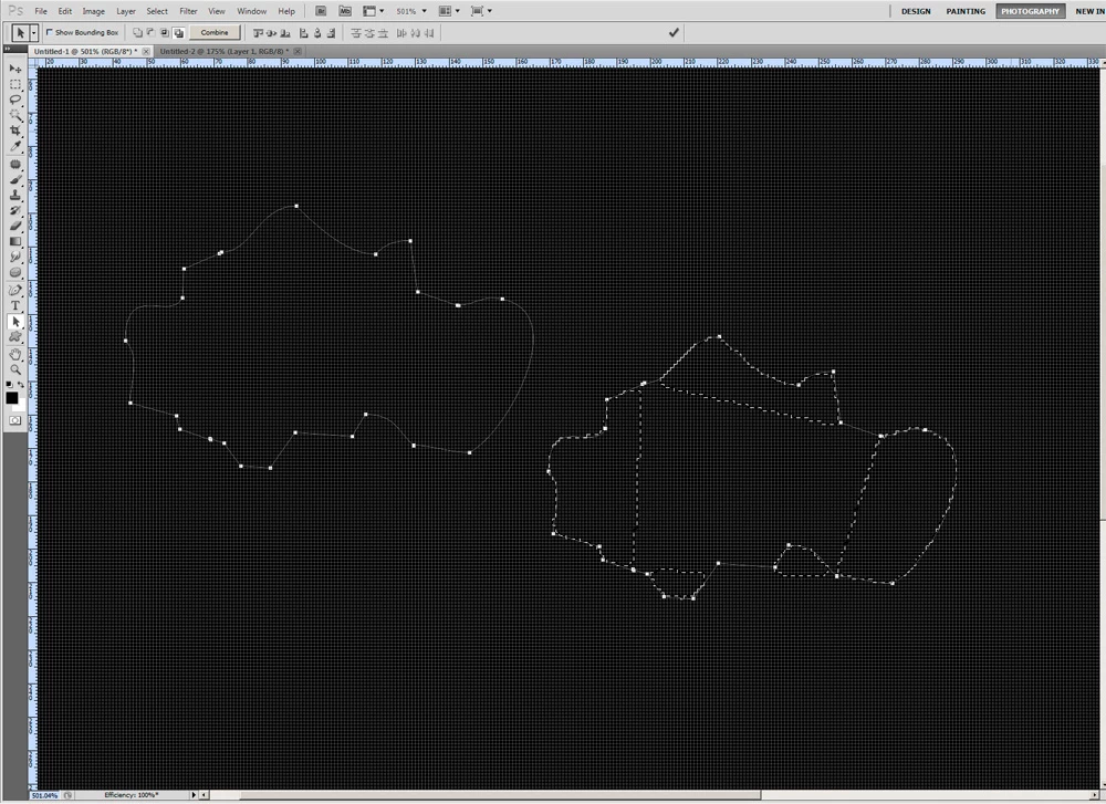

Yesterday I for the first time used the Freeform Pen tool and for various reasons ended up with about
6 separate sections. To join then I pulled the end nodes over each other and used the combine feature, with
the Direct selection tool. This does produce a combined path, or it seems that it does, as the combined path moves as one.
The problem is that if I fill the path or make a selection, I get separate filled paths or selections.
I have attached a picture where I have made using the Freeform tool 5 paths and combined them with the Combine function.
I copied the combined path,pasted back, moved the path and made a selection.
Having placed the end nodes of separate paths together, I would have assumed that that would
automatically joined the ends, but combine should, but it seems not.
MDE

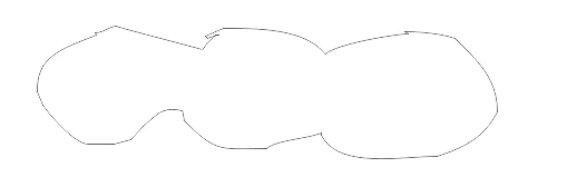

    I cannot test CS5 as I don't have it installed. However in CS6 and CC2017, both of which I do have installed, merging shape components works by closing the ends of each path with a straight line then combining them into a single shape outline.
    So in the attached example it leaves a triangle in the middle where those closed path shapes did not overlap
    combined give :
    It sounds like the CS5 "Combine" button is working the same way  I wonder if it was renamed to make it more clear.

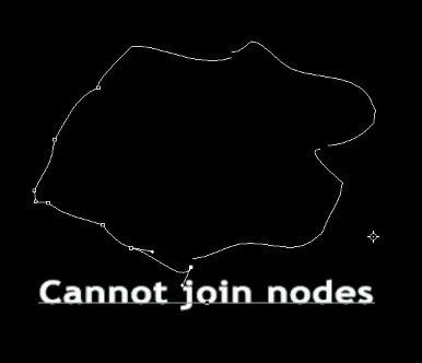

    Hello
    Yes the solution is within the Freeform tool,
    you have to join the segments with that tool.
    There is a ~ symbol when the pen meets the second
    segment. I am sure that I tried that, but I
    expect I had not zoomed in enough to see the ~mark. so did not make a join
    Thanks
    Mike Engles

    I tried to replicate but do not get the same - I have shown each step below - can you see/say where yours differs?

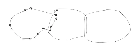

    Make three paths with the freeform pen tool :
    Move the points  with the direct selection tool they overlap :

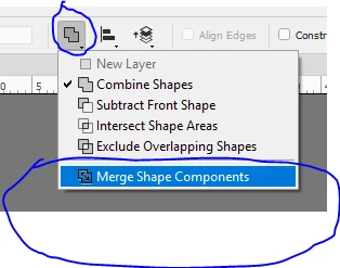

    Go to the options bar and Merge Shape Components
    Move the path with the path selection tool then make a selection from the path :
    Dave

    I was using a combine button next to the Join shapes menu. You seem to be combining closed paths
    If you select several open paths with the direct selector tool a combine button appears, which seem to create a group, but does not make a single closed path. I don't have that merge option in the drop down. I am using CS5.
