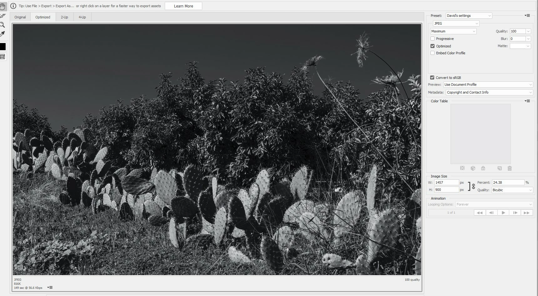

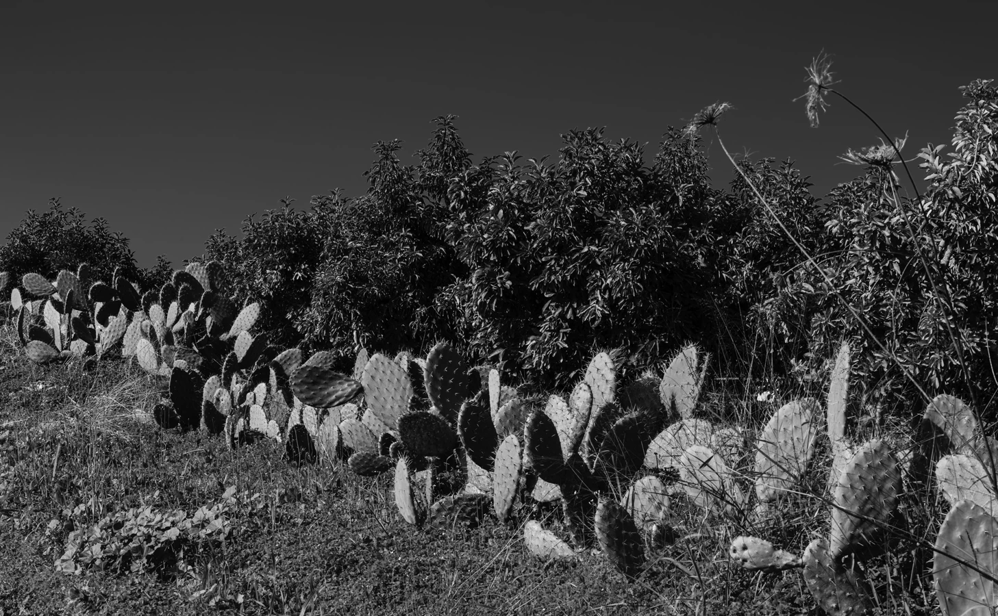

In Ps I 'export/save for web' a photo that I converted to b&w in camera-raw.
The generated jpg is darker than the dng photo. Why?

The b&w photo that was created in camera-raw had color space grey-gamma 1.8.
When I changed it to 2.2 the jpg looked I intended it to be - as the dng.

You have not checked "embed color profile" in Save For Web. You need to make sure that is always checked.

1. Checking "embed color profile" didn't change the result.
2. I converted it by clicking on the b&w button at camera-raw. Where do I see if it is monochrome sRGB or not?
