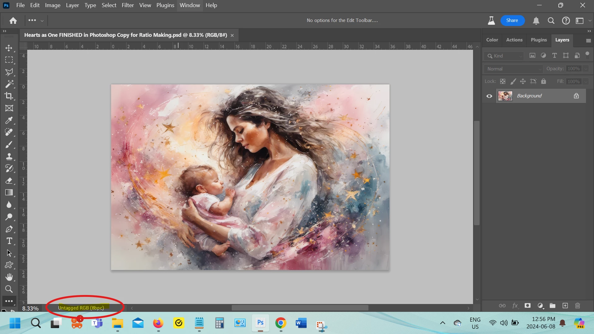

Hi All.

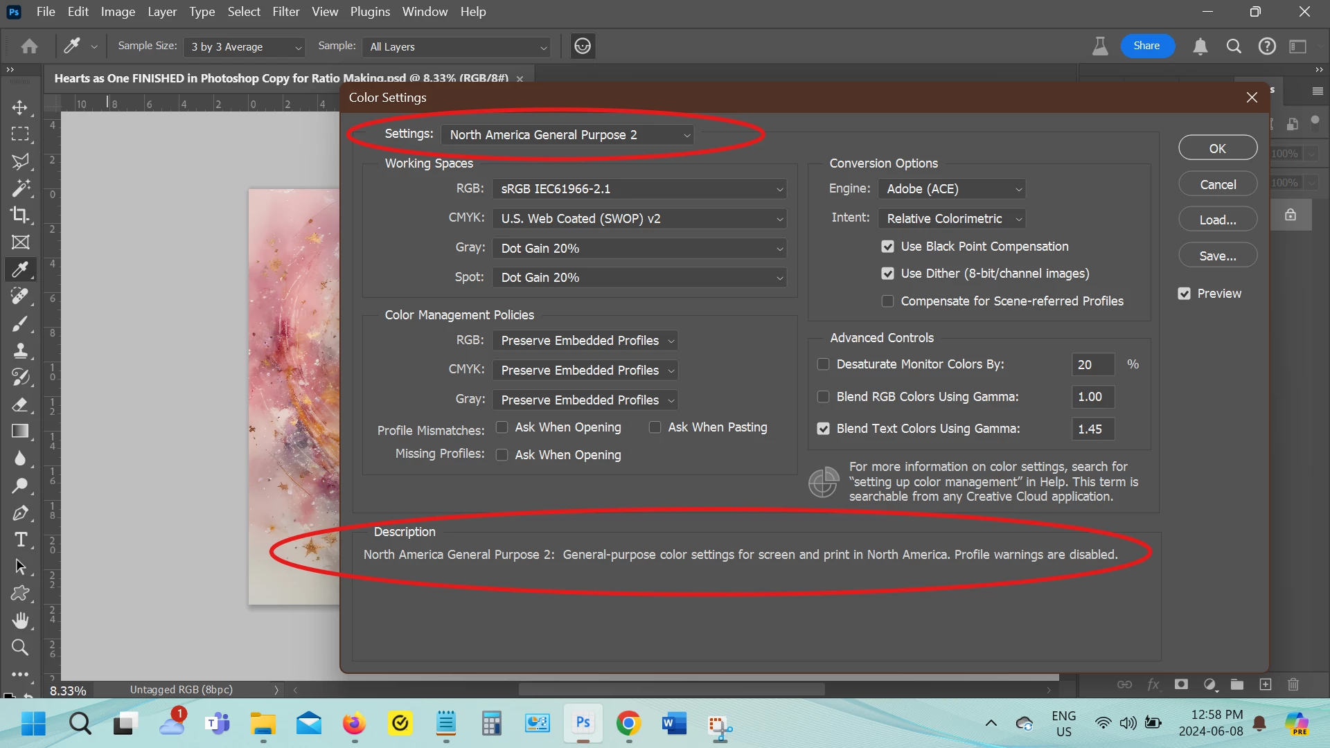

With my image file open, Under Edit > Color Settings, it says "North American General Purpose 2" which is described as, "General Purpose Color Settings for screen and print in North America.
But at the bottom left of my image workspace, when I select Document Profile, it shows the file's color profile as: Untagged RGB (8bpc)
1) Does this mean my document is embedded with a color profile good for both screen and print?
2) If not, how do I change it so it is?

OK. If the file has no profile, that's when the working space takes effect. The problem with that is of course that it only applies to your machine. On another system it may look completely different.
But at least it tells you which profile to assign: the one you had set as working RGB when you created the file. That's the color space it was created in. If I recall correctly that would be sRGB in the general purpose presets.

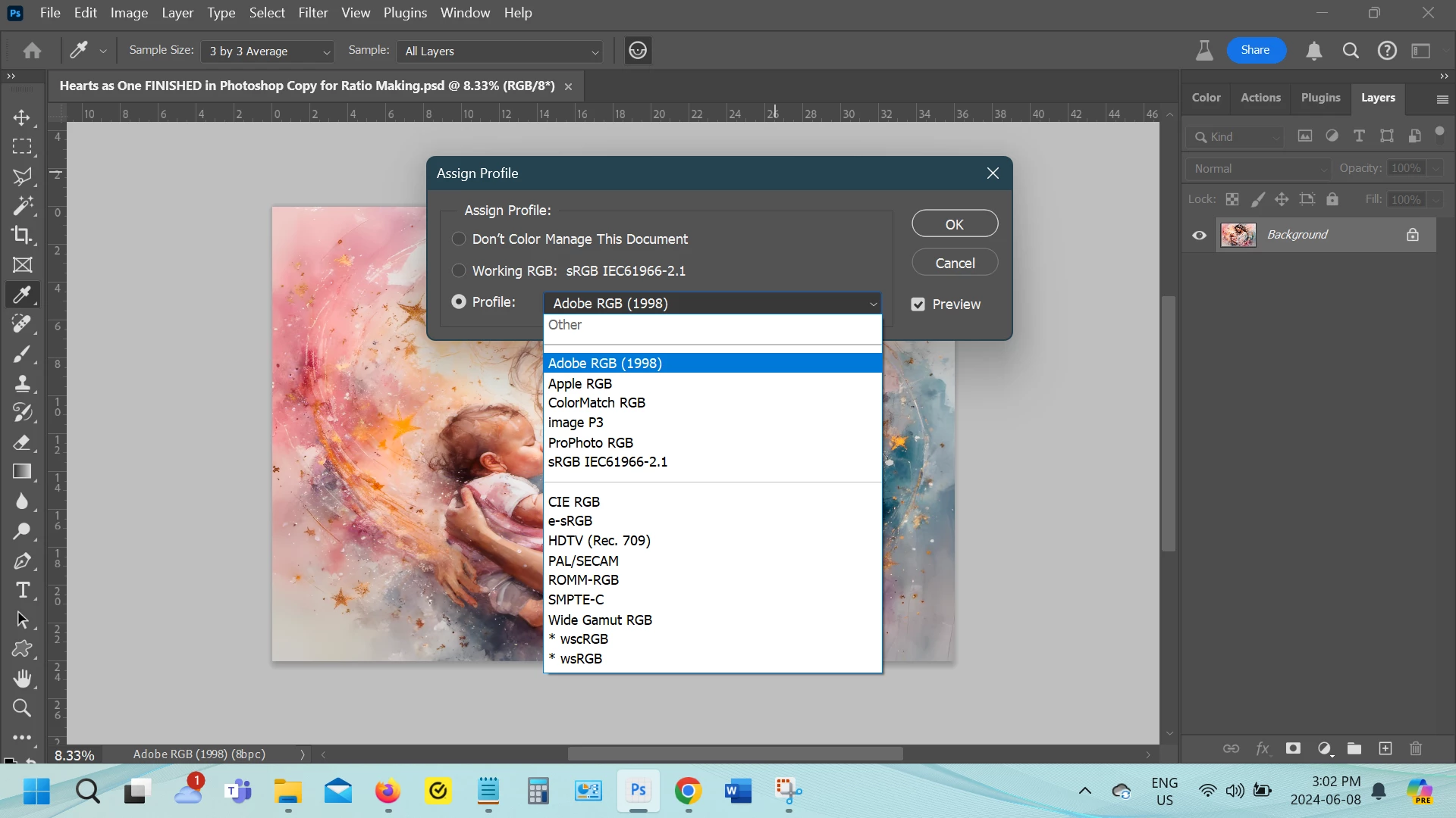

Hi @lilCystar you are doing the right thing =to ask about this - your document profile does not need to match the default profile in color settings, that's just a default - but you do need to have a document profile.
As @D Fosse commented, you should go to Edit > Assign Profile and choose from the list you'll see (start with sRGB or Adobe RGB, they are amongst the "working color spaces" loaded with Photoshop so are likely candidates) - you'll see that choosing a profile can alter the image appearance.
Once the profile is assigned (and down the line, embedded) that sets the appearance. If you are working on a properly calibrated monitor display screen you can trust your opinion as to what profile to assign based on appearance.
Unless you can go back to the image originator and check what profile should be assigned, you have little choice but to use your best guess based on appearance.

The file I painted this i, quite unforetuantely, had no color profile. It says it has: Untagged RGB (8bpc).
I have limited profiles I can Assign it now.

Should I assign it: Adobe RGB?

"Untagged" means there is no color profile. You need to assign one right away, before you do any work (Edit > Assign Profile).
Those color setting presets are not important. The only important setting is Policies. It should always be set to "Preserve Embedded Profiles". This is the default; don't change it.
What matters is the embedded profile. It will always override your working space. That's how modern color management is intended to work.

  1. Which color profile should I assign it as CYMK is not available? (see screenshot for what I am able to choose from.)
  2. Which color profile should I convert it to for home printing use and screen use?

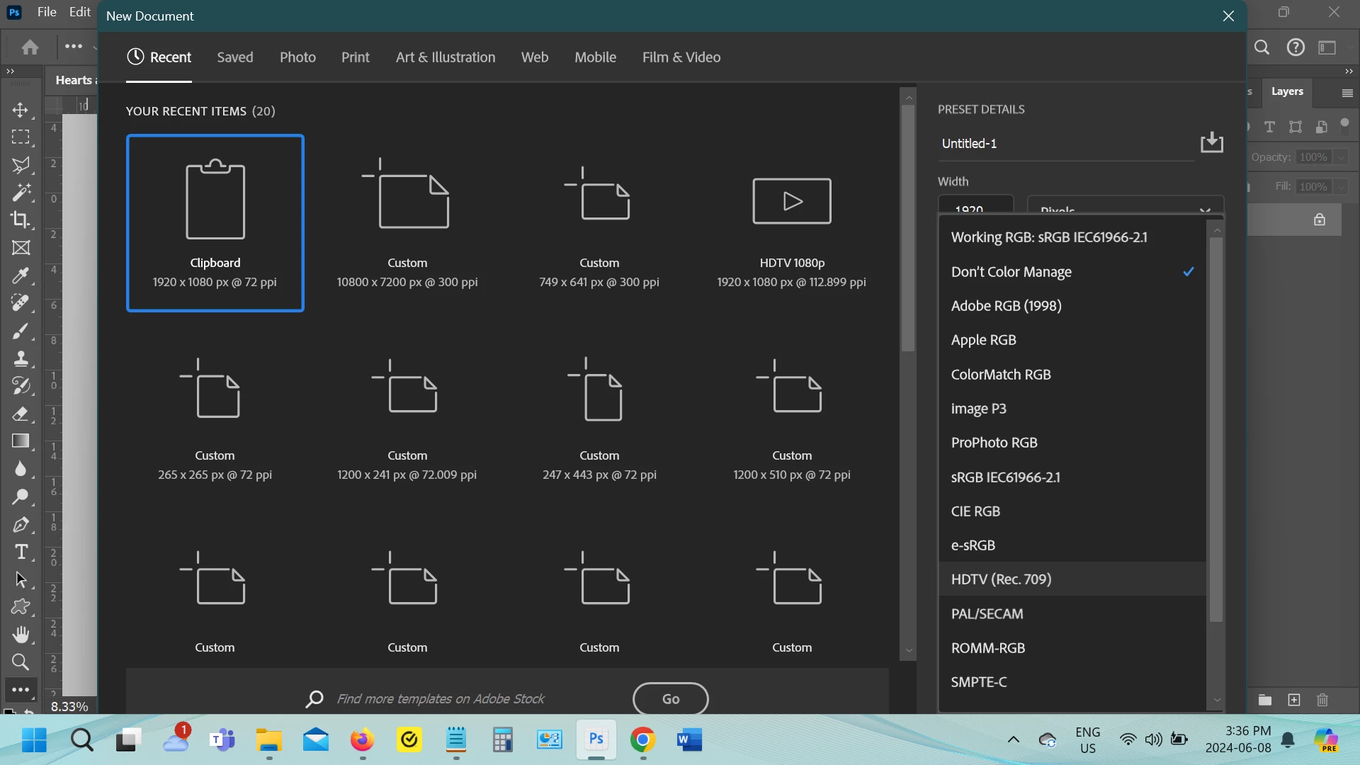

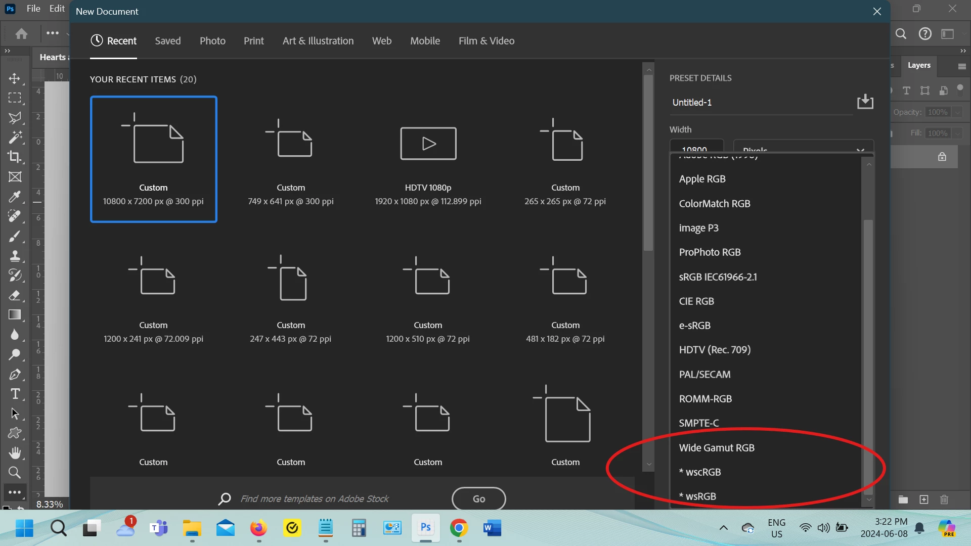

  3. Lastly, when I make new files in future, to create digital paintings in, which profile should I use as CYMK is not offered here either? (See screenshots 2 and 3 for what I can create new files with.)
