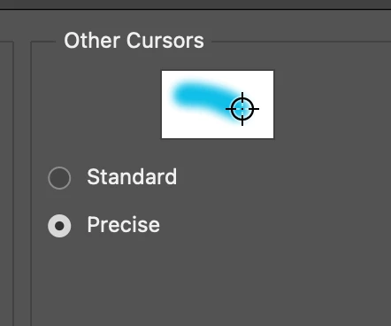

Hi @AnnaShoots11622868 go to Preferences/Cursors and turn off Precise under "Other Cursors".
April 21, 2023
Hi Kevin, I found Preferences - Cursors but Precise was not checked.  Just in case I checked it.  No good. Went back and unchecked it.  it still stays as a cross-hair (aka large plus sign).  Any other ideas?  Thanks!  Anna

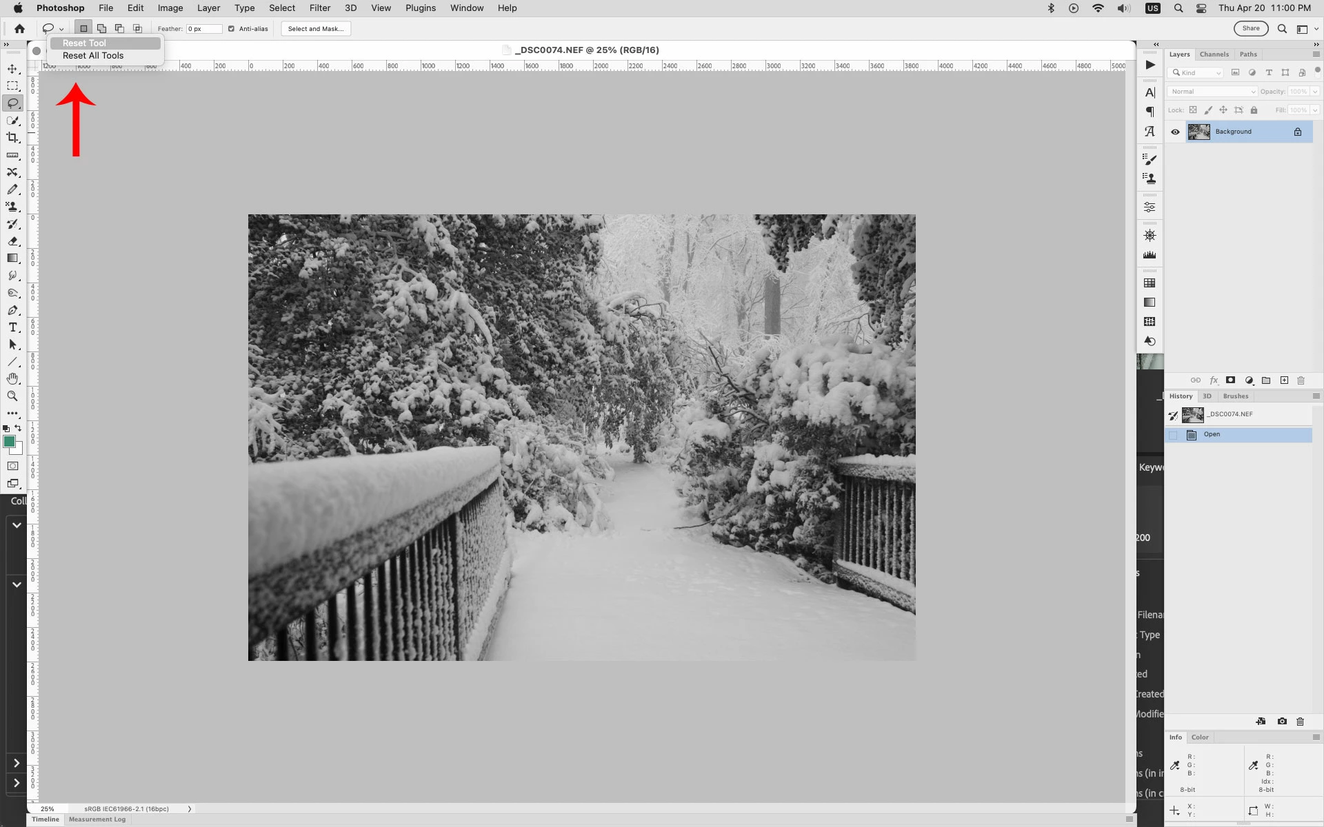

If it's affecting all documents then i would suggest resetting the Lasso and Polygonal Tools by right clicking on the respective icon at the left side of the tool options bar and clicking Reset Tool.
April 21, 2023
Hi Jeff, When I right click on the Lasso icon on the left side of the tool options bar it just shows me the 3 lasso tool options and doesn’t show me a Reset Tool. Is there any other way of accessing the Reset Tool? Thanks! Anna
April 21, 2023
OK, I  have now seen your picture, found the resent tool, pressed it but it still stays as a cross-hair (aka large plus sign).  Any other ideas?  Thanks!  Anna
