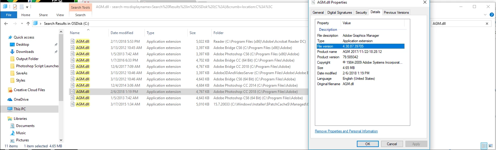

    February 20, 2018
    AGM.DLL is Adobe Graphic manager.  Make sure you Display adapter's Device Driver install into you OS is up to date.
    JJMack
    JanJL7Author
    February 22, 2018
    Thank you so much for your quick reply.
    Checked the version number of AGM.dll in the PS CC 2018 folder and it is 4.30.87.39705
    Strangely, my Lightroom Classic is working well with AGM.dll in the LR Classic folder and it is 4.30.60.36125 and
    Strangely, my Photoshop CS6 is working well with AGM.dll in the PS CS6 folder and it is 4.26.2020743.
    Tried to have Win10 update the NVidea GeForce 310 video card driver and an internet search results in "you have the latest driver installed".
    Can a downlevel AGM.dll from PS CC before my last update to PS CC possibly get PS CC 2018 to not crash ?  or do I have to somehow remove the last PS CC 2018 update to get it working again ?
