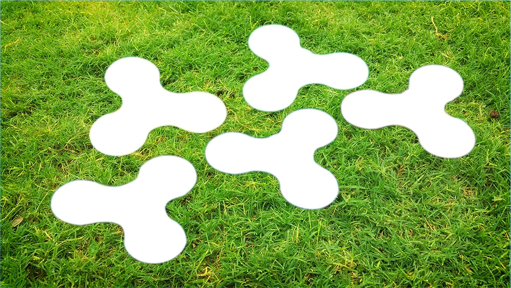

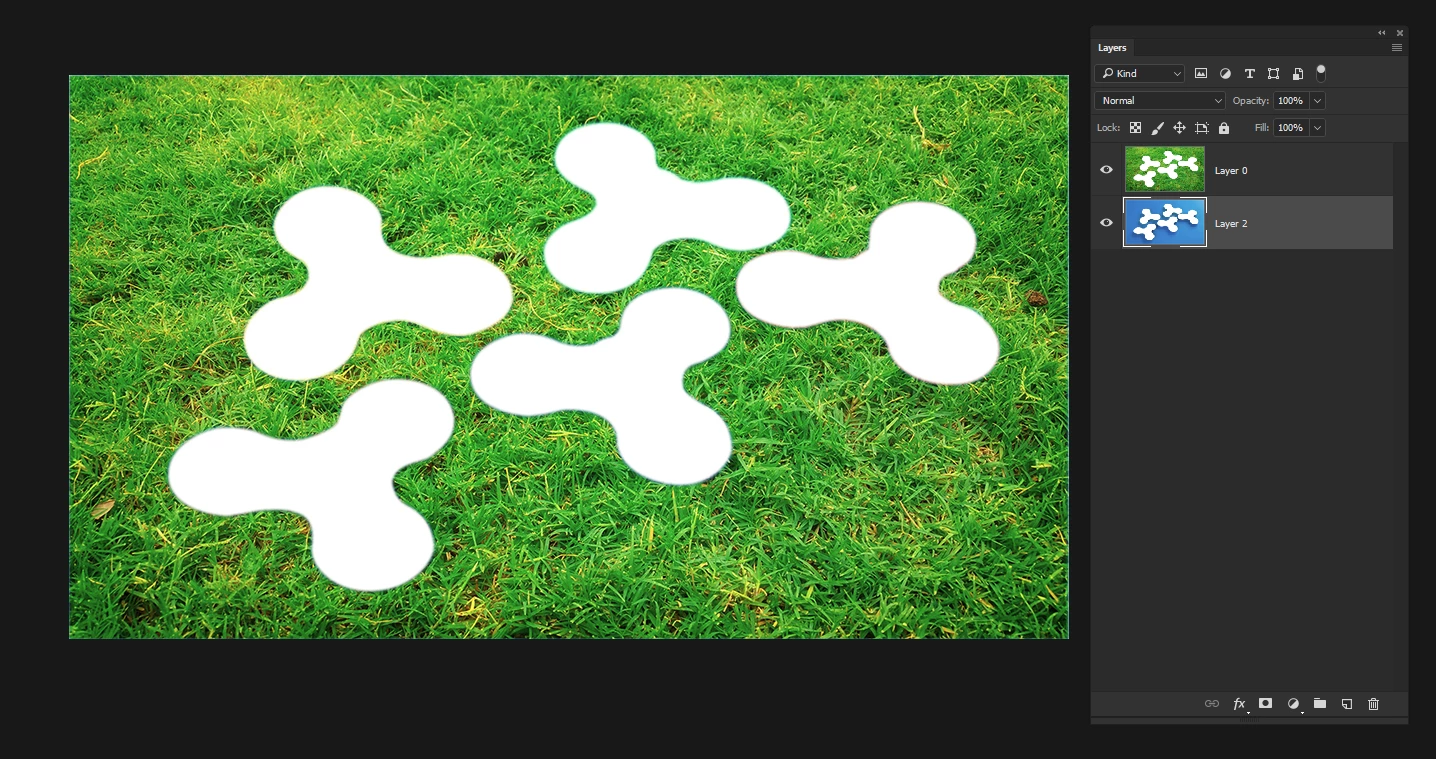

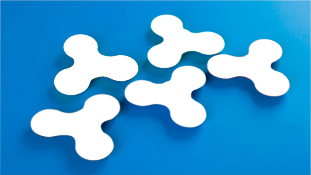

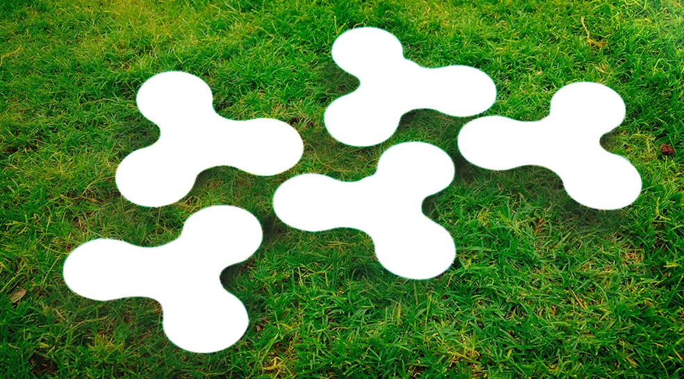

I include 2 jpeg's: one with green grass with no shadows and one blue background with some shadows in it (don't mind the gaps). Now I want green grass with the shadows (tones) of the other image shining through it. All i get with experimenting with the several layer blending modes is unsatisfying blue grass with no shadows.. Are blending modes the good answer or should I look in another direction?

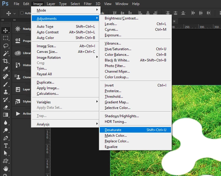

2) As Theresa suggested desaturate the blue layer

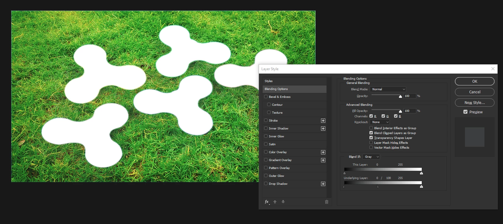

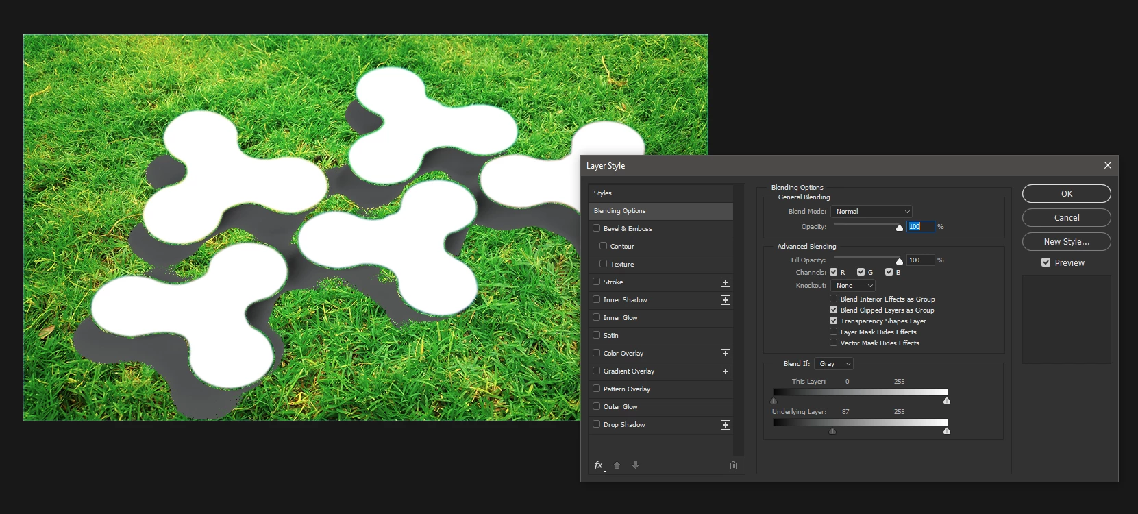

3) Double click the grass layer and use the lower slider to make the shadow tones break through the upper layer, like below
4) Smooth the transition by splitting the slider

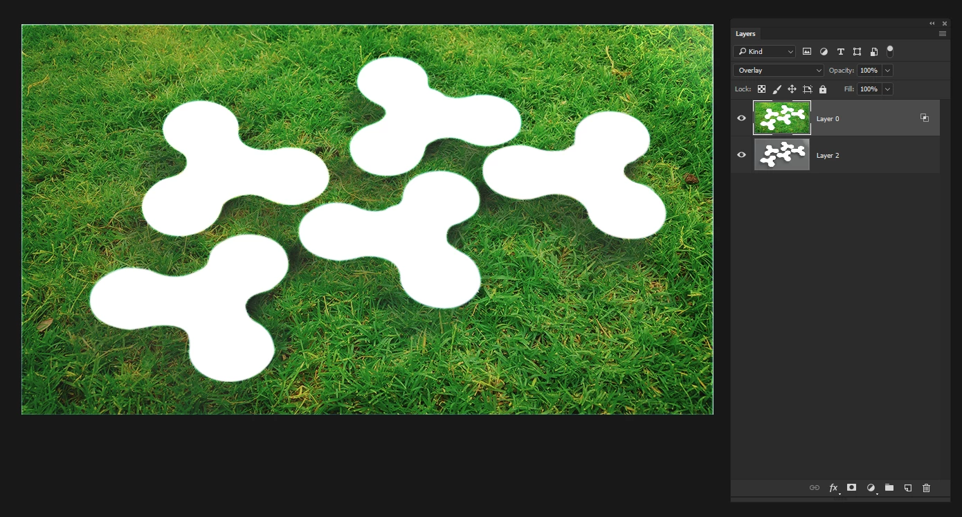

5) Change the blend mode of the grass layer to 'Overlay'

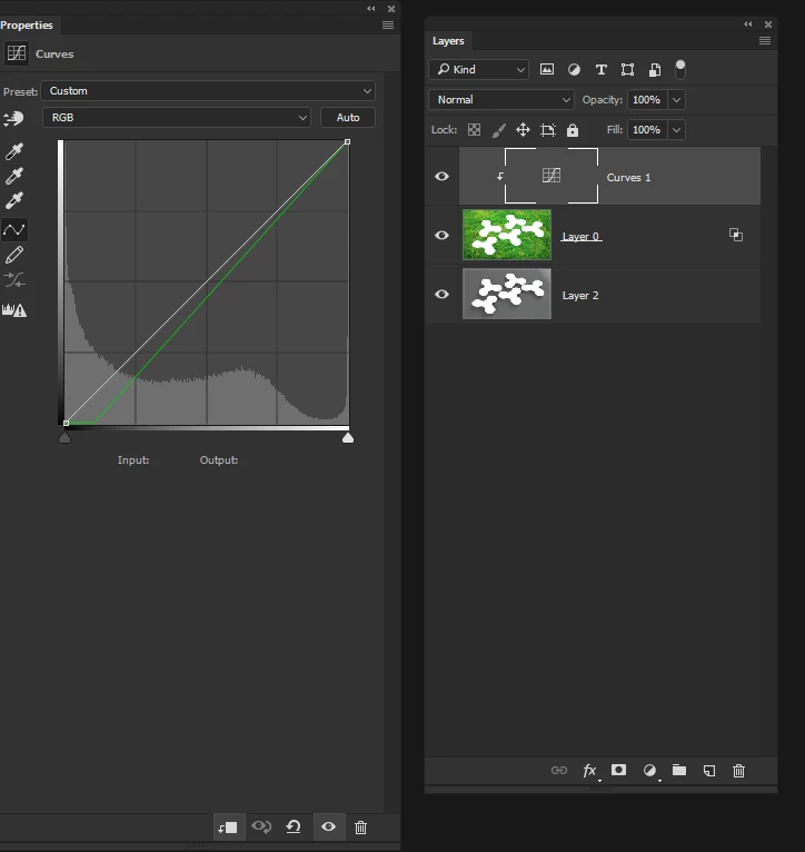

6) There will be a color shift which can easily be fixed by clipping a curves adjustment layer to the grass layer and adjusting the curve wor the green channel

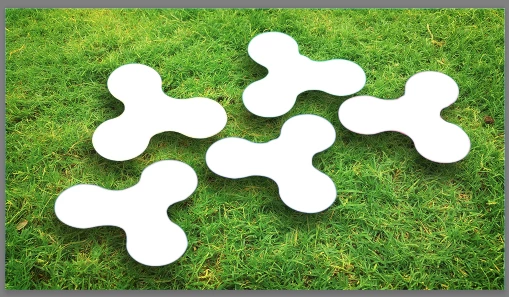

Final image looks like this. Of course the color of the grass is down to personal taste, below it's oversaturated, but the shadows look more real and less computer generated.

Try taking the color out of the blue layer. Hue Saturation adjustment should work fine. Take the saturation all the way down. The but that layer on top of the green layer and use the overlay blend mode.
