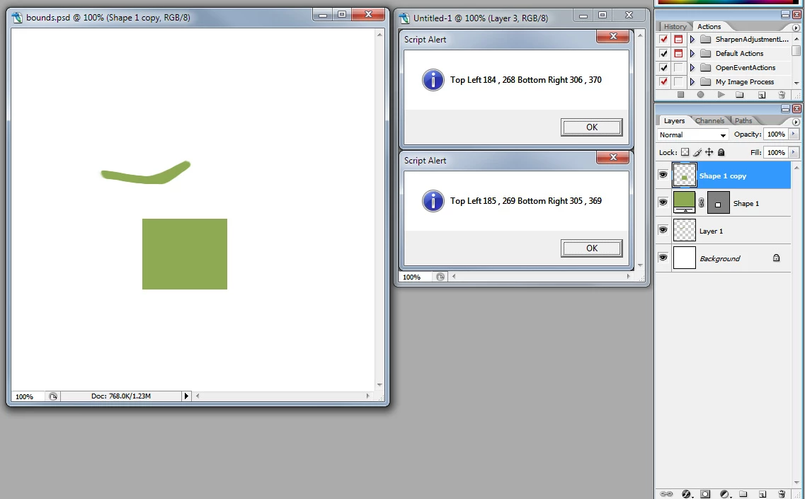

I'm trying to get the X, Y positions of a layer using layerRef.bounds. However, when the layer is a vector shape, the values returned are wrong by one or two pixels.
This happens in CS5 and CS6, but the correct values are returned in CC.
What is a way around this to make it work in CS5 and CS6?
Thanks!

To work around the problem in cs5 and Cs6 you could try creating a temp work layer for shape layers like it but not a shape.  Dupe the layer, rastezise the layer and check if its bounds are what you want. then delete the work layer.

Thanks JJMack for the answer! I was hoping there was a less messy way to deal with it.
What I'm doing currently is: my workflow involves trimming the layers to their contents. I take the bounds before and after trimming and calculate the correct bounds.

Here's a file: https://dl.dropboxusercontent.com/u/3901152/bounds.psd
The X,Y positions of the shape's top-left corner are 185px and 269px according to Photoshop. But the bounds function gives them as 184 and 268. (Both CS5 and CS6)
The bounds of Layer 1 (which is just a brush stroke) are returned properly.

It may depend on the CS6 version there are 3 Perpetual Mac is version 13.0.6 Perpetual Windows version 13.0.1.3 and the Subscription version 13.1.2. I use the  Subscription version 13.1.2 and it return the correct values  for the shape layer. I doe no have CS5 installed but do have CS2 installed  it return the incorrect values you posted. So I tried my purposed work around in CS2 it would work. The size was also wrong for then bottom right corner position was off like the top left.
