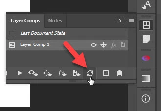

If I can undersand your problem correctly then you are missing feature to update layer comp, take a look at screenshot below.
May 2, 2020
I have that button and understand I need to press it. But to have to press it every time I add a layer gets very time consuming very fast. Especially if there are lot of layer comps
