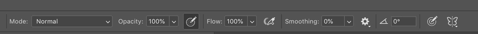

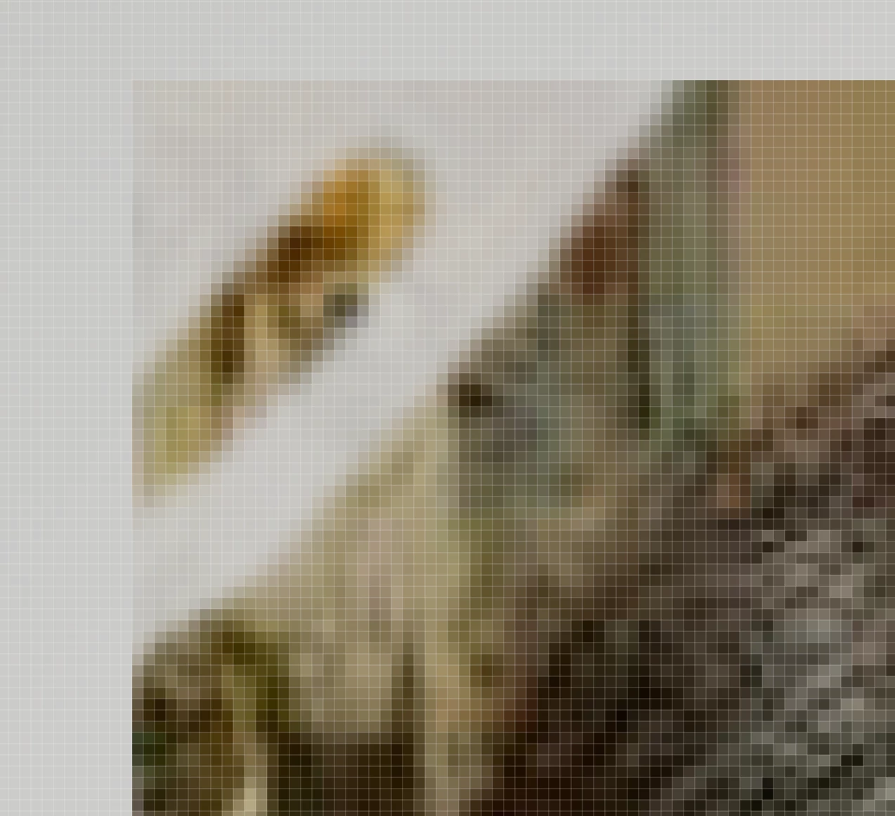

I have to remove the background of an image and I want to use a layer mask.
But when I use the conceal brush it does not conceal the area fully it looks like the brush is set with an opacity. Please see the attached image.
I have checked the settings and the colour mode is set in RGB and the opacity of the brush is 100%.
The reveal brush works fine, any help appreciated.

Correct answer davescm
Check the brush colour. Is it black i.e. RGB 0,0,0 ? It is easy to be caught out by a colour that looks black but is not quite 0,0,0
Dave
davescm
davescmCommunity ExpertCorrect answer
November 27, 2019
Dave
November 27, 2019
Yes, that was it, I checked everything else and overlooked the RGB settings for the brush.
Thanks for the help, much appreciated.
JohanElzenga
November 27, 2019
Check the Flow of the brush, and check that the Mode is set to 'normal'.
-- Johan W. Elzenga
November 27, 2019
Thanks for responding the Flow is set at 100% and the mode is set to Normal.
Can you think of anything else?
Thanks.
