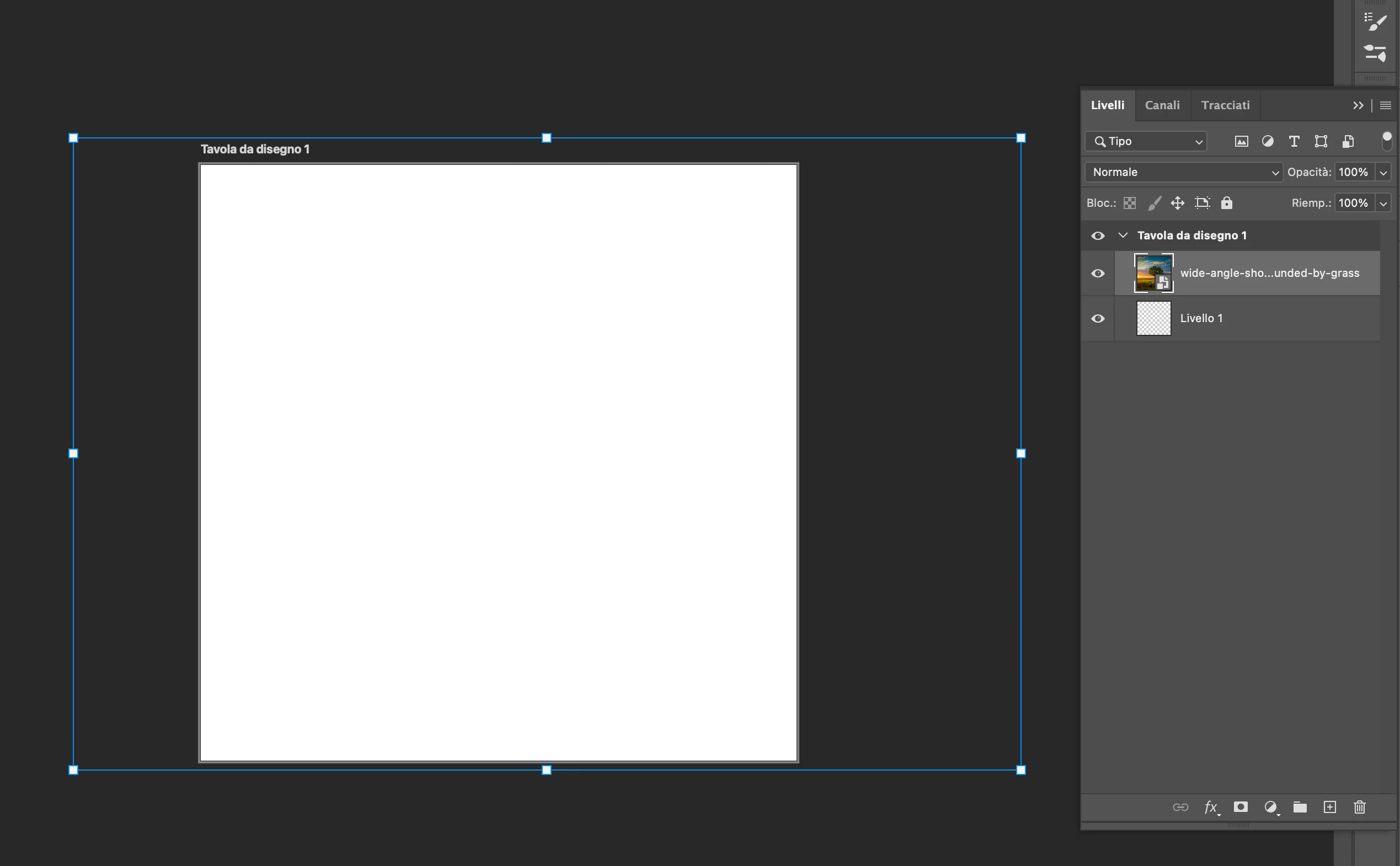

Photoshop 23.2.2 and previous versions. Unfortunately still persists a bug that doesn't show layers' content on multiple artboards documents. Layers are not visualized (like they were empty) and background is visualized white. You can select objects  despite they are not visible. However if you export to any raster format you will see the file as you designed it. Actually it's not possible to work on these type of documents, both new and previously created ones. Please help. Here is a screenshot.

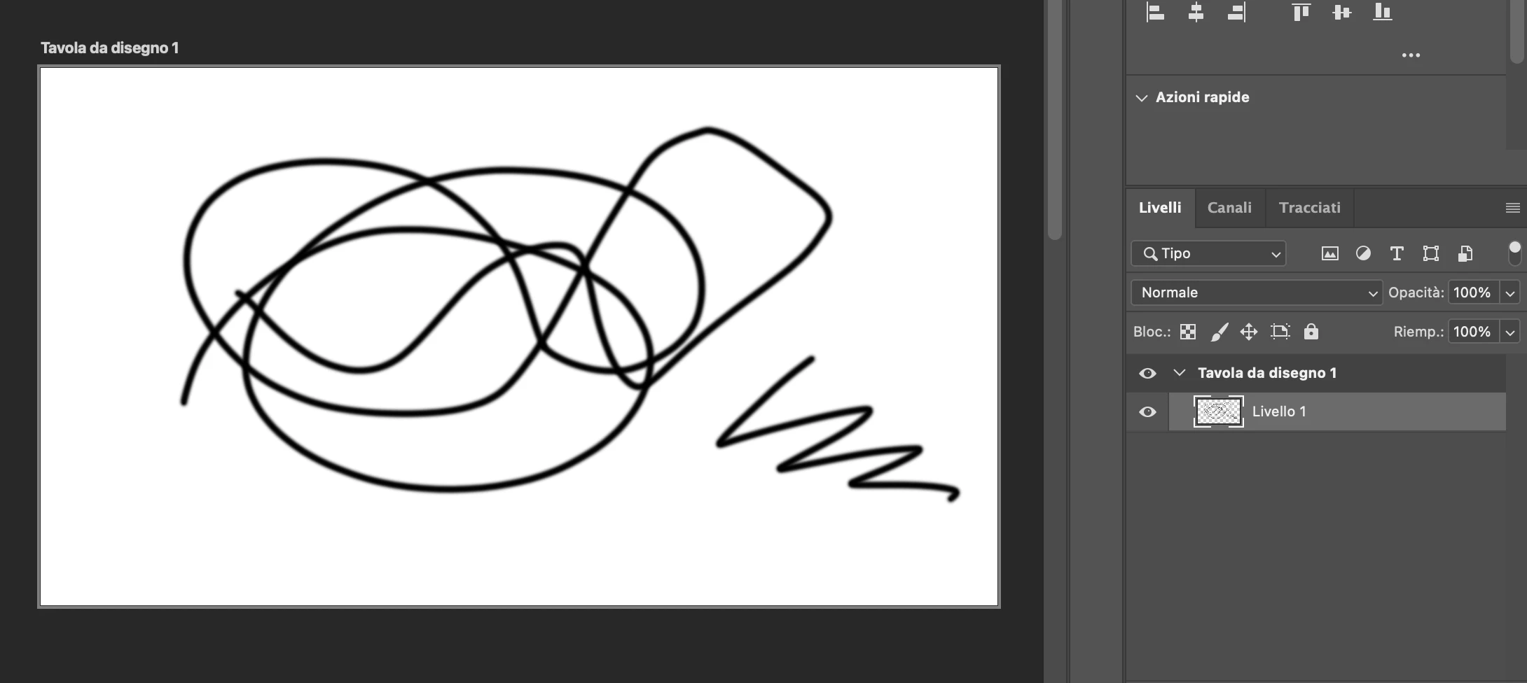

00Andy
00AndyAuthor
March 16, 2022
Yes it worked fine! Thank you. Here is a screenshot. How can I sen you the preferences folder?
