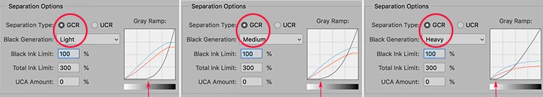

If you were to choose Edit > Color Settings > CMYK > Custom CMYK you would see the difference in Gray Ramp as you go from the default of Medium to Heavy.  (Note: Although total ink limit in the illustration is set to 300% rather than your 320% the effect in the ramp shape is unaffected.)
Oddly enough, if the art consists of photographs and includes flesh tones -- portraits, for example -- I have found it helpful to change the GCR from Medium to Light. If you notice, that change introduces the black at about 50% and is less likely to be part of the caucasian flesh tone mixture.
