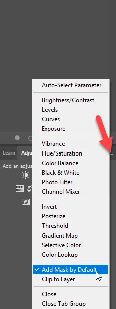

    Just to check what you want to ask in this part of question:
    Levels (or any adjustment) layer that already has a mask with it?
    If you do not have mask attached when creating new adjustment layer then display Window > Adjustment panel. Click on Adjustments panel menu (hamburger icon in the top right corner) and click on Add Mask by Default to appear check-mark.
    February 7, 2019
    Ah yes!!  That seemed to fix it!  Now is there any way to avoid that New Layer pop-menu before it adds the adjustment layer?
    Bojan Živković11378569
    February 7, 2019
    If you click on Curves in Adjustments panel it will create Curves without any pop-up dialog. Is that solution for you?
