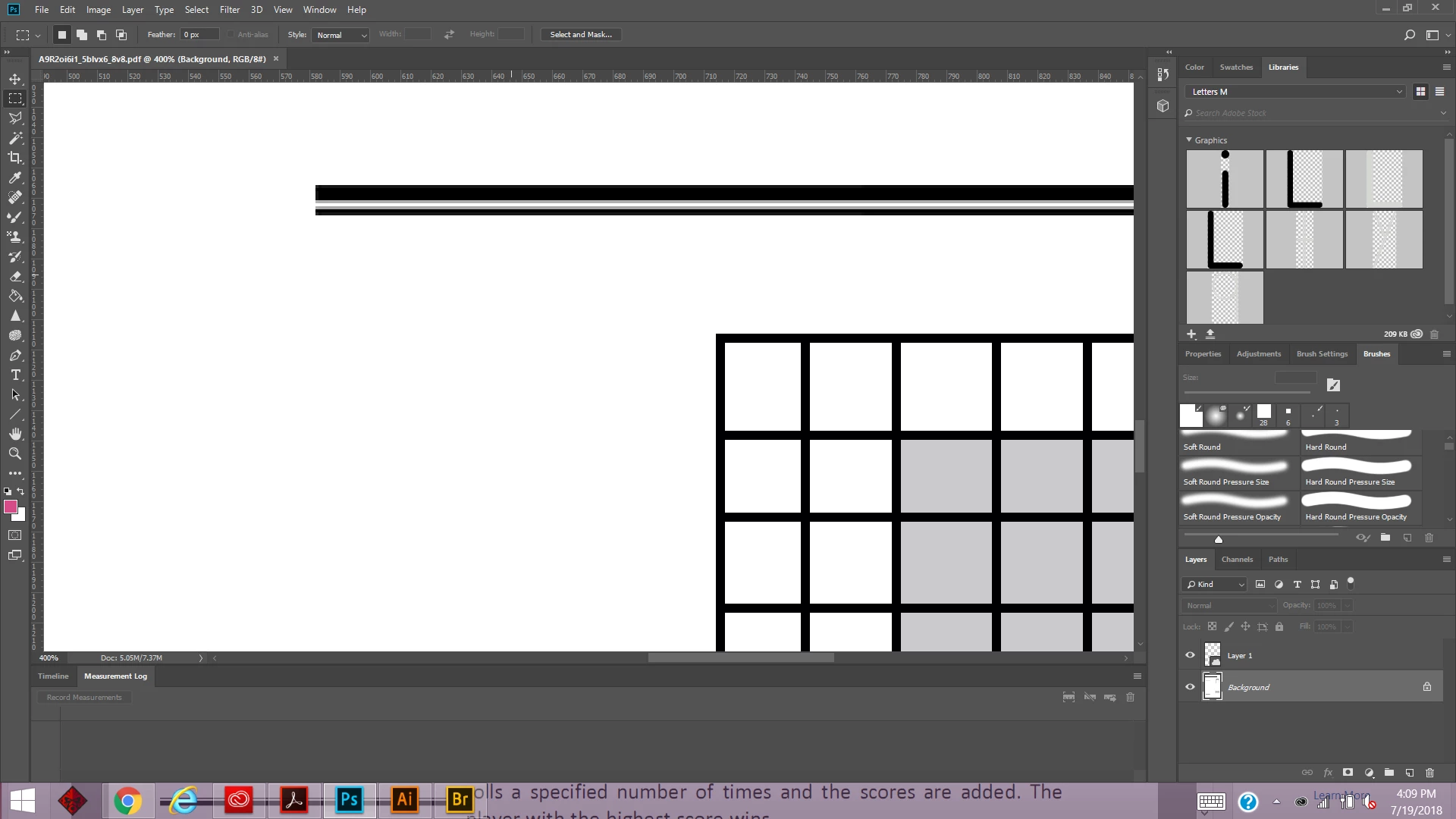

Ever since the Creative Cloud app update I've had issues. I had to remove everything from my laptop and then put it back on because my libraries wouldn't load. They now load but everything I import into Photoshop is blurry. These objects are made in photoshop and are straight lines on the grid. If I import onto the page I made the object on, it's clear. However, if I import it to a new page it's blurry. If I go to the object in the library and click "edit" the edges are clean. I can even copy and paste to a new page and they are clean but if I import they are blurry. I don't know if its a glitch or if I need to change a setting.

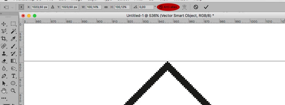

    Do you understand the concept of Anti-aliasing that comes to bear when converting vector data into pixel data (even Vector Smart Objects are effectively being represented as pixel data in a Photoshop file) unless it is turned off? (Though the anti-aliasing will only be applied once the placing or transformation is committed.)

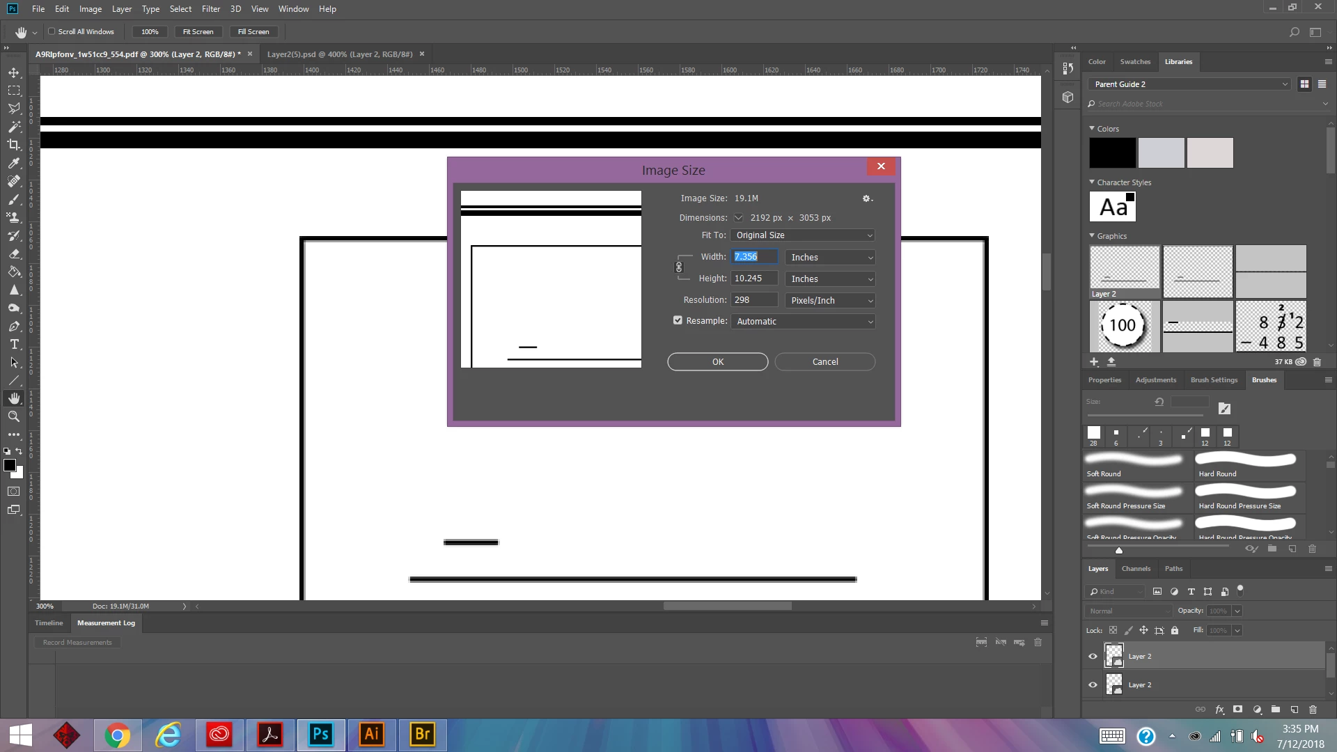

    Here is a screenshot of the image information for the background I am importing the library objects onto:
    There are two objects there behind the image window.  The top one is 2 lines that have clean edges.  The bottom object with the box has blurred edges now.  The 2 lines were created on this particular page and will import from the library clean but since the other one was not it's blurry.   However, both objects look clean when i click in the library to edit them.

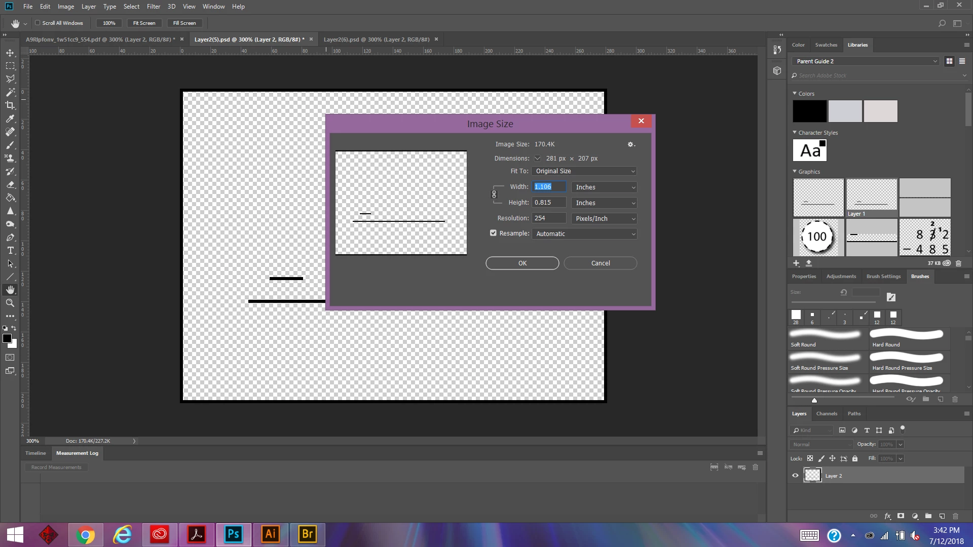

    Heres the image size info for the 2 lines.

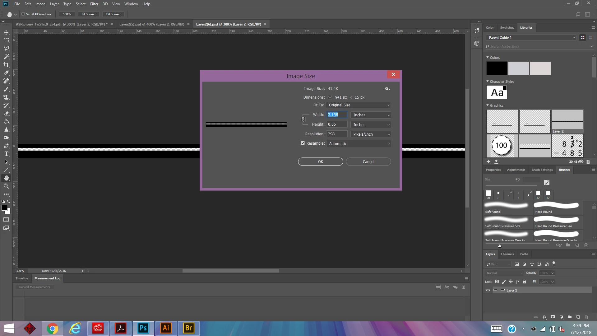

    Heres the image info for the box:
    I attempted to change the image size to 198 on the box but it blurs even more.  All of the objects I've made in photoshop were made on the same image size as the original background.  They look fine when you edit them but as soon as you drag and drop, they blur.  They didn't do that before the update.

    July 12, 2018
