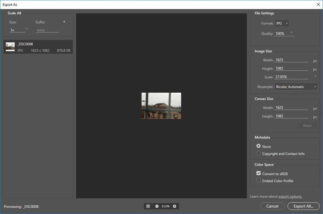

PS Export is set to Bicubic Automatic - which in fact is Bicubic Sharper going down and Bicubic Smoother going up.
Bicubic Sharper is fairly aggressive and personally I avoid it.

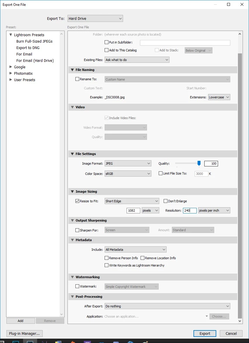

Thank you for your response Dave, I have not altered anything development wise in either LR or PS, I have attached the export settings that were used, just a resize down from 6000 x 4000 pixels to 1620 x 1082 (it was 1080 on the short edge but PS changed it itself).
Thanks for clarifying the significance of the DPI setting.

Have you tried a comparison without any resizing involved ?
It looks like there is a difference on the resizing routines in that the Lightroom example you posted measures 1623 x 1082 pixels and the Photoshop example you posted actually measures 1619 x 1082 ( despite the setting you show)
Photoshop offers different resizing algorithms which you could try, as well as Save for Web for exporting  - but I would first a comparison without resizing
There could also be a difference in the jpeg compression between Photoshop and Lightroom - but take it one step at a time.
