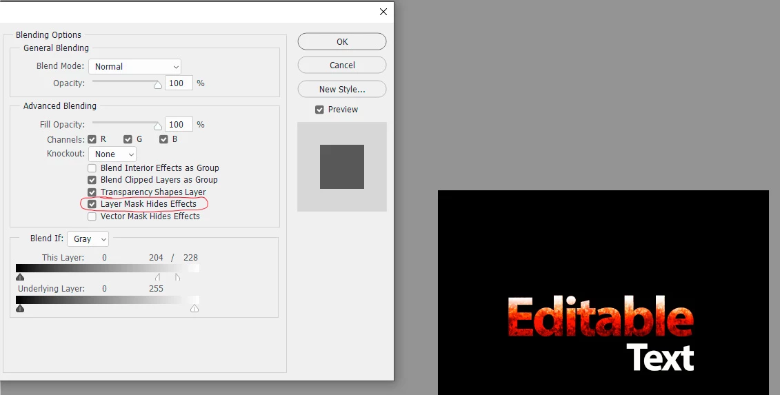

You'll need to apply a Layer Mask on the BlendIf Layer that you want to contain to just the single Underlying Layer. This way it will affect only the Layer below it. Here's how to do it.
1. Create a Layer Mask from the underlying layer.
2. Move this Layer Mask to the BlendIf Layer that is above it.
3. Open the settings on the BlendIf Layer and Check the "Layer Mask Hides Effects. See my example below. I hope this helps!

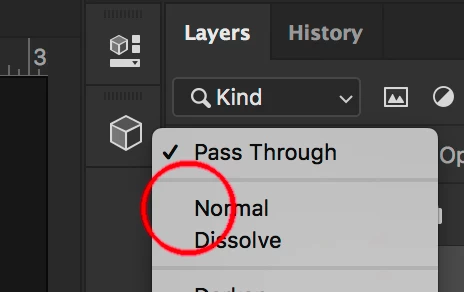

Change the group blending mode from the defautl of Pass through to normal.

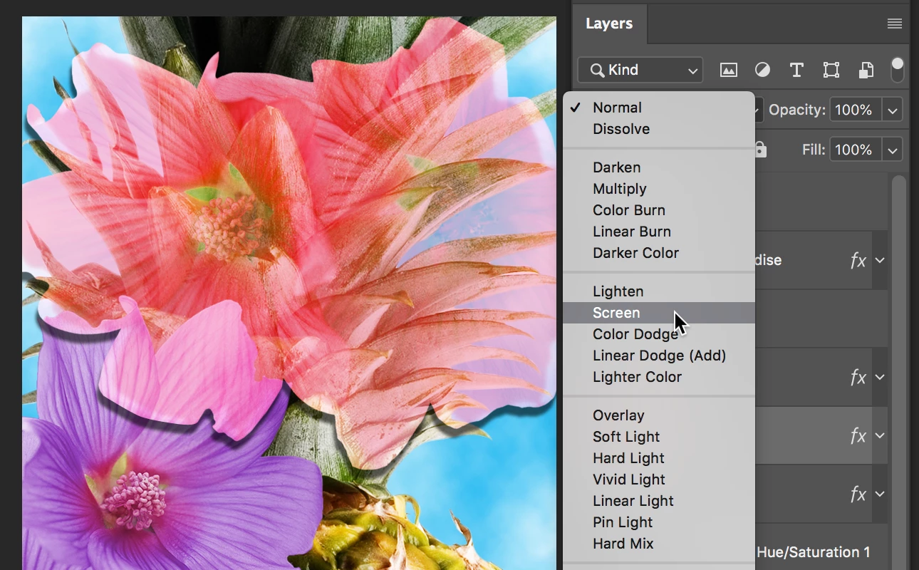

Which blending mode are you using? Yes, it should only affect the layer. Can you show a screenshot?
