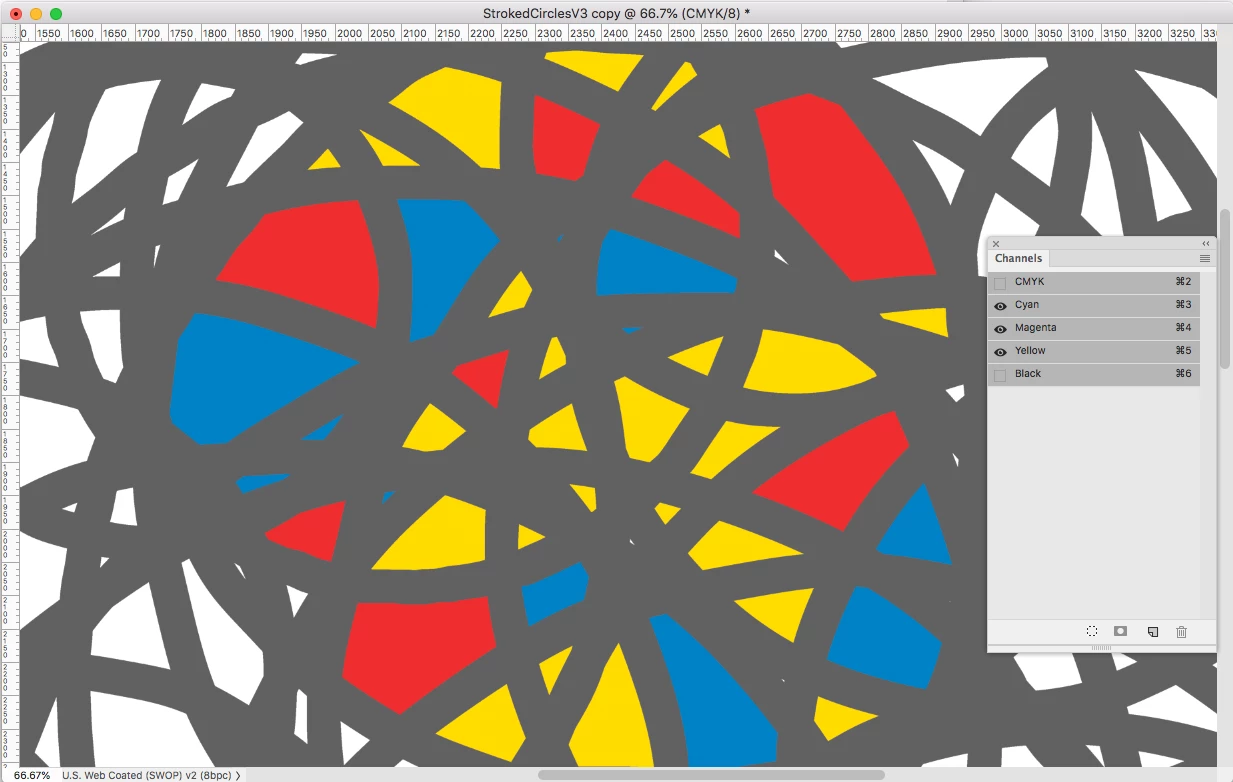

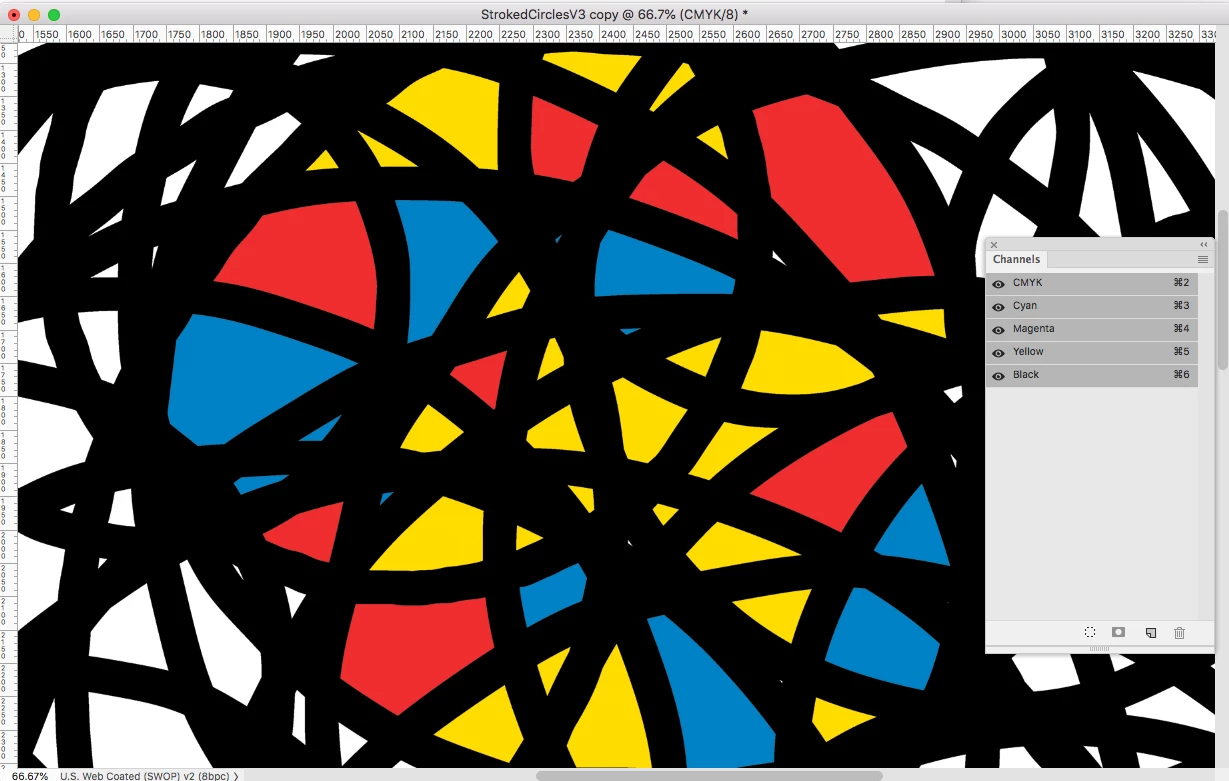

After you make the selection you need to expand it slightly. You will find that in the Selection menu. (I can’t remember if it says expand, or grow.) The necessary amount will depend on the size of your image. I’d start with at least 3 pixels.
Just note that to manually trap the black, you have to edit in CMYK mode and make sure the black line art is only in the Black channel. A conversion from RGB to CMYK would remove any layer expansions because the black line above would normally convert to 4-color.
rob day
May 11, 2019
As I need a final render which does not have gaps between shapes and no black lines. I have tried matting them.
What color mode are working in and what is the output going to be? If the mode is RGB, the black lines will be converted into 4-color black when the art gets converted to CMYK for output—the gaps won't be black only. For example here I'm hiding the CMYK Black channel after the color conversion:
