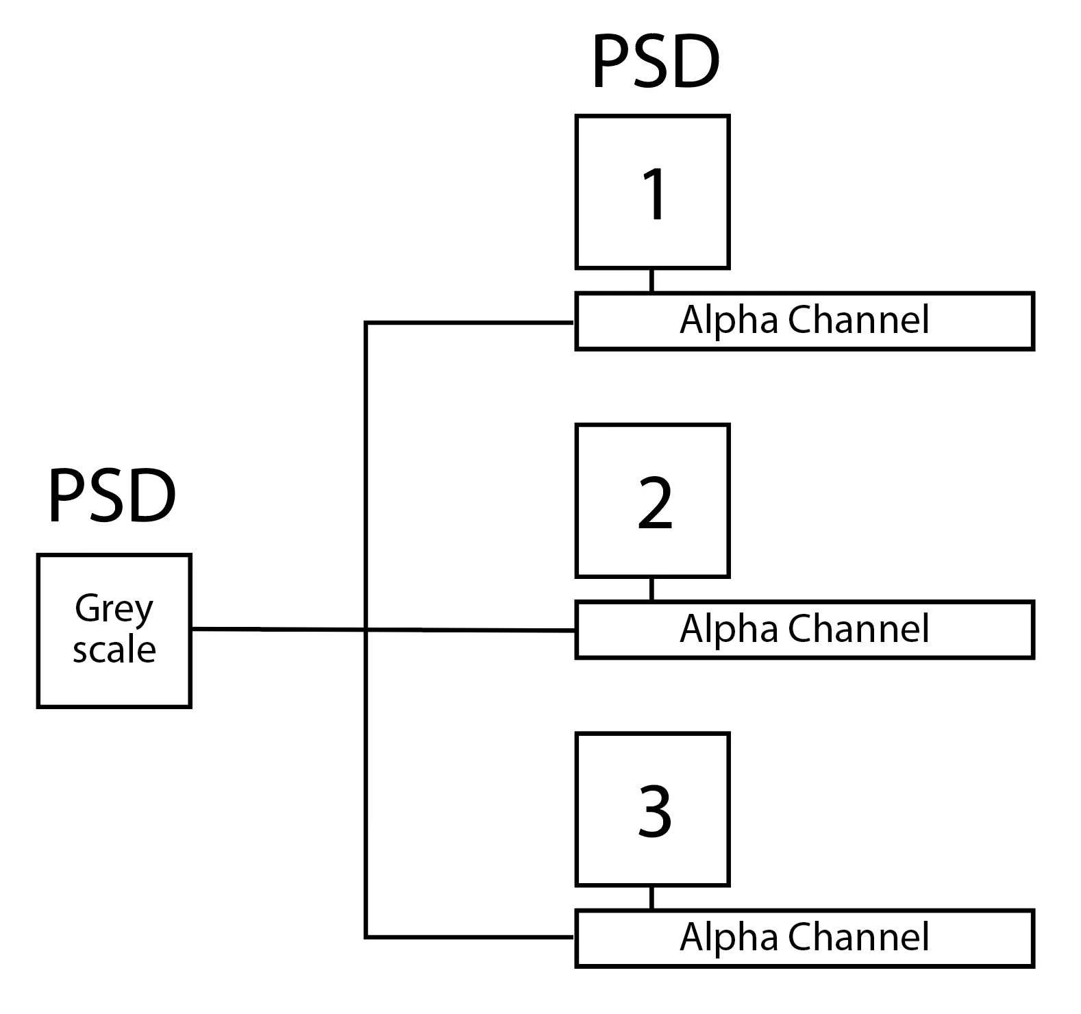

I have a series of different photoshop design files which a share the same alpha channel, which i have to tweak occasionally.
Rather than updating one then manually copy/pasting to every other design file everytime i make a change (16 files), is there a way of creating an external greyscale .psd and linking it to all the alpha channels?  Therefore, simply updating once and refresshing across the whole set of designs?
From what ive seen, there's no provision for smart objects in the channels.

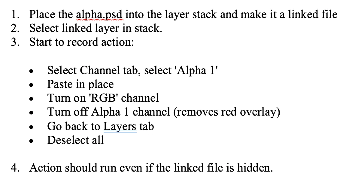

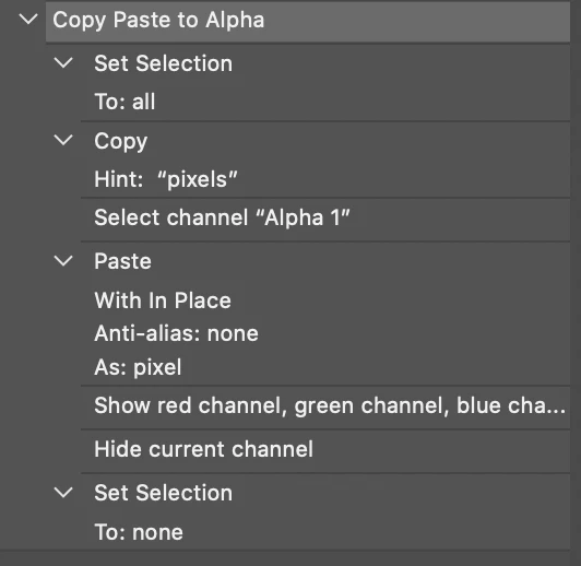

Your suggestion has been a great help, ive slimmed the workflow down... some reason this forum wont let me list so ive screen shotted my workflow:
This seems to work ok, unsure how robust it is so it may need modifying for a different purpose.

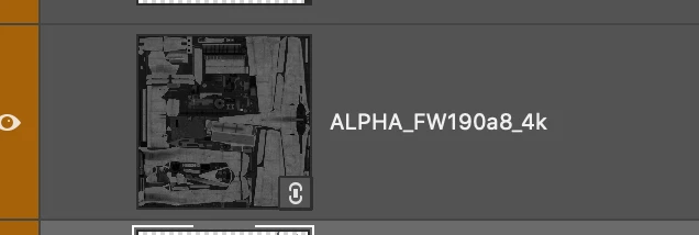

I originally hoped I could operate a linked alpha, much in the same way as a linked layer (see pic) works.  If I can automate a process which replicates this function - that would be brilliant! This means i can work on a single greyscale psd and apply it as an alpha across all my files.... rather than copy/paste into the alpha channel 16 times for every update.

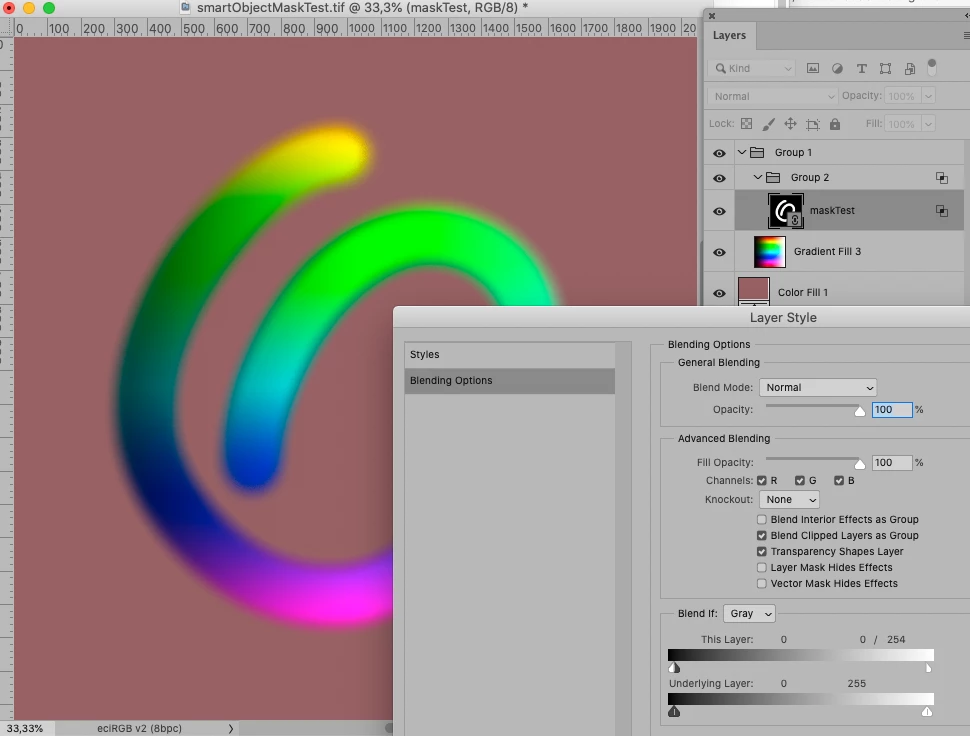

»From what ive seen, there's no provision for smart objects in the channels.«
Blend if-settings Knockout and Groups enable one to work around that.
Could you please post screenshots with the pertinent Panels (Toolbar, Layers, Options Bar, …) visible?

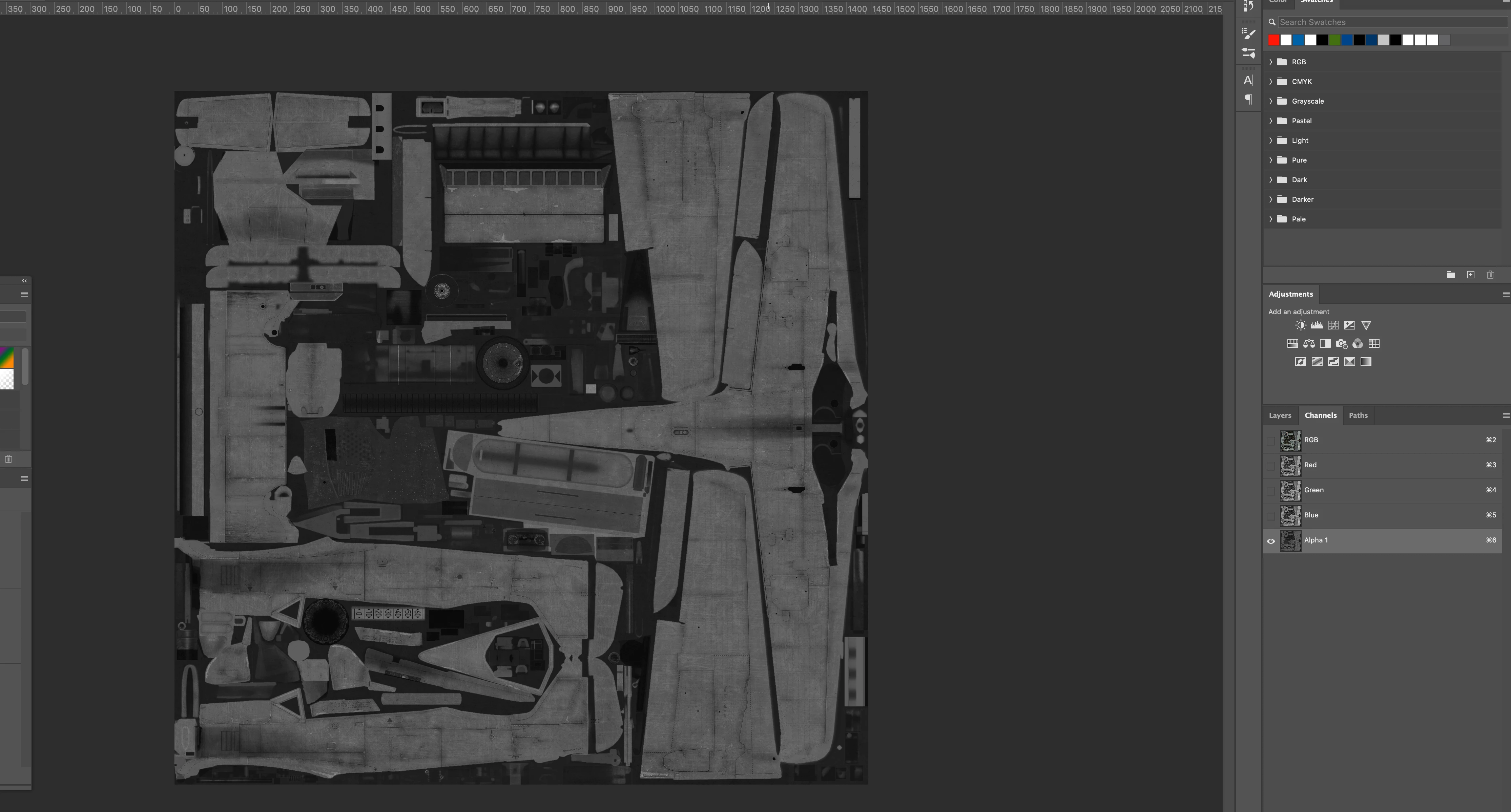

Unsure if this is what you need?
Cant see how blend-if is connected with channels?  Very keen to see what your suggested solution 🙂
