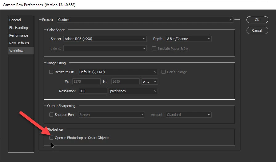

You can not open cr2 file directly in Photoshop, it must go through Adobe Camera Raw. What you have set in ACR preferences (which opens when you click on link at the bottom of ACR window) may cause your problem. Do you have Open in Photoshop as Smart Objects checked? Uncheck that option and try again.

Bojan... you're my idol !!
Works perfectly. Thanks a lot & happy new year !!
