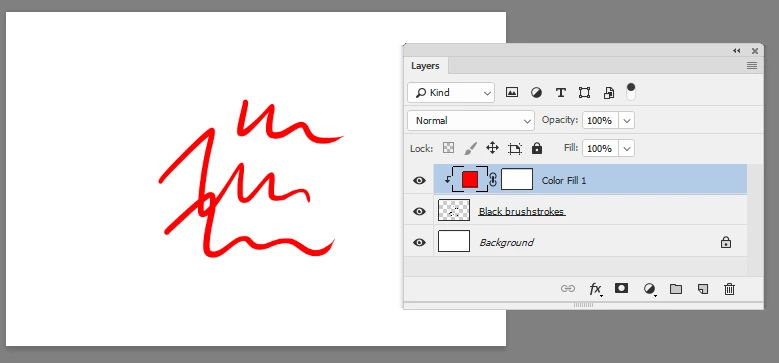

A better way though may be to add a solid color fill layer above your line drawing. Alt+Click on the border between the two (Opt+Click on Mac)  and the new color layer will clip to the pixels on the layer below. It will show only where the pixels are not transparent on the lower layer.  This has the advantage of being quick and is non-destructive i.e. the black drawing layer is untouched and the solid color fill can be changed later.
If the line drawing is on several layers then put them in a group and clip the color layer to the group.
