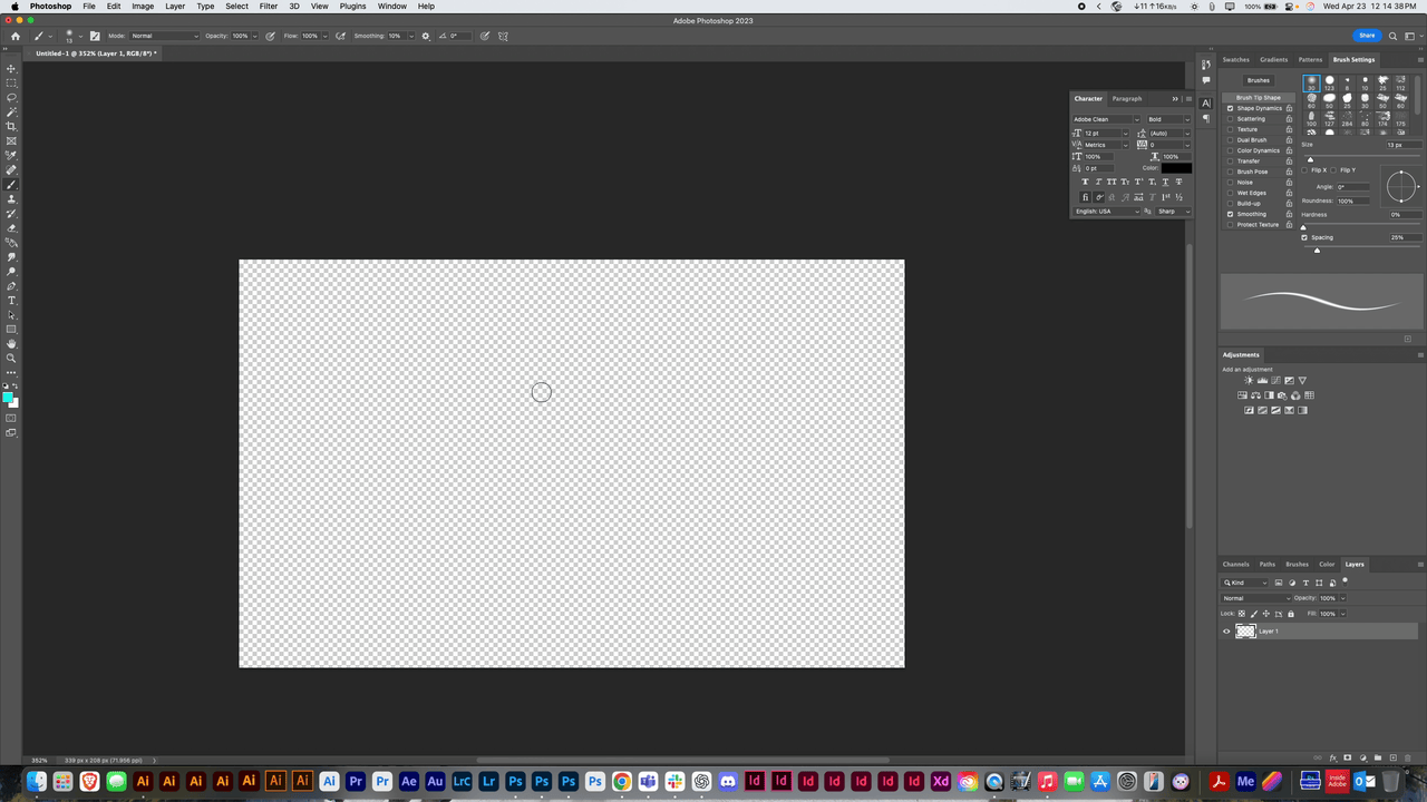

Hi @FrancescaSF,
Thanks so much for the detailed explanation and video — really helpful!
I tested this on my end, and I’m able to reproduce the same behavior even in Photoshop 2023, so it doesn’t seem to be a new issue introduced in version 26.5.0. It appears to be expected behavior, as locked layers can still be selected via Auto-Select.
That said, I want to ensure we’re 100% aligned — I’ve attached a screen recording showing what I did on my end. Could you please take a look and confirm if it matches what you’re experiencing?
Once I get your confirmation, I’ll be happy to cross-check this with the product team to see if this behavior is intentional or something that needs to be revisited.
Appreciate your patience!
