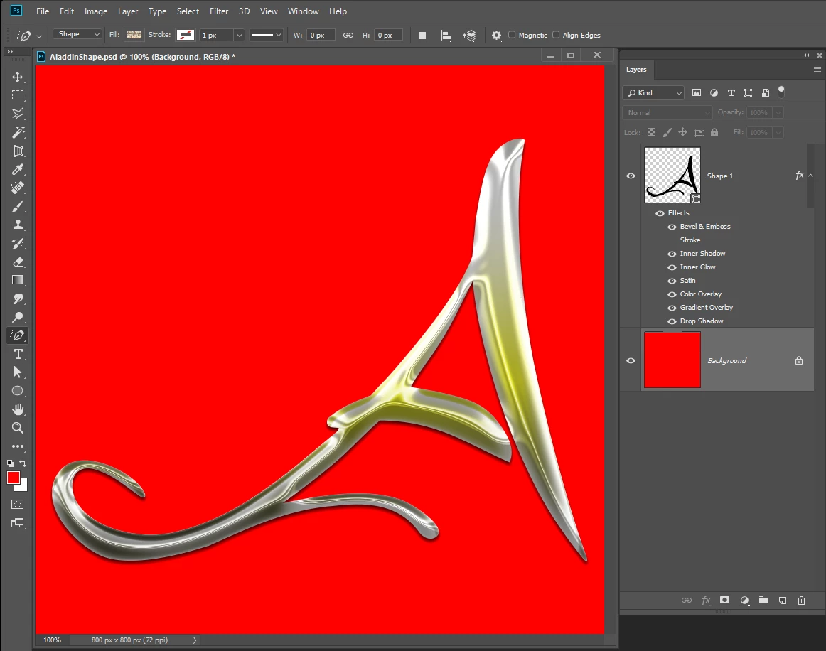

JJMack
August 25, 2018
If its a simple logo like an  "A" you can use the text tool and convert the text layer to a shape layer. Or use the curvature pen to trace the "A" Once you have the Path for the shape or pen tool you can edit the Path and define a custom shape which you can use for you logo for any size you need.  You can fill the shape with color, gradient or patten and stroke it.  You can use it as a clipping mask and style a shape layer.     Simple logo are easy to create and use in Photoshop.     Complex Logo use AI and save out SVG files so you can place them into a Photoshop document as a vector smart object.  Though there will be no paths in Photoshop the smart object layer will resize like  there were unlike other normal smart object layers which are just interpolated.
