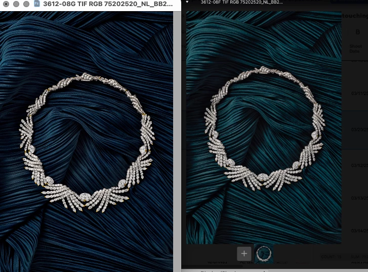

I know this is an old post but I just experienced something similar that is really troublesome. I flattened and saved an image as a jpg. As soon as I flattened it, the overall color changed (fairly drastically). As some have mentioned, I did not see this at 100% but I can not judge overall appearance at 100 % because the file is so large. What I did was to take the flattened jpg and pull in back into the original layered file to compare and the difference is very apparent. So my question is how to avoid this but also why would two files of the same image (one flattened and one in layers) viewed at the same magnification, appear different?
D Fosse
Mar 27, 2025 6:42 PM UTC
quote
By @kkrip
That's the giveaway.
Whenever something seems to change when merging layers, it's because you are not viewing at 100%. The merged result is correct. The preview is misleading and incorrect.
100% has nothing to do with size. It means one image pixel is represented by exactly one physical screen pixel.
For performance reasons, all blending and adjustment previews are calculated on the on-screen sample of the image. When you are zoomed out, that means a resampled and softened version of the image. Pixel levels are averaged out. You get a lot of intermediate values that aren't there in the full original data.
When you merge, commit an adjustment etc, the numbers are re-calculated on the full original data, pixel for pixel.
Viewing at 100% is the only way to avoid this, and get an accurate preview of the final result.
There is a feature request to calculate all blending and adjustment previews on the full pixel data. The problem is that this slows Photoshop down considerably, and would lead to a load of other customer complaints. So what we want is an option, transient and non-sticky, that allows this while also stating clearly what the implications are.
