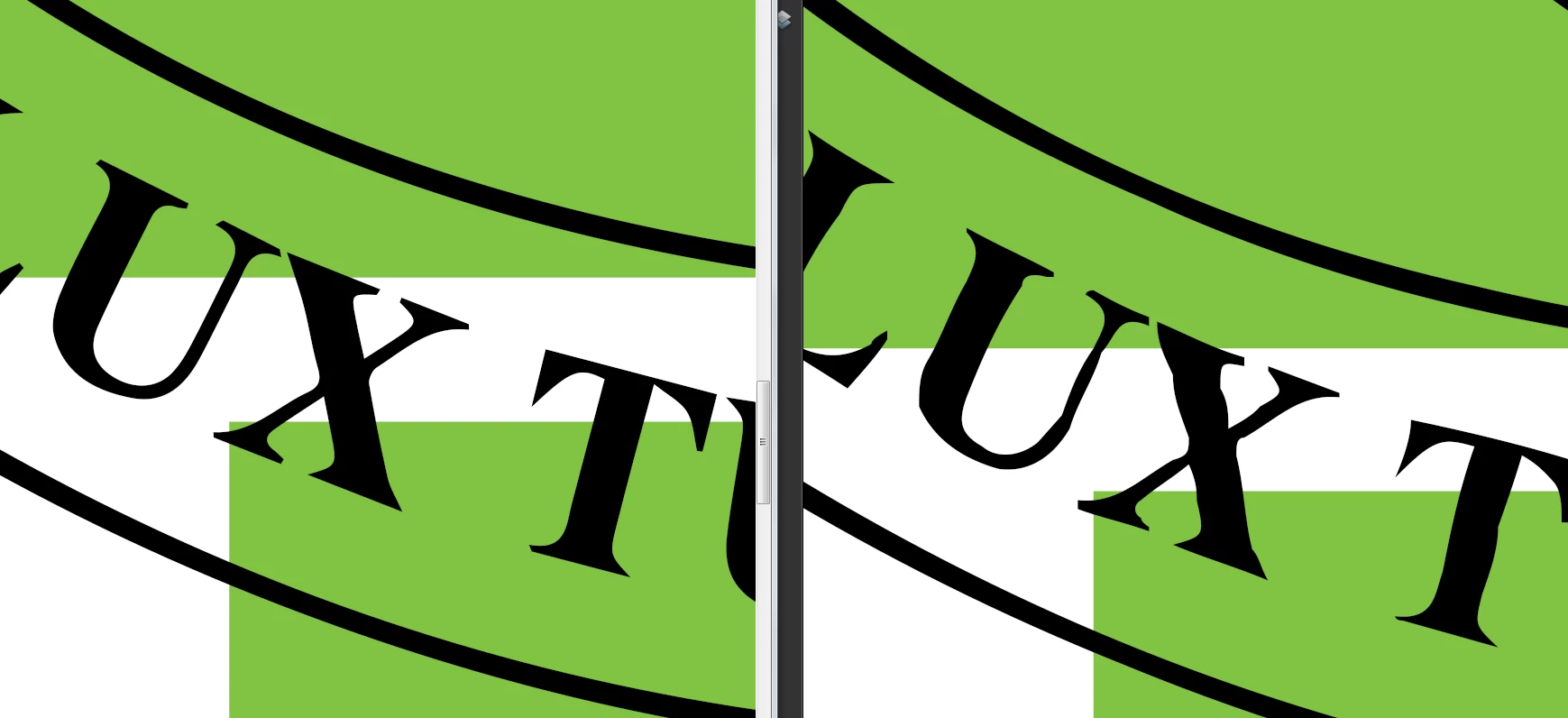

I have a custom script I've made to make layer compositions then output them into a multi-page PDF. The only way I can current see of doing that is with the makePDFPresentation() method. Everything works brilliantly EXCEPT the output multi-page PDF has really badly simplified vector shapes. They're still vector, but they're badly simplified. See the attached image which shows a PDF output in the normal way on the left, and using makePDFPresentation() on the right - notice the horrible wiggling in the 'x' in particular. I'm using the exact same PDFSaveOptions() in both.
So I know makePDFPresentation() is supposed to be DEPRECATED as per CS4 (but it still seems to generally work) but I can't see an alternative option to output a multi-page PDF.
Does anyone know if this is a bug in makePDFPresentation() or an intended 'feature', and also if there's a better way to output layer comps to a single multi-page PDF using just one script/click within Photoshop (rather than having to manually put multiple PDF pages together, or run one script in Ps then another somewhere else).

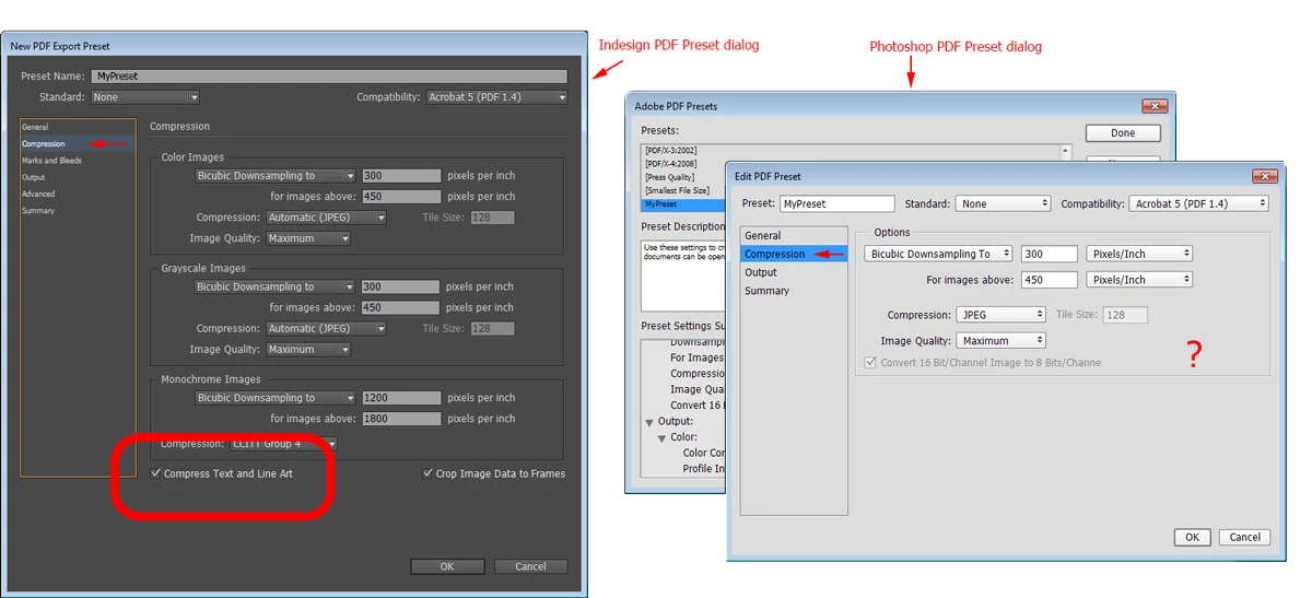

Regarding PDF Presets and the poor quality shape over paths, I have found that I can create first my own PDF Preset under Edit > Adobe PDF Presets...
The problem is that the option to disable the path compression, on Photoshop PDF Preset manager, doen't exist (we have it on Indesign PDF Preset compression manager).
But I had success to create a new PDF Preset on Indesign removing path compression, restart Photoshop, and the PDF Preset was accessible also on Photoshop.
It might be possible to use the code changing the new PDF Preset name I have created.
desc5.putString( stringIDToTypeID('pdfPresetFilename'), "MyPreset" );
But I did not tested it.
This are the PDF Preset managers on Indesign and Photoshop:

March 20, 2015
Pedro, I tried as you suggested and the tickbox in question for "compress text and line art" changes this line in the .joboptions file:
/CompressPages true
... I tried using makePDFPresentation() twice, once with a .joboptions with this set to true and one without (via PDFSaveOptions .presetFile) but the output was the same both times - shapes/paths being mangled.

March 18, 2015
To clarify, doc.saveAs(pdf, pdfOptions(), true, Extension.LOWERCASE); works perfectly whilst makePDFPresentation() causes the shape vector quality loss, both using the same PDFFileOptions.
