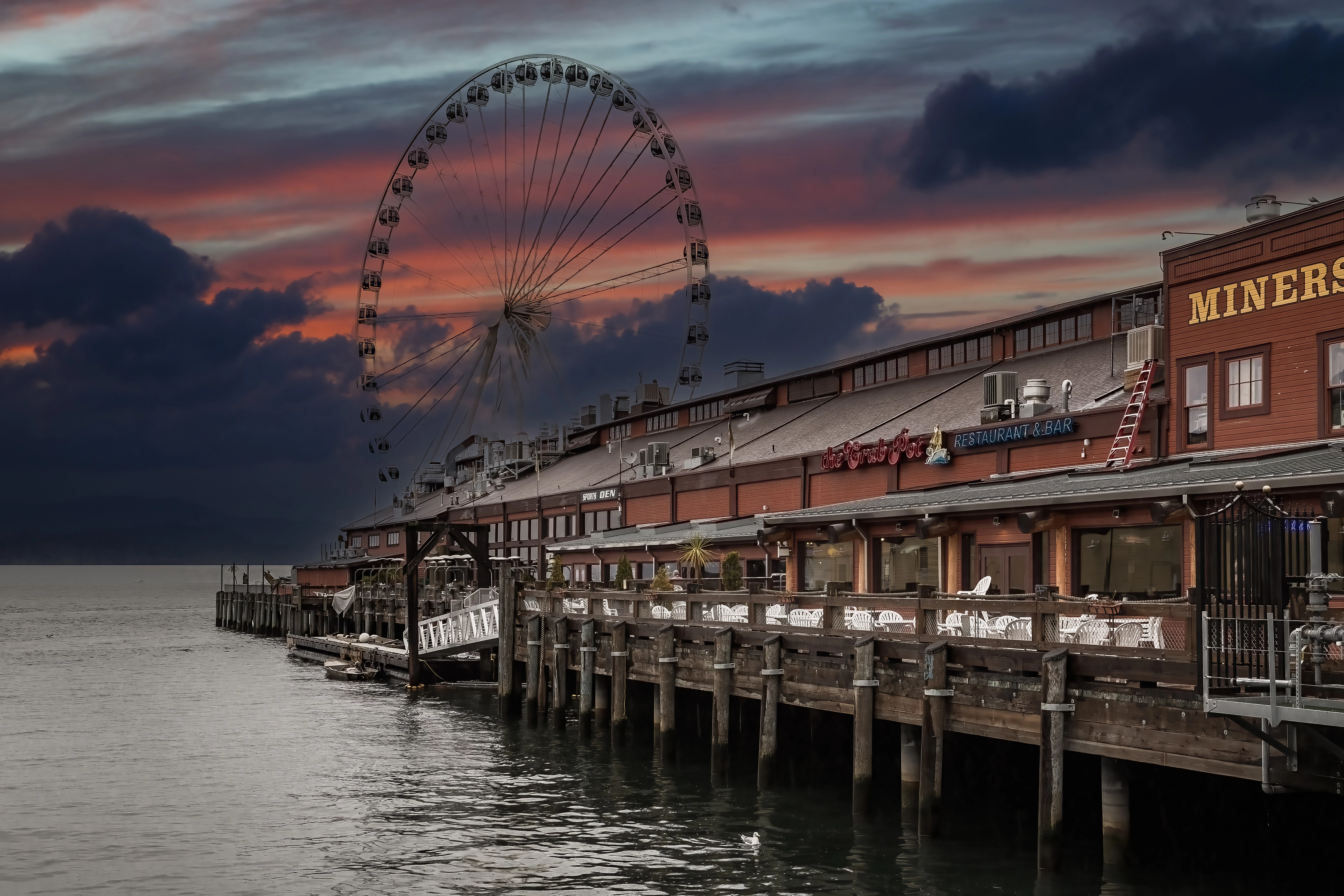

As a preface to my question, I am a longtime Lightroom user that occasionally makes forays into Photoshop 2022 to use tools that Lightroom either does not have or Photoshop does better. With that, I used Sky Replacment in PS. As you can see in the image, some of the spokes on the ferris wheel have been partially obliterated by the sky replacement.
With my limited experience with PS, this is where I could use some help. Can someone kindly recommend a way to restore the spokes of the ferris wheel?

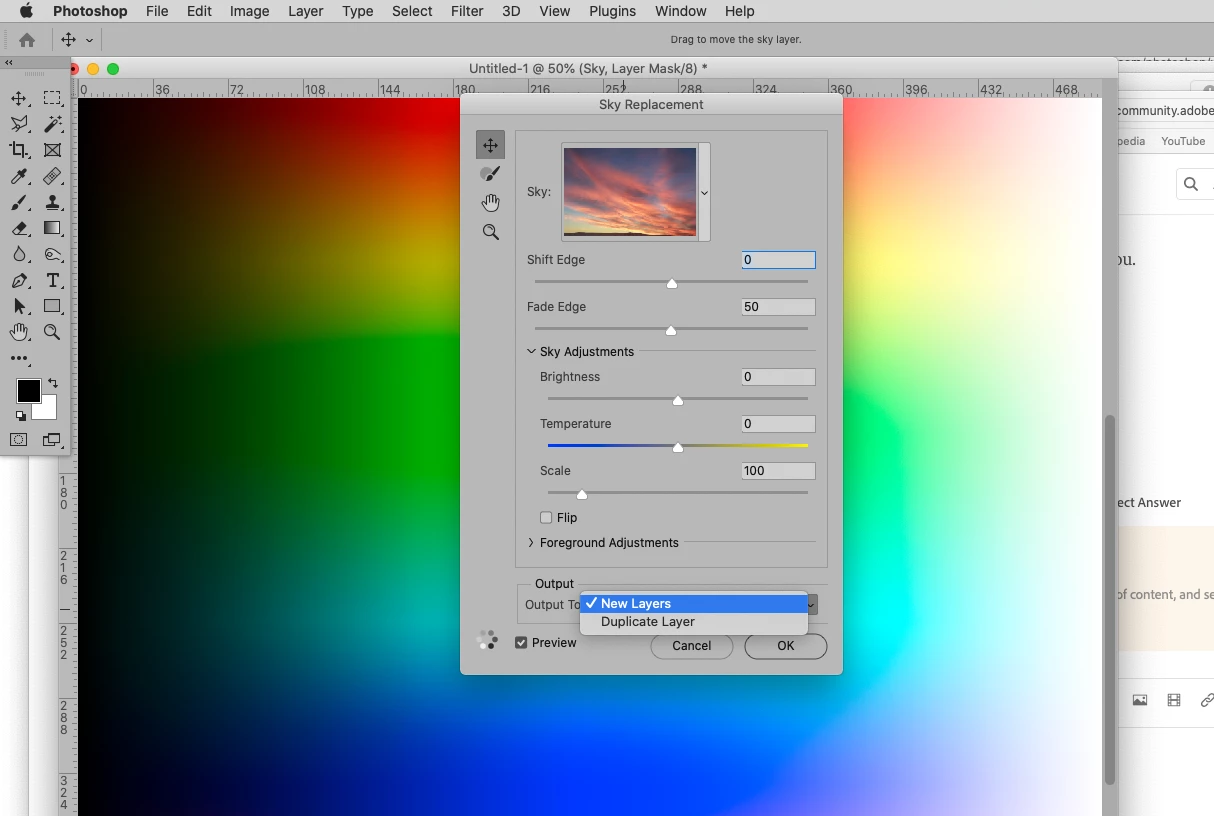

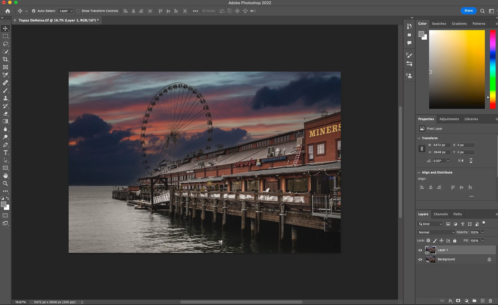

Could you please post screenshots with the pertinent Panels (Toolbar, Layers, Options Bar, …) visible?
If you set Output to »New Layers« you should be able to further edit the Layer Masks.
April 21, 2022
Hopefully this is what you requested. Thank you.
c.pfaffenbichler
April 21, 2022
Try »New Layers« instead and edit the Layer Masks as neccessary.
