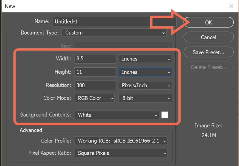

    1. Go to File > New
    2. Document type: Custom
    3. See screenshot  for values and hit OK.

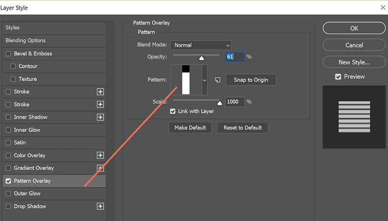

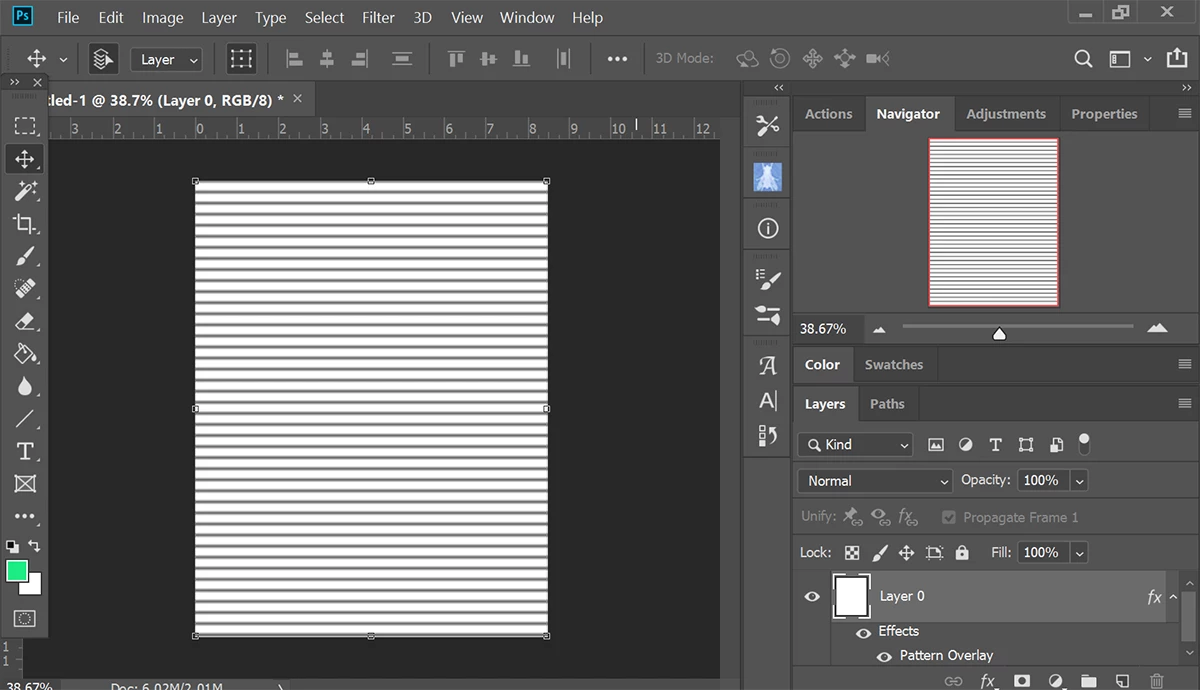

    4. Unlock the background layer by double-clicking & hit OK
    5. Double click on Layer 0 and add a Pattern Overlay.
    6. In this example, I used a horizontal line pattern and adjusted the  scale to fit my page.

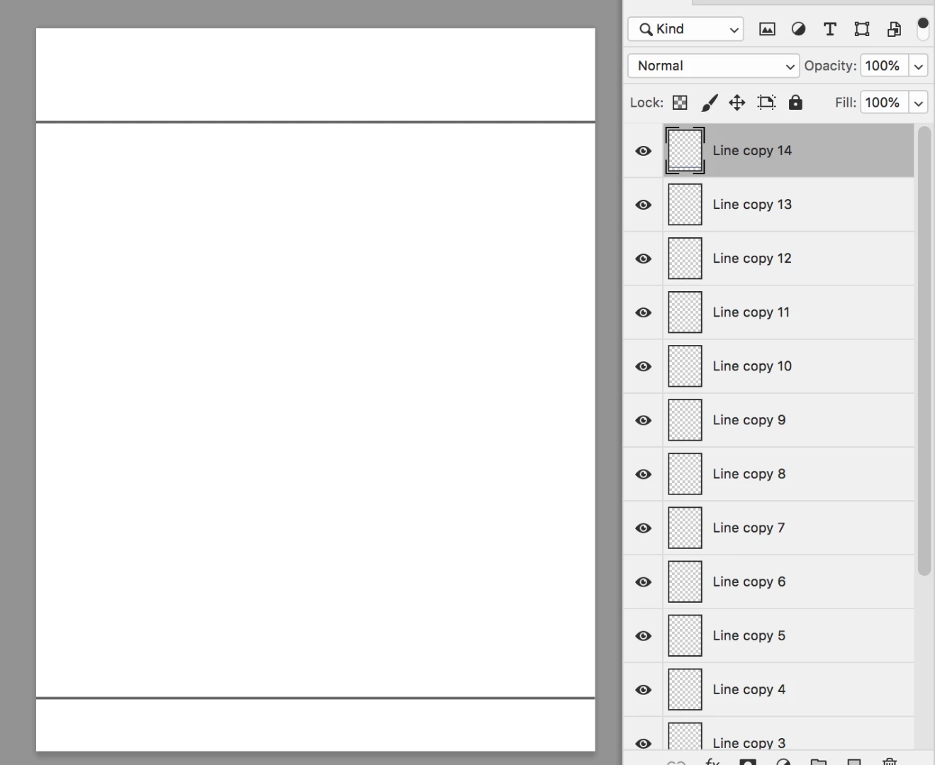

    jane-e
    July 21, 2019
    Hi

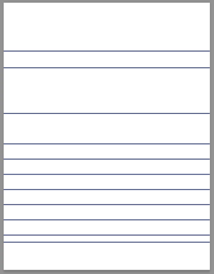

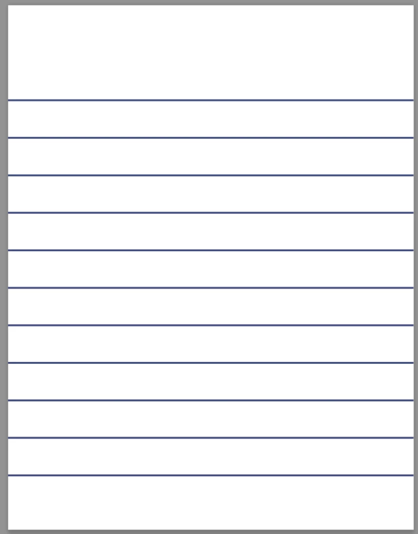

    I would put those lines on separate layers because these projects always need editing.
    1. Draw a line with the line tool and Shift. I set the mode to Pixels, but you could use Shape.
    2. Cmd+J to duplicate the layer for as many lines as you need.
    3. With the Move tool, move one line down to the bottom. Use Shift to constrain.
    4. Multiple select all the layers with lines (use Shift), then click the ellipses in the options bar for the Move tool and Distribute Vertical Centers to space equally between the top and bottom lines.
    5. The reason I like this method is that it's flexible when you need to move the top and bottom lines or add/delete lines.
      Here I've deleted three lines and adjusted the top and bottom lines. All I need to do is select the layers and distribute again.
    ~ Jane

    1. Go to File > New

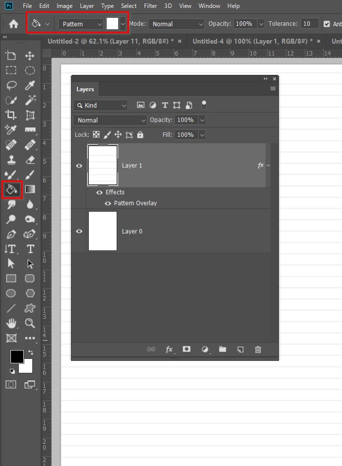

    I like Nancy's solution best. I would not have thought to use the single Dot pattern to make lines, but it obviously works.
    There is not a horizontal line pattern among the default sets, so I quickly made one.  Note, that if you have the background layer turned on when defining the pattern, it will make black lines on white on the same layer.
    Something I have just learned is that if you adjust the pattern scale in Layer Styles, it will retain that scale if you then use the Paint Bucket tool set to Pattern to apply the pattern, but it does so as a Layer Style.  It's not a tool I tend top use, but it's interesting all the same.
