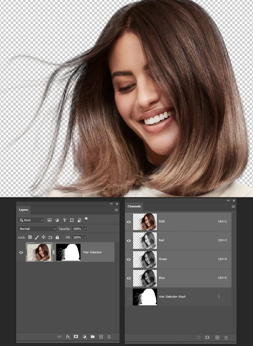

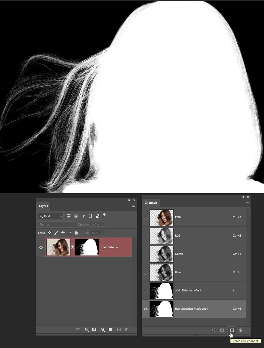

Another way to save selections is in the Channels panel.  If you select a layer that has a Layer Mask, that mask will appear as an additional channel. Indeed, when you use Select > Save Selection that selection is reflected by a new channel in the Channels panel.
When you deselect the layer with the Layer Mask, the new channel will vanish, but if you drag that channel to the New Channel icon at the bottom of the Channels panel, then you'll have essentially saved the selection and Ctrl click on the channel to load it.
