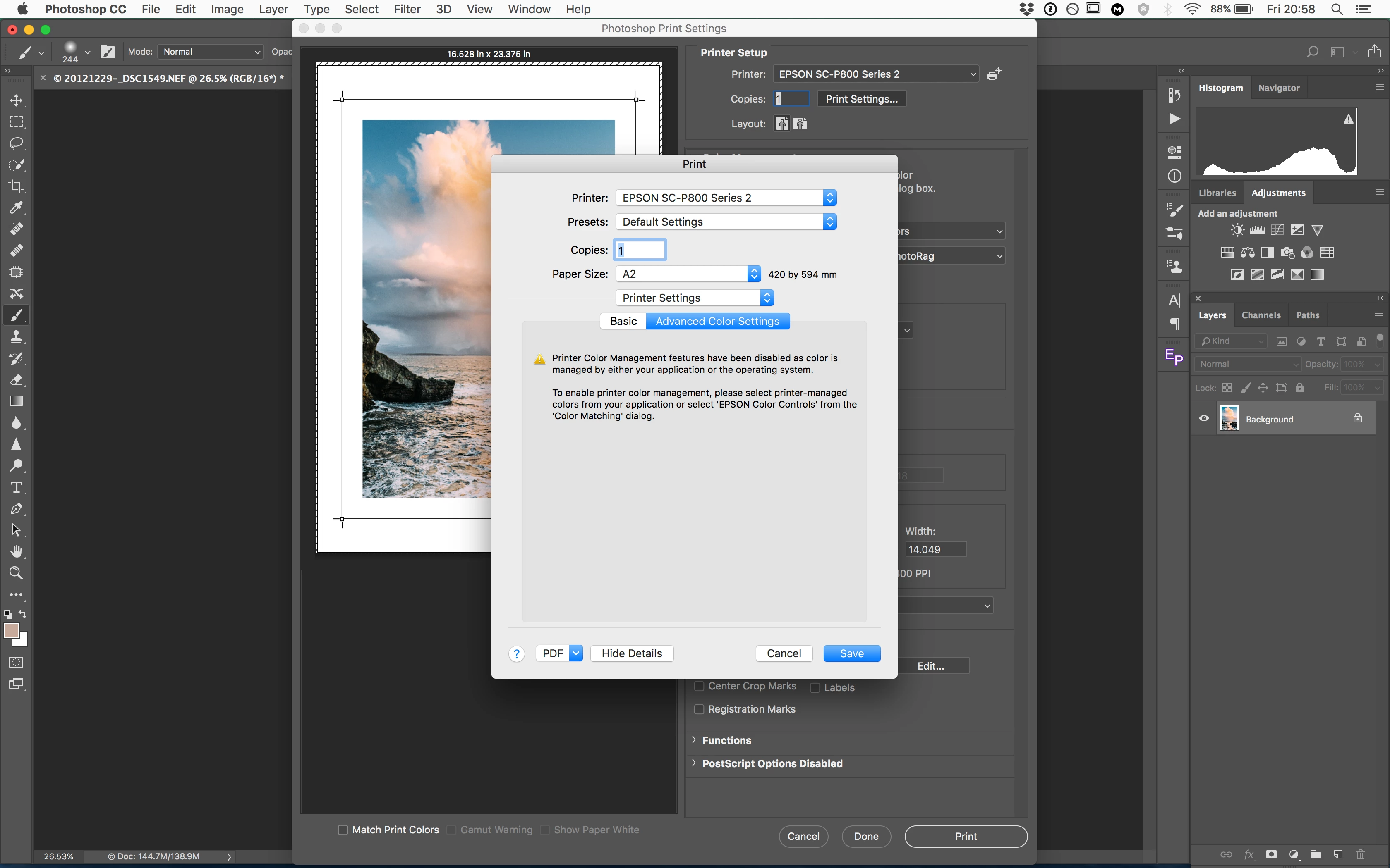

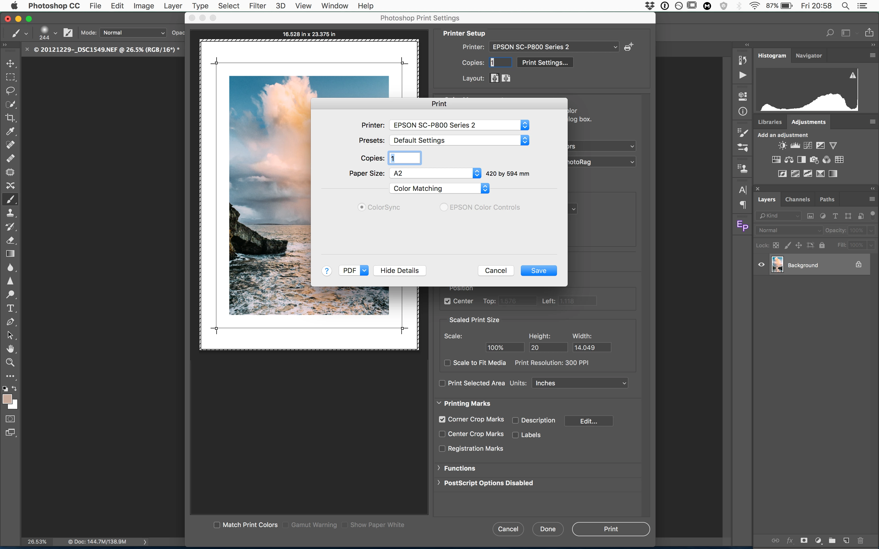

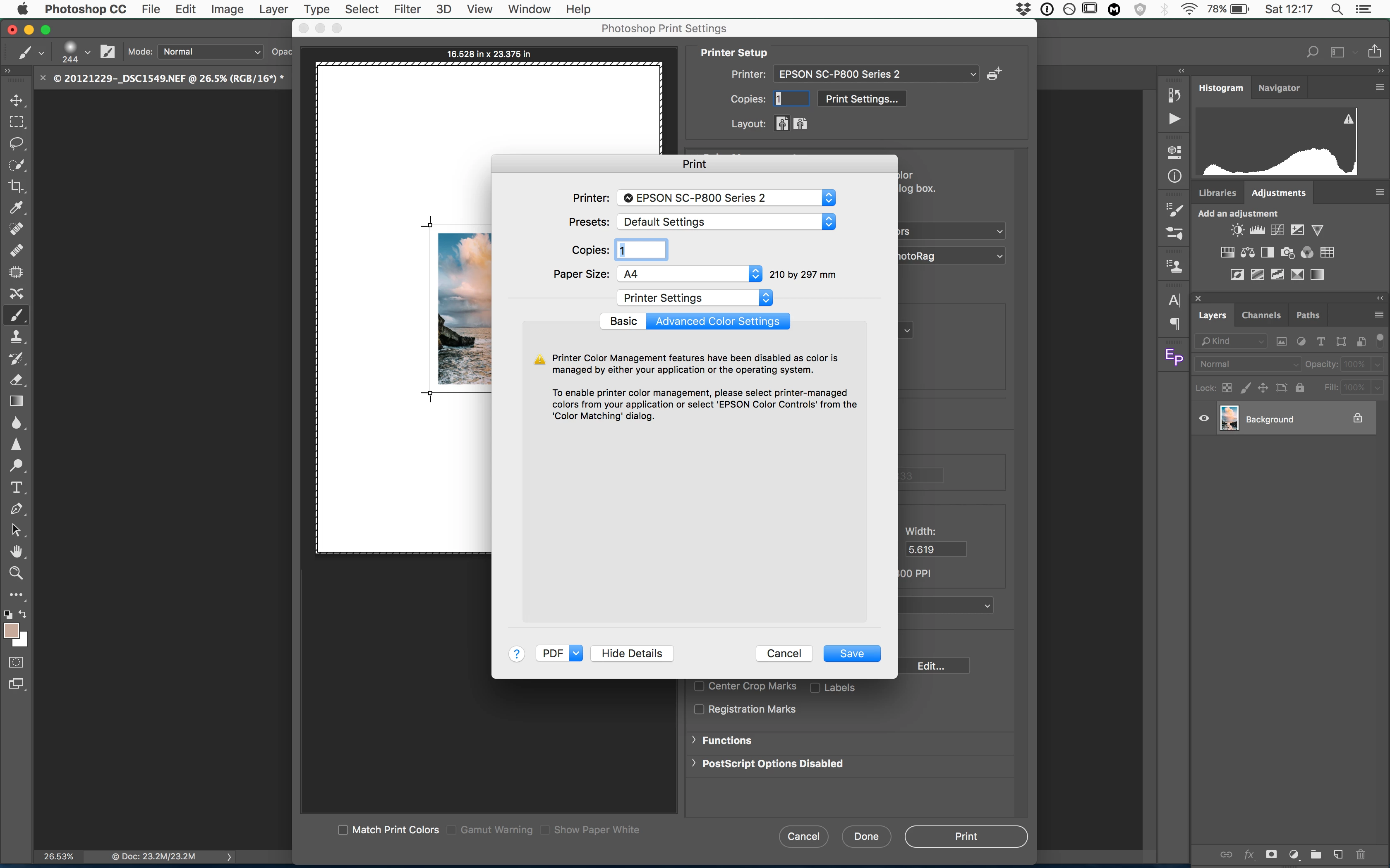

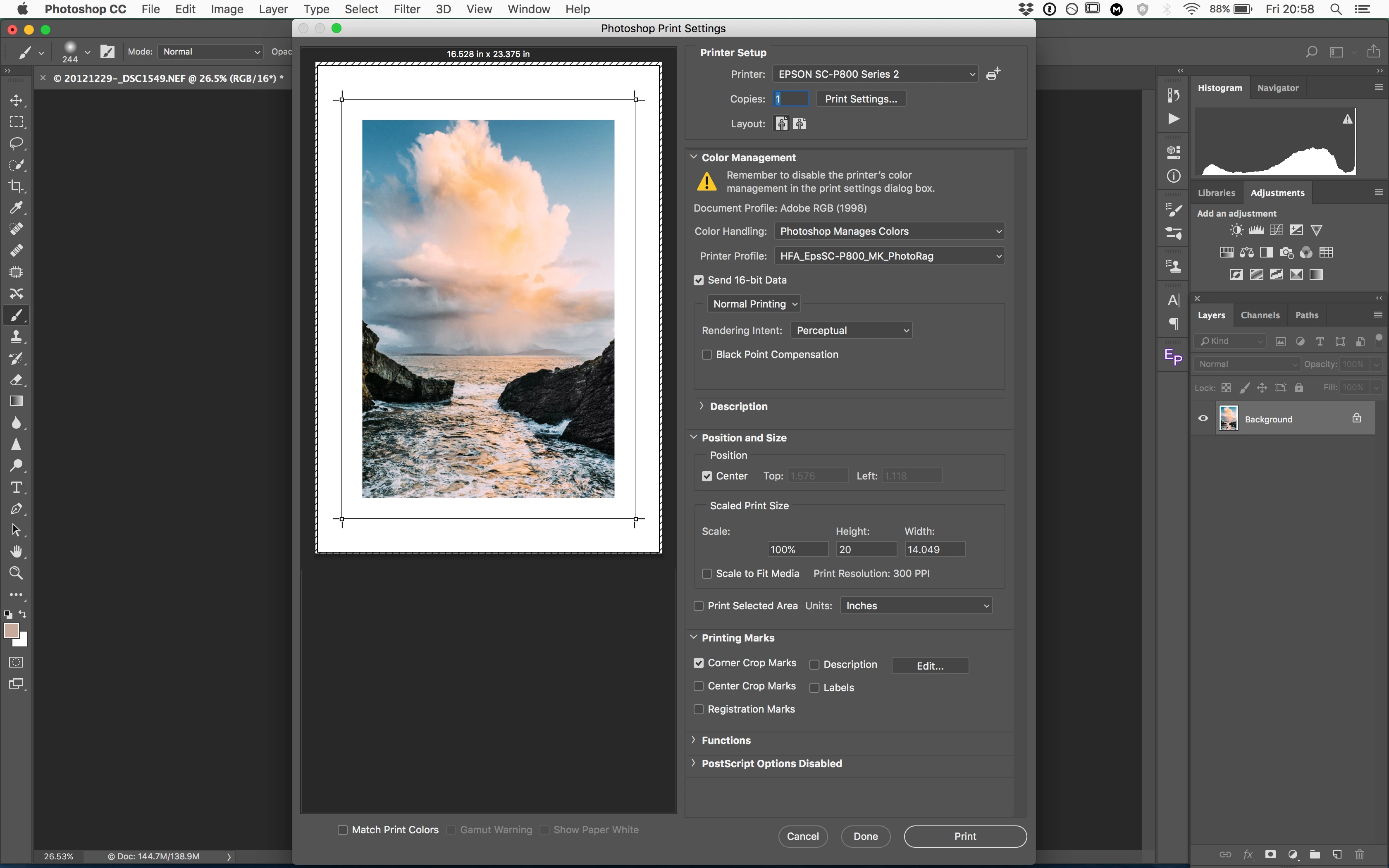

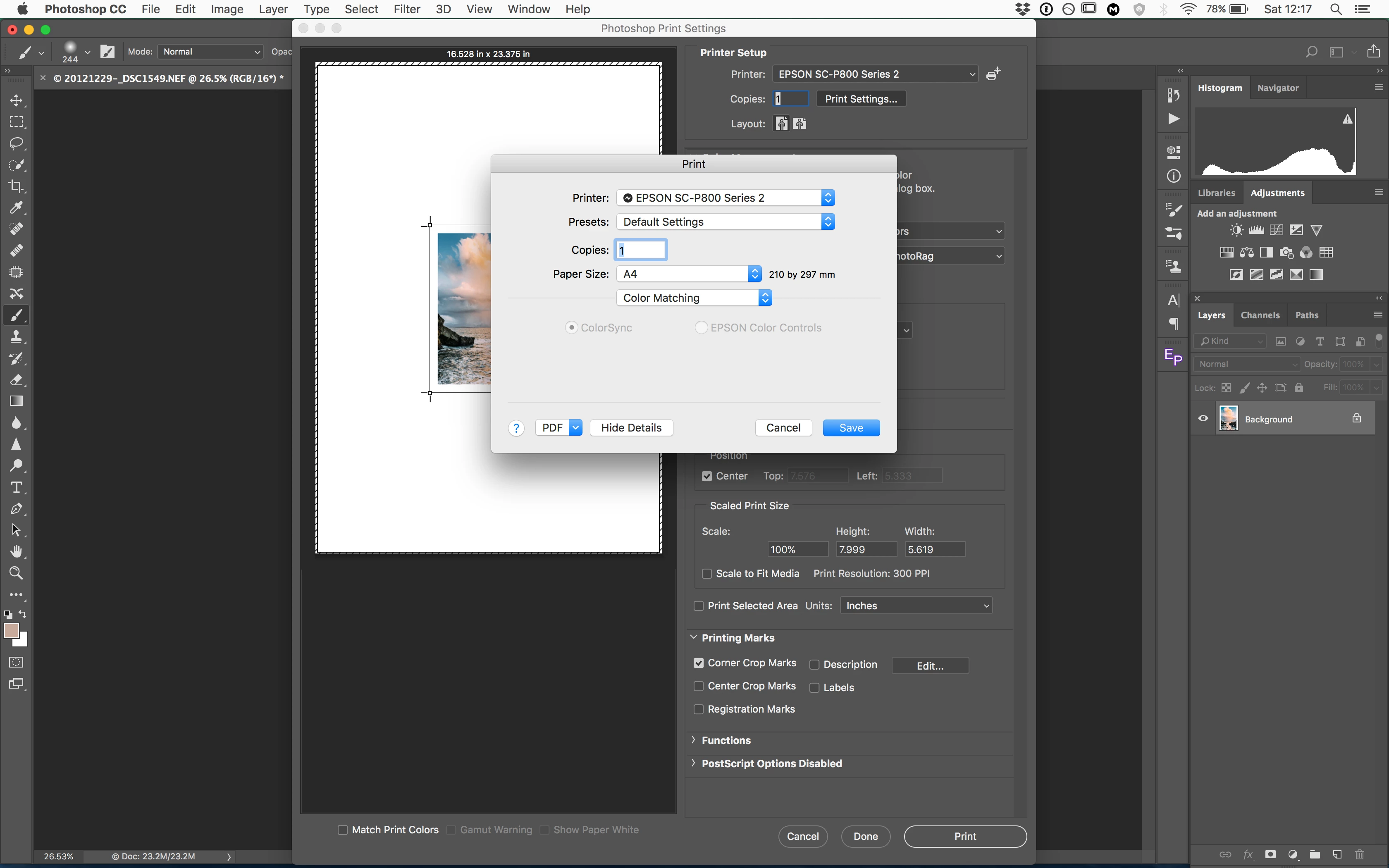

Apologies, I've attached the screen shots settings of the small prints, but as you can see, nothing has changed between the two settings other than size, unless there's somewhere else within the printer dialog where colour management could go askew that I've missed.
I've attached the settings also of the print driver but again, these do not appear to change for either small or large prints.
Thanks for all your help so far.

Again that last screenshot only shows the A4 print - I'll take your work for it that the A2 print settings are the same.
if all settings are the same I can't see why you are seeing a colour difference.
One comment though :
You have high speed and finest detail checked. They are not the best options for photo printing. High speed is bidirectional printing and can lead to banding if each head direction is not perfectly aligned. Finest detail is for sharpening text and graphics. You don't want that "enhancement" on photographic images. So I would (and do here) switch both off.
Dave

I couldn't see if anything changed between sizes as your screenshots were all for the A2 print - nothing for the small print.
One additional thing to check though is the paper type in the print driver. I'm not talking about the profile - which I can see in your screenshot but the actual paper type selection in the Epson print driver.   The paper type selection tells the driver how to lay down the ink and if using non Epson papers there should be a recommendation with your paper of what paper type to select in the driver to go with that print profile.
In setting the print driver to use a large paper size is the paper type also being changed?
Dave
