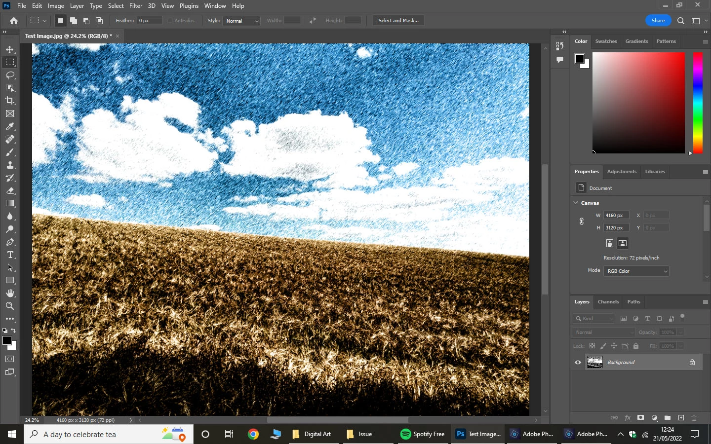

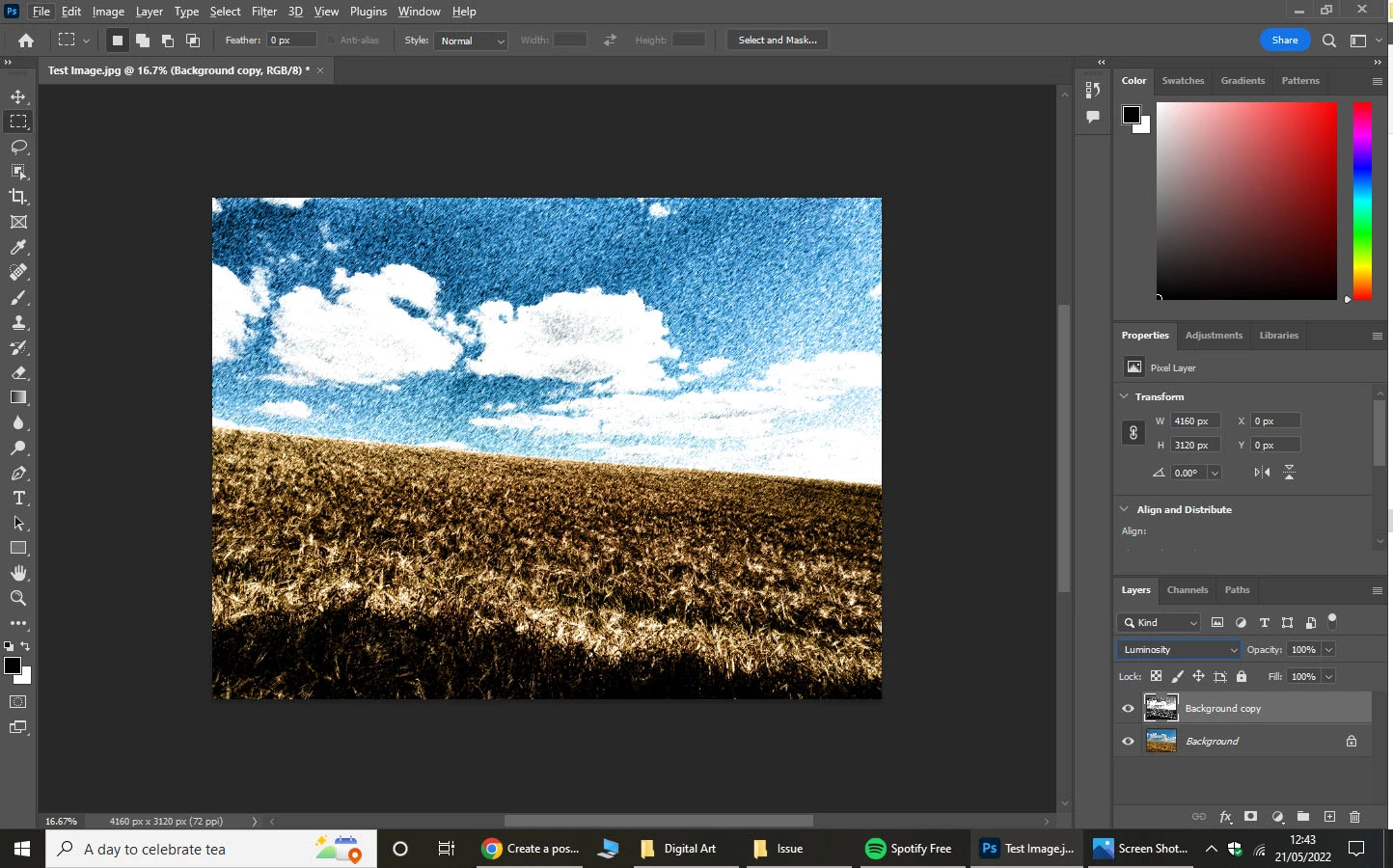

I load the image (Test Image below) and I create a duplicate layer (Background Copy).  I apply the 'Graphic Pen' filter to the new layer and I then set the blend option to luminosity (Screen Shot 1 below).  I now select 'Merge Down' for the Background Copy layer.  The image remains in colour mode but the layer icon is monochrome. (Screen Shot 2 below).  The image will now only save in monochrome.

Could you please post a screenshot taken at View > 100% with the pertinent Panels (Toolbar, Layers, Channels, Options Bar, …) visible?
»The image remains in colour mode but the layer icon is monochrome. (Screen Shot 2 below).  The image will now only save in monochrome.«
How so? It appears to have color on screen, does this disappear after re-opening the image?
The image on screen goes monochrome during the save process (and remains so after the save).   The stored image is monochrome on reopening.
