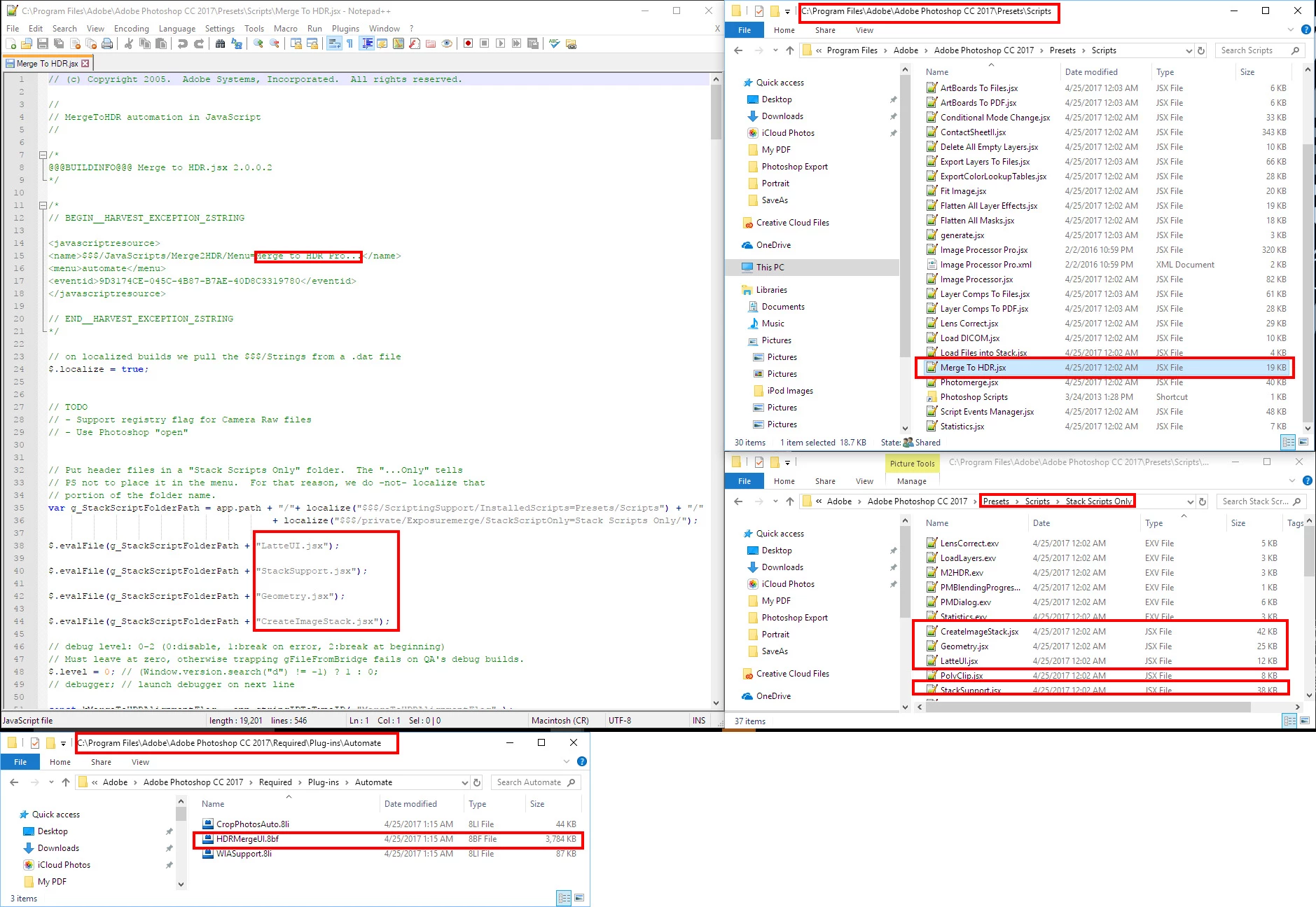

JJMack
October 8, 2017
It look like Merge to HDR Pro is a Photoshop script that uses four other stack mode scripts and a plug-in. I would think then the script would open the images files and stack them as layer in a document.  Not open to a put you into a open file dialog.   So make sure you have the files that make up Merge to HDR Pro on your system in the right places and they have the correct date and size.
JJMack
jlc287
jlc287Author
October 9, 2017
I checked that and they are in the right place and with the right date and time.  The funny thing is that this worked last week then it just stopped.
