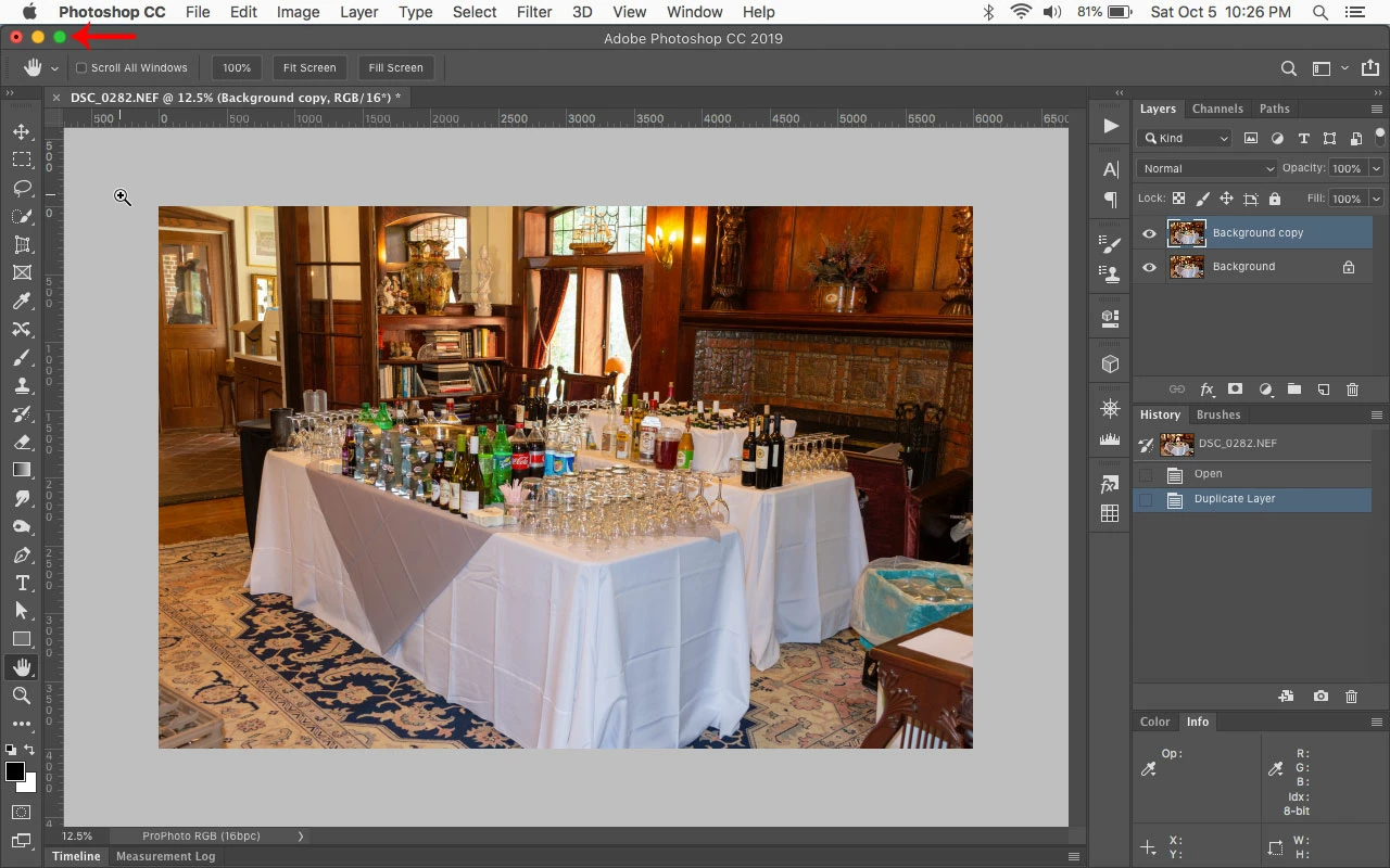

Correct answer Jeff Arola
Click on the Green Maximize button in the upper left to fit photoshop to your screen.
Jeff Arola
October 6, 2019

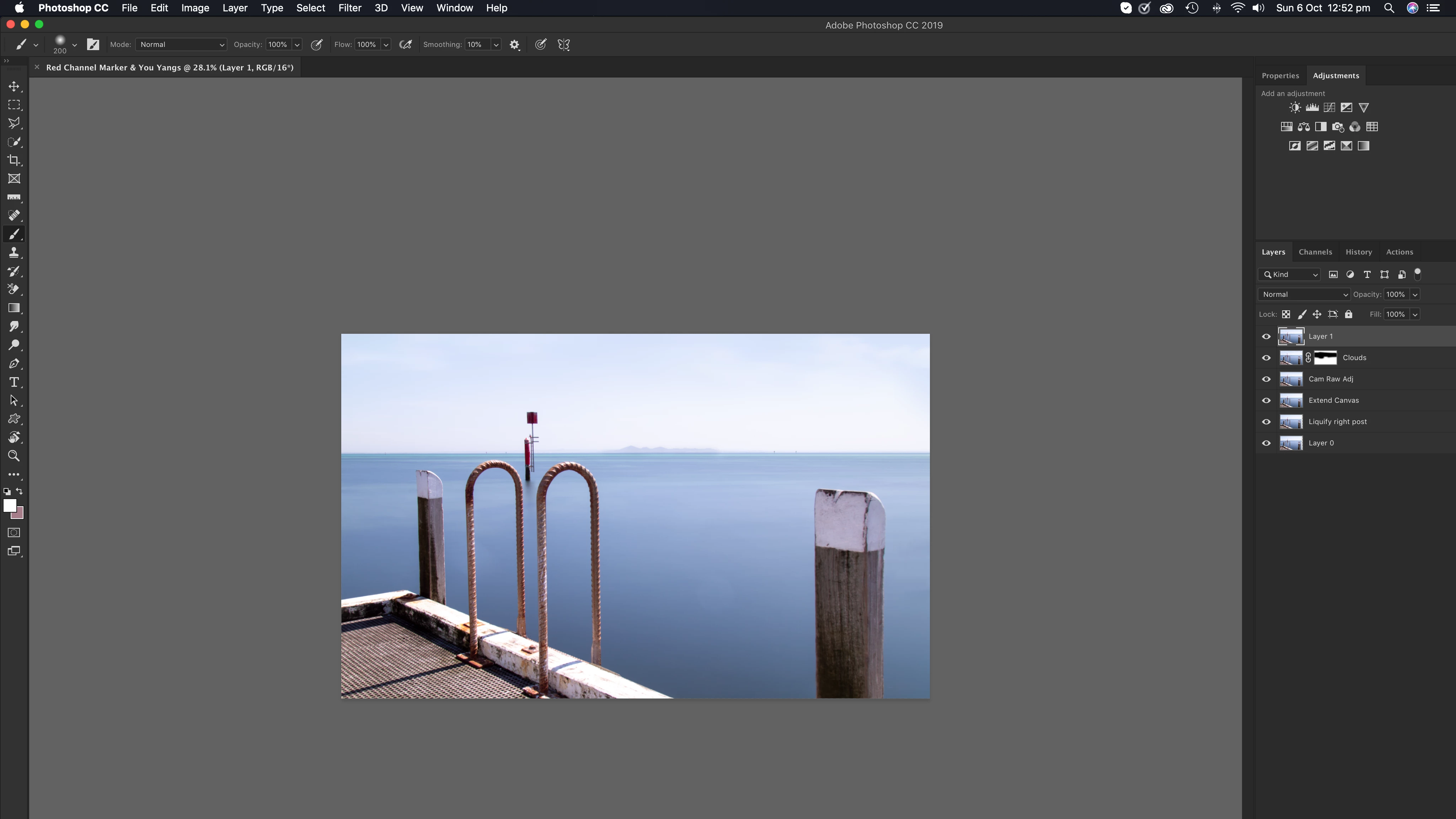

Can you show a screen shot? Often they disappear due to the PS window not being fully displayed, or you have some app that calling your attention that it's open (Win), so it brings up the bottom bar and hides PS's layer panel icons.
carusylAuthor
October 6, 2019
Thanks Chuck, I am on a Mac and as far as I am aware, there is nothing preventing me seeing the bottom of the screen. It is exactly the same as it was yesterday when all was OK. Here is a screen shot anyway. Cheers
