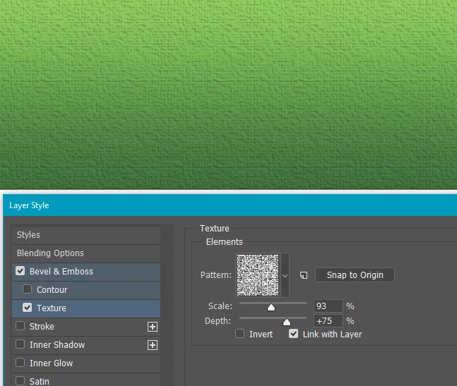

    Hi Merlin
    Layer Style > Bevel & Emboss > Texture does what you describe.  You can adjust the scale and depth and chose from a vast array of different textures.  It is also non destructive.  The down side is that you can't transform the texture for perspective.

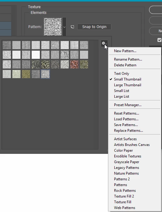

    From the drop down, click on the little cog icon to load additional textures.  These are are all what come as standard.
