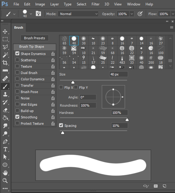

It looks like this currently:

The thumbnail generation is done by creating a document of the appropriate size, creating a curve or curve point, and stroking them.
I'm pretty happy with the result, but I'm not happy with Photoshop displaying the process and would have preferred to just have a loading cursor.

Brushbox seems to load its thumbnails very quickly and I'm assuming it either has direct access to Photoshop's brush thumbnails/sample data, or is reading it from a file using knowledge of the ABR/TPL file formats.
But it doesn't seem to have the ability to display stroke previews on a line which would require active generation.
