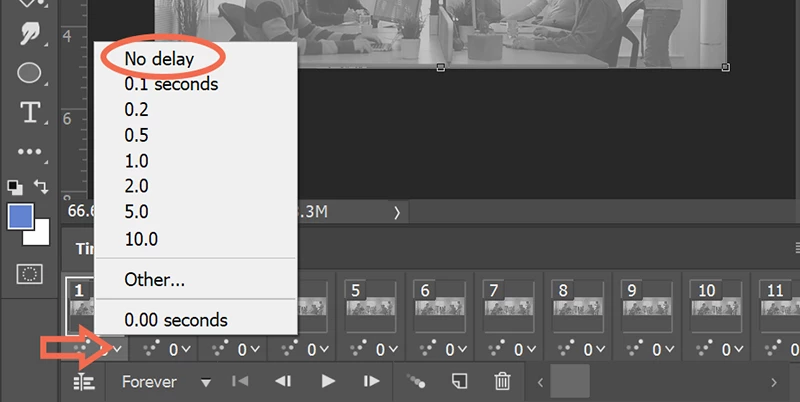

Hi!
I've been making gifs from short videos using Photoshop for a while, I didn't experience any problems until yesterday. Now it takes too long for my gifs to loop again when set at looping forever. I always set frame delay at 0,07. Any ideas how to fix that problem?
Correct answer magdalenaj69220066
Then perhaps something is wrong with the GIF.
How many frames does it contain?
Change the first and last frames to no delay and see what happens.
Problem solved. It turns out the format of my video clips was the problem, after converting them from mov to mp4 gifs run smoothly. Thank you for your assistance and help.
Nancy OShea
July 25, 2020
Probably a memory problem. Restart your computer.
magdalenaj69220066
July 25, 2020
I've already tried and it hasn't worked.
Nancy OShea
July 25, 2020
