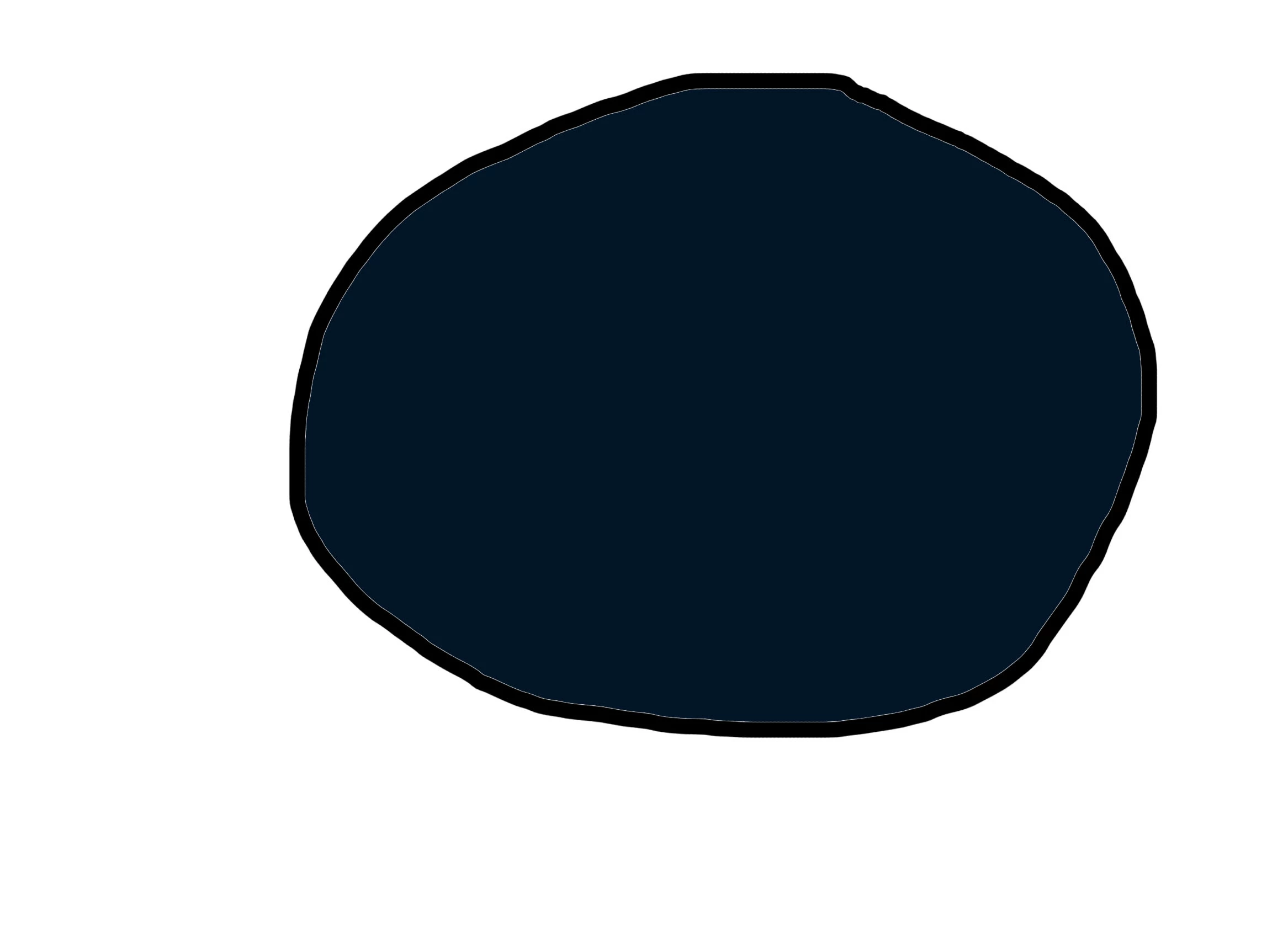

This is something I want to know how to fix. Whenever I use the paint bucket color something that uses a brush for outline, there's always white and gray around the colored spot. The magic wand doesn't fix. I also want to know if there is a way to use the magic want to cut inside and leaving colored pixels inside.

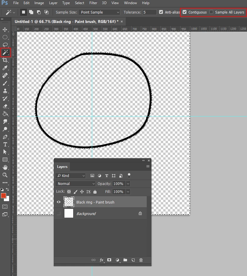

turning on AA minimizes the non-filled line, but does not completely eliminate, so where it is important, you should get into the habit of using layers.  That is, after all, one of the major points of using Photoshop.  I've turned the background layer off for the sake of clarity, but you don't need to.
Use the Magic Wand, and make sure Contiguous is checked, and Sample all layers is un-checked.
Select outside the brushed ring.

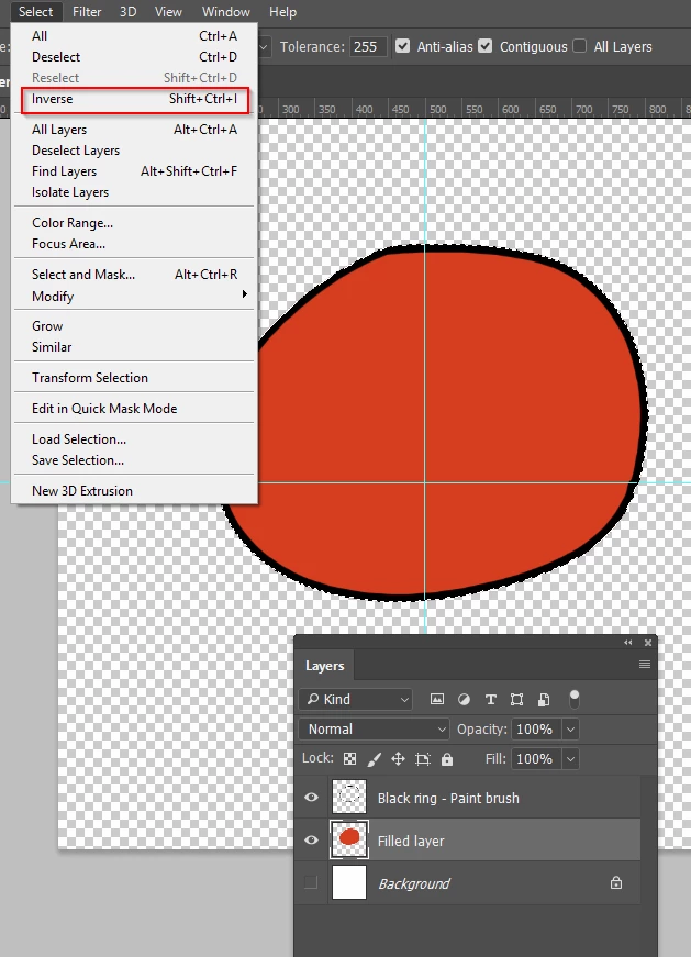

Invert the selection (Shift Ctrl i) and make a new layer beneath the brushed ring, and fill that with the paint bucket, or better still Alt back space

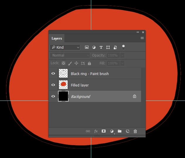

In actual fact, you'd still run into AA artefacts because it would pill outside the black ring (I have turned on the background and made it black to highlight this.
So to avoid that, use Select > Modify > Contract and reduce the selection by a few pixels.

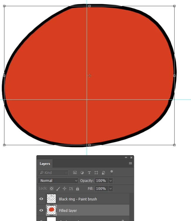

That is a bit long winded, so what we'd be more likely to do, is let it over spill, and use Free Transform to make it a bit smaller
