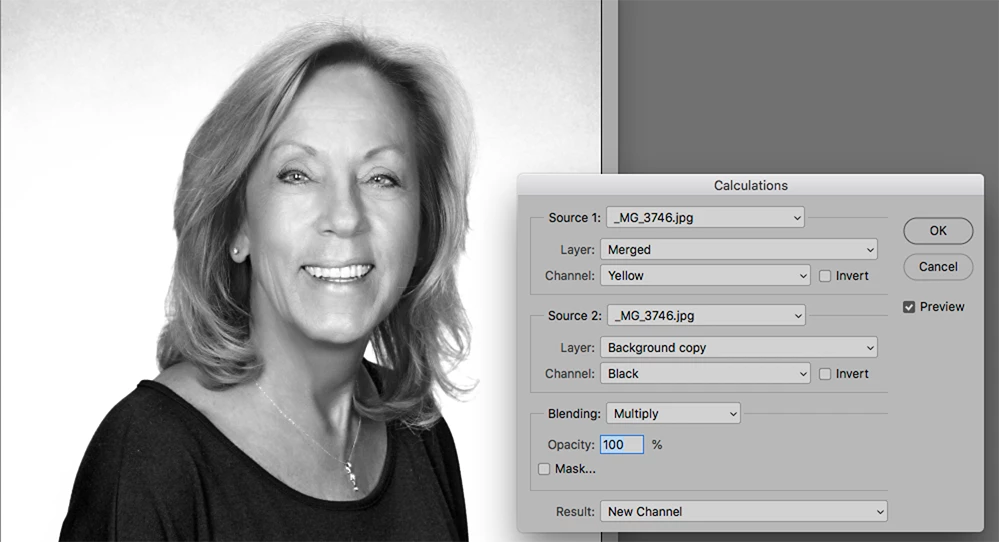

    While making a duplicate image. changing its mode to CMYK and using Calculations with the settings shown here could be the basis for a mask in the RGB version that may rival your current results, I believe that the real elephant in the room is the hair color, made more distracting by the white background. A separate mask of the hair and change in hair color, once you know what it is, is vital. In fact, the same hair correction of your current image may be sufficient.
